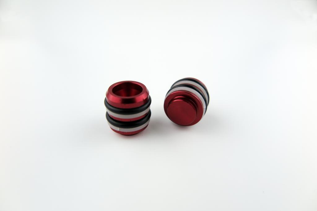

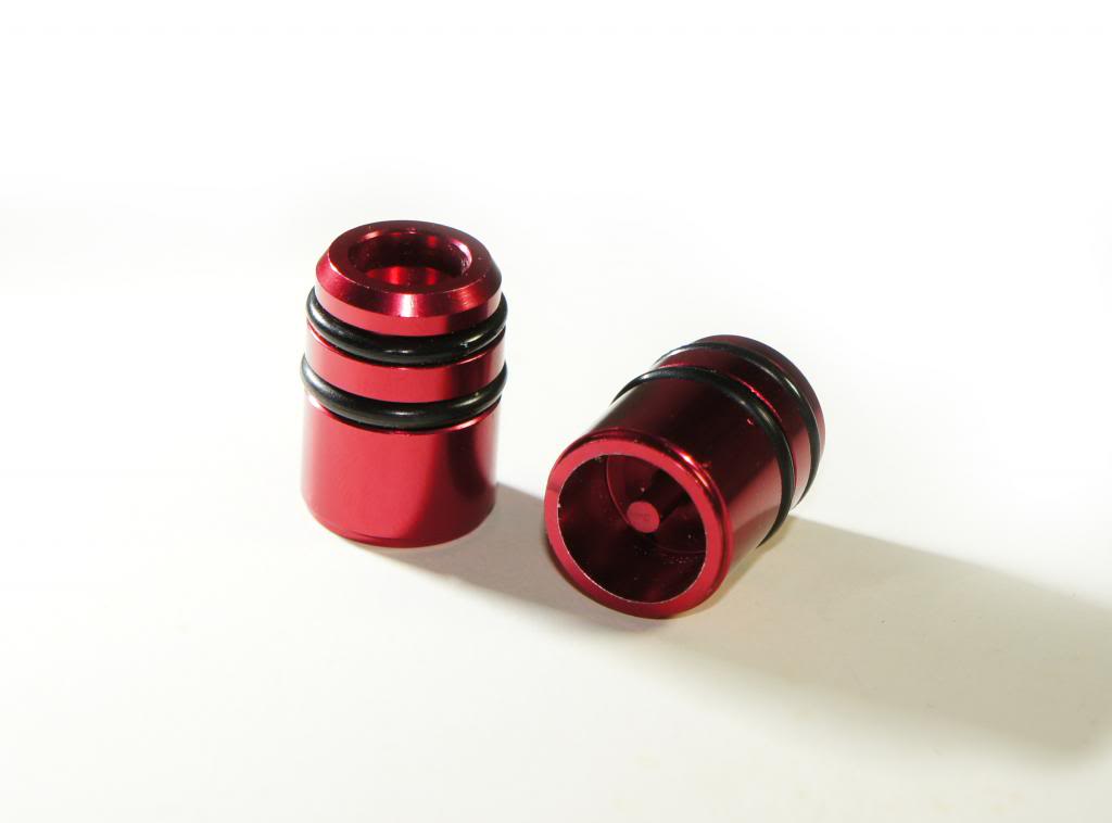

Culshaw95 Posted June 3, 2015 Author Report Share Posted June 3, 2015 (edited) I originally had one of these pistons which was the one which let fluid pass it. I then got sent one of these with grease. First bled with water as I had no idea at the time that it was a water based fluid I was sent. I then cleaned out the system and bled it a few times with Magura Royal Blood which I did use a lot just to ensure the water based fluid and air passed out flushing the system completely but still no success and still feels like when I first got it. Edited June 3, 2015 by Culshaw95 Quote Link to comment Share on other sites More sharing options...
