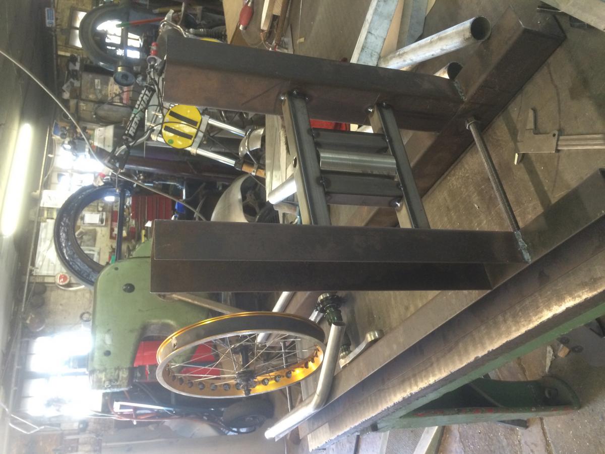

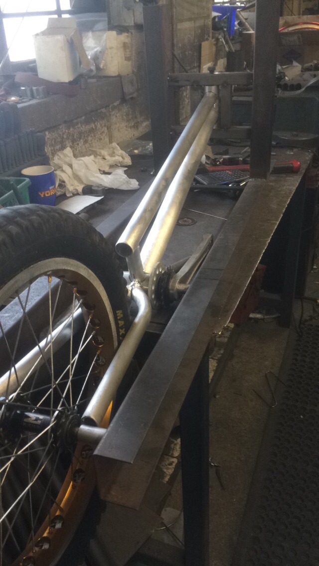

Kenny--Trials Posted June 12, 2015 Author Report Share Posted June 12, 2015 Got the bottom chainstays and most of the jig done today 1 Quote Link to comment Share on other sites More sharing options...

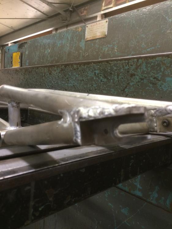

Mark W Posted July 29, 2015 Report Share Posted July 29, 2015 Like this: Quote Link to comment Share on other sites More sharing options...
waybe2014 Posted July 29, 2015 Report Share Posted July 29, 2015 That is what I meant but it only applies for disc mounts Quote Link to comment Share on other sites More sharing options...
Mark W Posted July 29, 2015 Report Share Posted July 29, 2015 You can do it with 4-bolt mounts too, theoretically. I think Try-All (or someone like that) did it at one point. Quote Link to comment Share on other sites More sharing options...
forteh Posted July 29, 2015 Report Share Posted July 29, 2015 Rockman spade and some tryall forks used the bead of weld to help transfer stresses away from the hs33 brake mounts. Quote Link to comment Share on other sites More sharing options...

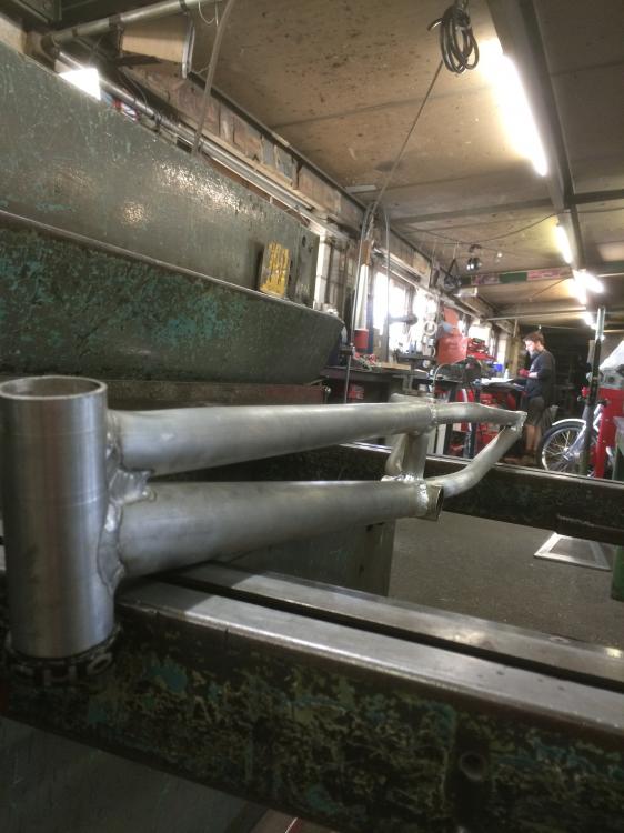

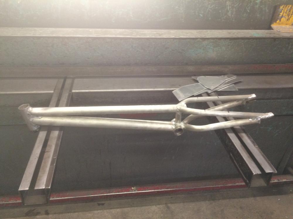

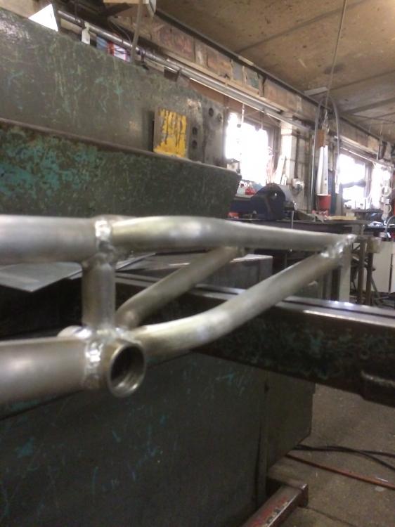

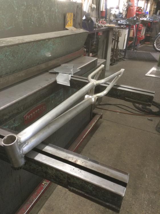

Kenny--Trials Posted October 14, 2015 Author Report Share Posted October 14, 2015 Update: I'm so close to finishing now! It's all welded up, just got to put a few gussets on and make the brake mounts and it's done! 6 Quote Link to comment Share on other sites More sharing options...
