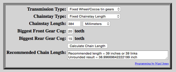

Mikee Posted April 24, 2015 Author Report Share Posted April 24, 2015 (edited) My hex is 22-18 with a kingz in up mode. I realised that I could try this myself and it was way off. A link less and the chain is too short, put the link back in and it is way too slack for a kingz tensioner. Did they change the chainstay lengths on the hex? Mine seems to be 385mm if they did. Also came across this. http://www.machinehead-software.co.uk/bike/chain_length/chainlengthcalc.html Edited April 24, 2015 by Mikee Quote Link to comment Share on other sites More sharing options...
isitafox Posted April 24, 2015 Report Share Posted April 24, 2015 Quote Link to comment Share on other sites More sharing options...
Mikee Posted April 24, 2015 Author Report Share Posted April 24, 2015 (edited) I already have that one saved, but thanks anyway It backs up the 20-15 suggested earlier. The calculator I linked also seems reliable. So I think we should all bookmark it! Edited April 24, 2015 by Mikee Quote Link to comment Share on other sites More sharing options...

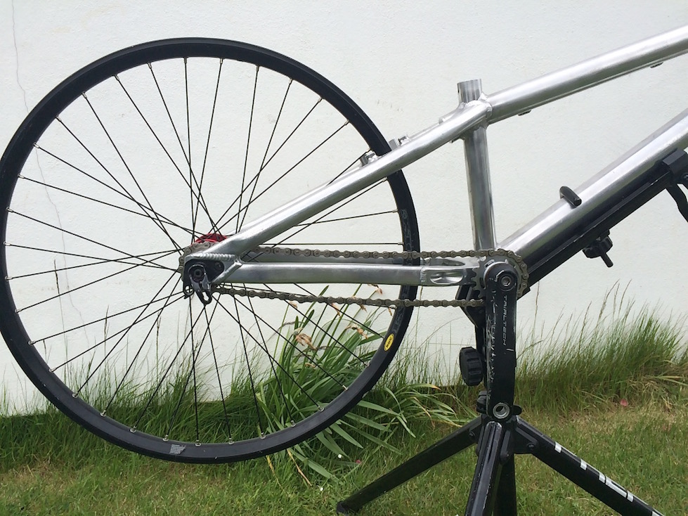

Mikee Posted May 8, 2015 Author Report Share Posted May 8, 2015 For anyone who is interested... This is 17-14 with an old/stretched chain. Tiny bit of filing, some sort of spacers to push the wheel back and it's mission accomplished. 1 Quote Link to comment Share on other sites More sharing options...
