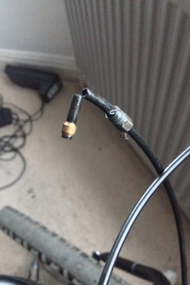

Herbertlemon102 Posted February 12, 2015 Report Share Posted February 12, 2015 Bang! And the brake is gone. Well, kinda. More or less fine from the crash, but I've killed the cable. Luckily, it was right at the end nearest the lever, so trimming it down is not a problem. But my question is: how do you get this olive shaped thing off so I can move it onto the bit the next bit of cable? It was a pretty big cable split and oil went everywhere xD Quote Link to comment Share on other sites More sharing options...
*gentlydoesit Posted February 12, 2015 Report Share Posted February 12, 2015 (edited) Not sure you can (easily). the top and bottom edges are designed to fold inward forming a seal and holding the cable in place Edited February 12, 2015 by *gentlydoesit Quote Link to comment Share on other sites More sharing options...
Herbertlemon102 Posted February 12, 2015 Author Report Share Posted February 12, 2015 Do you think I could bodge my own? All I can see it's doing is stopping the cable from being pulled out of the screw, I could give it a goNot sure you can (easily) the top and bottom edges are designed to fold inward forming a seal and holding the cable in place Quote Link to comment Share on other sites More sharing options...
Matt24. Posted February 12, 2015 Report Share Posted February 12, 2015 You shouldn't reuse them, designed to be replaced http://www.tartybikes.co.uk/rim_brake_spares/magura_hs33_olives_2/c5p28.html Quote Link to comment Share on other sites More sharing options...
*gentlydoesit Posted February 12, 2015 Report Share Posted February 12, 2015 (edited) Do you think I could bodge my own? All I can see it's doing is stopping the cable from being pulled out of the screw, I could give it a go For a quid or so I wouldn't bother.. having said that, the tinkerer in me thinks that if you heated up the cable enough to soften it the olive should easily come off. Then with the olive, using a slightly smaller drill bit than hole, roll it (rolling pin on dough action). It should relieve the collapsed edge, and make it plausibly reusable. DISCLAIMER Thats not advice, just an observation Edited February 12, 2015 by *gentlydoesit 1 Quote Link to comment Share on other sites More sharing options...
bing Posted February 12, 2015 Report Share Posted February 12, 2015 (edited) Stop being a cheapskate and get some new ones. Yes, you heard that right, being told not to be a cheapskate by a tight fisted Yorkshireman Edited February 12, 2015 by bing 1 Quote Link to comment Share on other sites More sharing options...
Herbertlemon102 Posted February 12, 2015 Author Report Share Posted February 12, 2015 (edited) Stop being a cheapskate and get some new ones. Yes, you heard that right, being told not to be a cheapskate by a tight fisted Yorkshireman I've slapped the saint back on, cheapskate or no I can't be arsed not riding while waiting for things, I'd rather tinker. £1 is out of my budget anyway Edited February 12, 2015 by Herbertlemon102 Quote Link to comment Share on other sites More sharing options...
