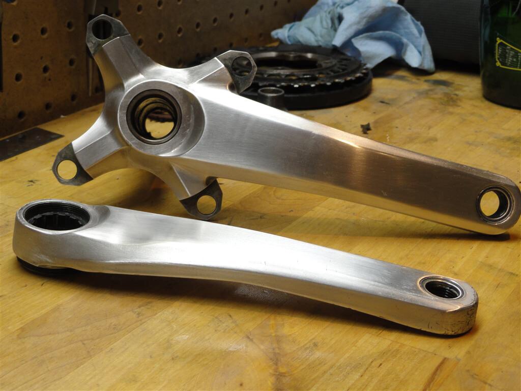

Scott Gibbs Posted December 28, 2014 Report Share Posted December 28, 2014 If the 2 tone colour bothers you you could always take a bit of time and do this! 5 Quote Link to comment Share on other sites More sharing options...
LEON Posted December 28, 2014 Report Share Posted December 28, 2014 True, that looks excellent! Quote Link to comment Share on other sites More sharing options...

JKH Posted January 5, 2015 Report Share Posted January 5, 2015 If the 2 tone colour bothers you you could always take a bit of time and do this!image.jpg I want my cranks to look like that! How did you do that? Quote Link to comment Share on other sites More sharing options...
LEON Posted January 5, 2015 Report Share Posted January 5, 2015 A lot of wire wool, Autosol and worn hands. Quote Link to comment Share on other sites More sharing options...
Scott Gibbs Posted January 5, 2015 Report Share Posted January 5, 2015 Not mine dude, I'm guessing either like LEON said or they've been sand/shot blasted Quote Link to comment Share on other sites More sharing options...
alanczik Posted January 5, 2015 Author Report Share Posted January 5, 2015 If the 2 tone colour bothers you you could always take a bit of time and do this!image.jpg actelly its not the gray part that i didn't like.. its the silver i rather paint it black (but will it hold the trial abuse?) any thing better then a spray can? Quote Link to comment Share on other sites More sharing options...
Scott Gibbs Posted January 5, 2015 Report Share Posted January 5, 2015 Powdercoat? Quote Link to comment Share on other sites More sharing options...
