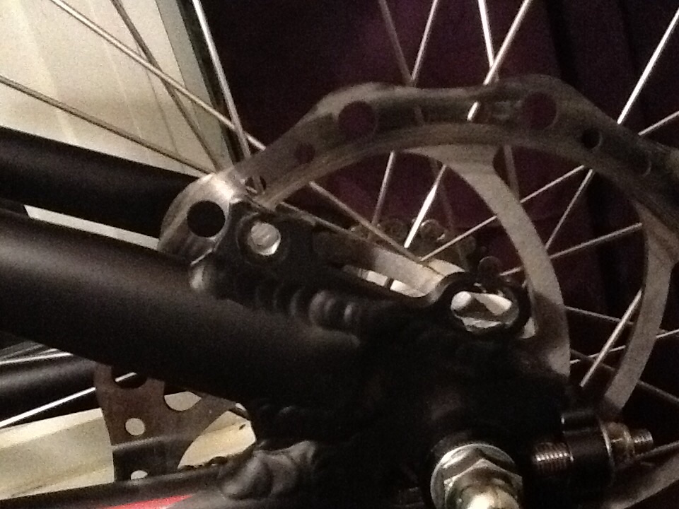

Aldred_85 Posted December 24, 2014 Report Share Posted December 24, 2014 Morning all, Im currently running a 160mm disc on my zoot, generally the hold is reasonable but not totally confidence inspiring. The rear disc mount was snapped when i bought the frame, i redrilled a hole in the meat left over. Are the disc mounts on these frames strong enough for 180 disc, or would i be pushing my luck? Would i be better off utilising the 4 bolt Magura mount? Your opinions, stories, experiences are greatly appreciated. Quote Link to comment Share on other sites More sharing options...
JD™ Posted December 24, 2014 Report Share Posted December 24, 2014 I think your main issue will be alignment, have you tried actually mounting a caliper to that? Quote Link to comment Share on other sites More sharing options...
LEON Posted December 24, 2014 Report Share Posted December 24, 2014 With an IS caliper (Hope) I don't think you'll be able to get around it. Even with a post mount & adaptor your front bolt is about 10mm lower than it should be so that'll need spacing up without spacing the rear. Can't see it working, and even if it did I don't think it'll last long. Deepest sympathies. Quote Link to comment Share on other sites More sharing options...
bing Posted December 24, 2014 Report Share Posted December 24, 2014 Go for rear maggie and a decent set of pads if your mount is goosed. It's not worth the hassle Quote Link to comment Share on other sites More sharing options...
Paperclip Posted December 24, 2014 Report Share Posted December 24, 2014 "The rear disc mount was snapped when i bought the frame" I wouldn't get too into it, they have a tendency to snap, I would stick to 160 for the time being and look to upgrade your frame at some point. Nice work so far though! Quote Link to comment Share on other sites More sharing options...
BJ. Posted December 24, 2014 Report Share Posted December 24, 2014 There's plenty of material still on that mount, you should have no worries running a caliper on there. I'd highly recommend not going any bigger than a 160mm rotar through. Quote Link to comment Share on other sites More sharing options...

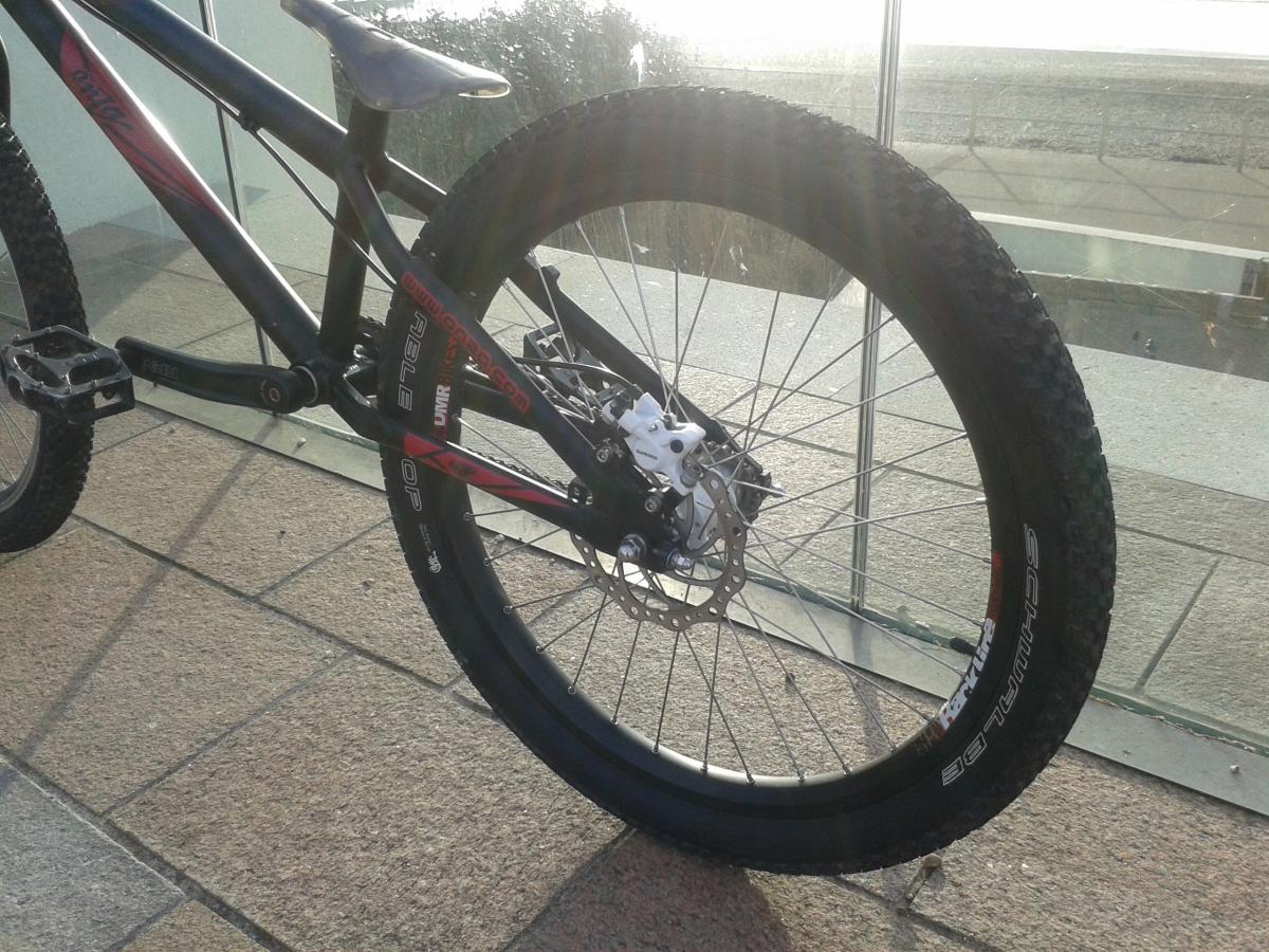

Aldred_85 Posted December 24, 2014 Author Report Share Posted December 24, 2014 Many thanks for all replies. I have been running a 160 disc. Using a front 160 mount, then using v brake convex washers thick ones at top, small at bottom. Worked very well, just struggling with holding power of the 160mm. You may just about be able to spot it on this prior picture. Could i try different pads maybe? Quote Link to comment Share on other sites More sharing options...
Paperclip Posted December 24, 2014 Report Share Posted December 24, 2014 Yeah just from the picture it looks a poor setup. Sintered pads or Organic (personal preference) I would recommend swapping the rotor at the same time just to make doubly sure. Might be worth you checking out something like this... http://www.chainreactioncycles.com/shimano-slx-m675-disc-brake-rotor/rp-prod124961 Much nicer brake get some sintered or organic pads and a fresh rotor will be the world of difference. I would stick to 160 on that mount, but just let it sink in that a better brake set up could finish off the job and rip the mount off again so I'd keep a close eye on it during rides (If that is the frame I think it is I was riding with Jack when he ripped that mount off and we was in the worlds worst skate part (not even riding trials). Quote Link to comment Share on other sites More sharing options...
Aldred_85 Posted December 24, 2014 Author Report Share Posted December 24, 2014 Yeah just from the picture it looks a poor setup. Sintered pads or Organic (personal preference) I would recommend swapping the rotor at the same time just to make doubly sure. Might be worth you checking out something like this... http://www.chainreactioncycles.com/shimano-slx-m675-disc-brake-rotor/rp-prod124961 Much nicer brake get some sintered or organic pads and a fresh rotor will be the world of difference. I would stick to 160 on that mount, but just let it sink in that a better brake set up could finish off the job and rip the mount off again so I'd keep a close eye on it during rides (If that is the frame I think it is I was riding with Jack when he ripped that mount off and we was in the worlds worst skate part (not even riding trials). When you say poor setup, do you mean poor quality components or actual setup of the components? Would Jack be Jack Meeks? That name does sound familiar when i heard of the frames previous owners. Quote Link to comment Share on other sites More sharing options...
