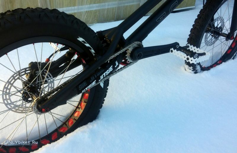

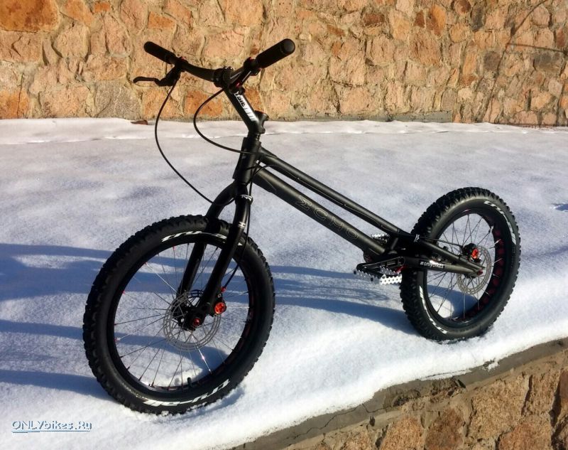

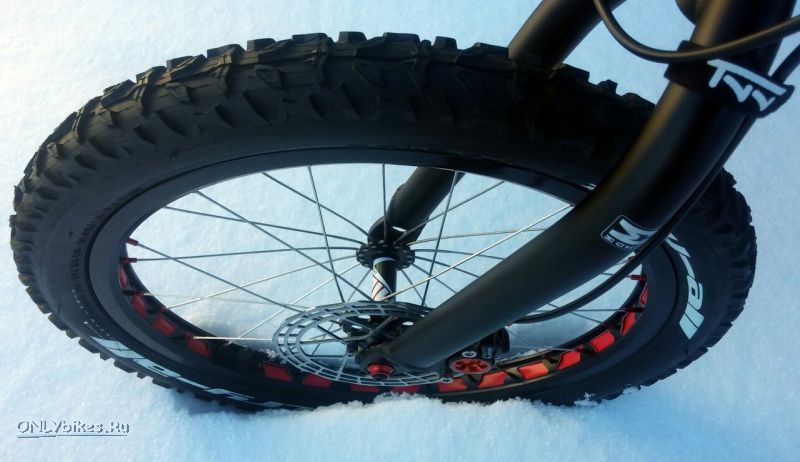

ONLY Posted December 17, 2014 Report Share Posted December 17, 2014 (edited) Hi! Just built it up few days ago, black/white with some red =) Edited December 17, 2014 by ONLY 4 Quote Link to comment Share on other sites More sharing options...

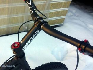

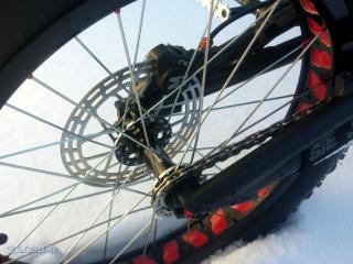

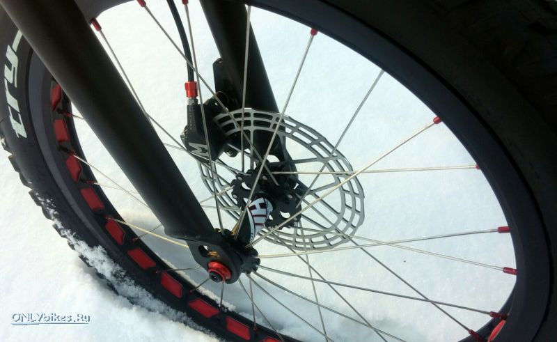

Culshaw95 Posted December 17, 2014 Report Share Posted December 17, 2014 Racing Line hooked up to echo disc calipers seems a bit strange... Quote Link to comment Share on other sites More sharing options...
ZArgrave Posted December 17, 2014 Report Share Posted December 17, 2014 Love it looks great, brake setup is rather interesting be nice to see how well they work Quote Link to comment Share on other sites More sharing options...
bing Posted December 17, 2014 Report Share Posted December 17, 2014 I'd have thought the pressure ratio would have been all wrong, i say this because echo rim and disk brake levers have different lever pivot positions, or pull ratios or some thing like that. I've tried a disk brake lever on a rim brake and it doesn't work. It'll be the same the other way round Quote Link to comment Share on other sites More sharing options...
SamKidney Posted December 19, 2014 Report Share Posted December 19, 2014 Echo disc/rim brakes differ in their piston/cylinder bore size I think. This is still a closed system however so I'm interested to see how effective it is, if at all Magura MT4 levers on Echo callipers with Hope Pads and discs would make a half decent brake for not much money Quote Link to comment Share on other sites More sharing options...
