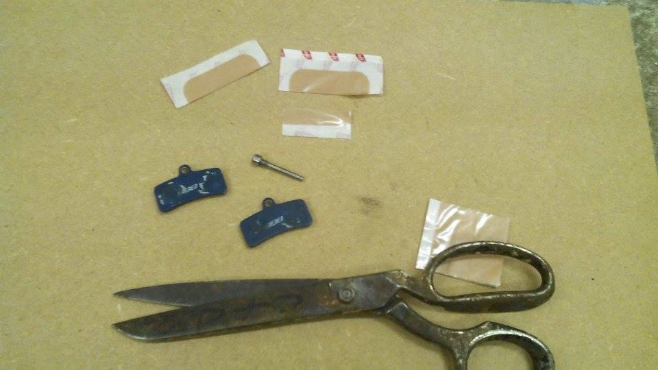

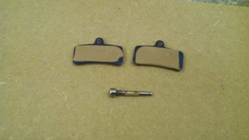

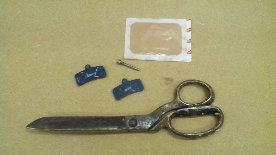

Paperclip Posted December 9, 2014 Report Share Posted December 9, 2014 So I often get asked which pads I feel are the best or how to remove pad rock. I found that most aftermarket brake pads are in painted backings (usually to mark the material) this tends to make a pretty nasty noise if you do have slight rock. Also you get people recommend that you sand the rear of the backing and for myself that never really helped in some cases it made the noise worse. So your two issues usually would be: The loosely fitting pin sliding into the pads meaning your pads can move around slightly. General pads moving/sliding ever so slight on the the pistons. I found by cutting up a large plaster and sticking it to the rear of the two pads you avoid the pads moving on the pistons with the added grip and the pistons will dig into this really nicely. I then use an offcut to stick onto the pin, You will find that you can only cover half of the pin for it to still slide into the caliper and pads. Hope this help's some of you! Quote Link to comment Share on other sites More sharing options...
