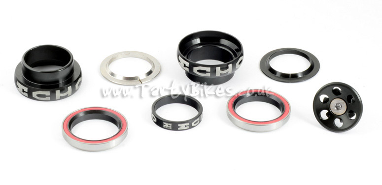

tdubz Posted November 27, 2014 Report Share Posted November 27, 2014 Does anybody have a diagram or pics of the ordering of an echo sl headset Got mine a while back and ive mixed up spacers with some other headsets ( you stupid boy) and the setup i have got does not seem to be right Many thanks Tom Quote Link to comment Share on other sites More sharing options...
Mark W Posted November 27, 2014 Report Share Posted November 27, 2014 They're pretty simple - assuming you've got the right bearings in the cups, you'll just have a single split, colour-matched top bearing race, and a silver split crown race. You can see them both in this photo: Quote Link to comment Share on other sites More sharing options...
bing Posted November 27, 2014 Report Share Posted November 27, 2014 Top and bottom bearings not the same then mark? I can understand the crown and top race not being the same Quote Link to comment Share on other sites More sharing options...
Mark W Posted November 28, 2014 Report Share Posted November 28, 2014 Nah, they are the same, I just meant if he's freestyling a headset out of a bunch of parts that he needed to make sure he had the correct bearings for his Echo headset in there. Quote Link to comment Share on other sites More sharing options...
tdubz Posted November 28, 2014 Author Report Share Posted November 28, 2014 I am running 2014 echo urban forks. Is the bottom split race necessary? Ive read on the tarty description that you dont need one Quote Link to comment Share on other sites More sharing options...
Ross McArthur Posted November 28, 2014 Report Share Posted November 28, 2014 Can't you just look at it and see? If the top of the forks crown is flat, you'll need a race. If it has a slope to it, which lets the bearing sit neatly on, you wont... Quote Link to comment Share on other sites More sharing options...
tdubz Posted November 28, 2014 Author Report Share Posted November 28, 2014 Cheers ross ill have a look Quote Link to comment Share on other sites More sharing options...
