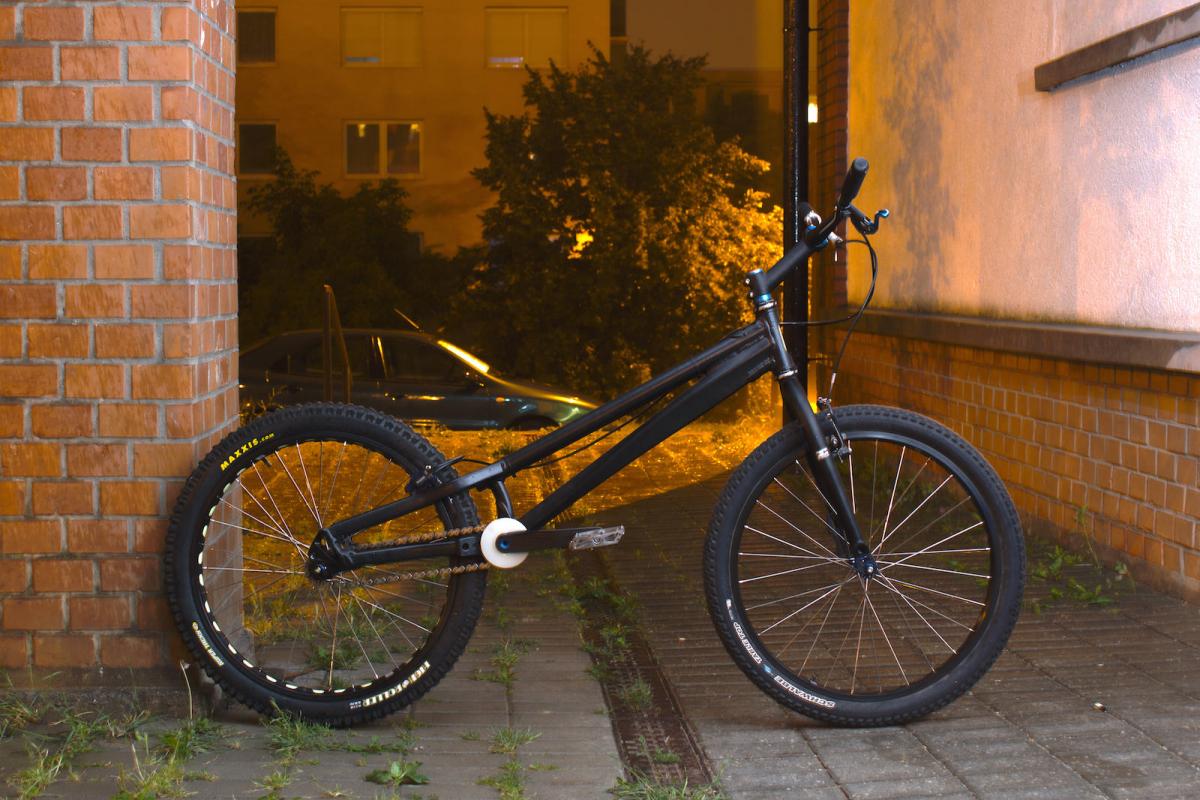

daveZOO Posted November 25, 2014 Report Share Posted November 25, 2014 Hi guys! I just wanted to share my friend, Gergely Harsányi's bike. Here you can watch him riding it. http://www.trials-forum.co.uk/topic/189455-gergely-harsanyi-on-24/ Frame: Modified ZHI Z3 24” Fork: Echo Urban 24” V-Brake & Disc Handlebar: BONZ Pro Light V2 high riser with BONZ foam grips Stem: Crewkerz WAW 145x25 Headset: FSA Orbit MX Front brake: Avid Single Digit 5 with Avid FR-5 lever and Acor Trials V-brake pads Rear brake: Magura HS33 with Echo lever blade and Protrial.hu pads, custom made booster, Echo SL brake clamps Crank: Try-all ISIS 175mm with White Industries ENO Trials 18T and custom made plastic rockring, Wellgo pedals Bottom bracket: old Try-all ISIS Front wheel: BONZ Pro Light front rim with custom made hub, Schwalbe Table Top tyre Rear wheel: BONZ Pro Light rear rim with custom made splined rear hub, BONZ Racing 14T splined CNC sprocket, Maxxis High Roller 2.5 Super Tracky tyre Quote Link to comment Share on other sites More sharing options...

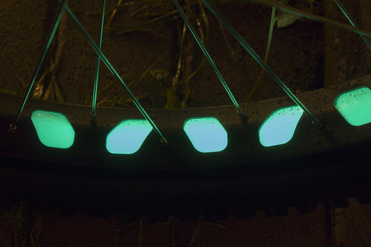

daveZOO Posted November 26, 2014 Author Report Share Posted November 26, 2014 what does "modified" mean,idf you dont mind me asking? looks awesome btw Originally it was a 26" frame. The dropouts were cut down to shorten the chain stays and to lift up the bottom bracket. On the fourth image you can see that the dropout is lower than the chain stay. Now the geo is 1055/360/+55. Quote Link to comment Share on other sites More sharing options...

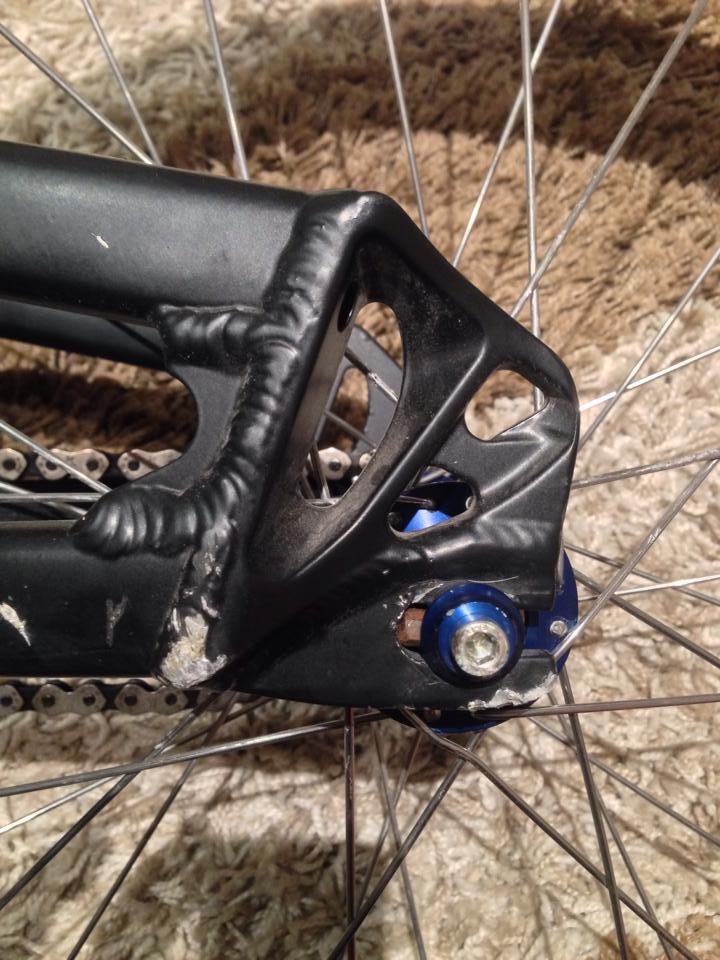

Target Posted November 27, 2014 Report Share Posted November 27, 2014 Very interesting modification! Could you please make a more detailed photo of the dropouts? You had to move the rear hub axle in the dropouts by 25 mm to fit 24" wheel to 26" brake mounts... Quote Link to comment Share on other sites More sharing options...
daveZOO Posted November 27, 2014 Author Report Share Posted November 27, 2014 Very interesting modification! Could you please make a more detailed photo of the dropouts? You had to move the rear hub axle in the dropouts by 25 mm to fit 24" wheel to 26" brake mounts... Here are a few pictures. Quote Link to comment Share on other sites More sharing options...

Target Posted November 28, 2014 Report Share Posted November 28, 2014 Here are a few pictures. So you have welded new lower part of dropout to an old dropout, and repainted the frame? That requires some doing Quote Link to comment Share on other sites More sharing options...
daveZOO Posted November 29, 2014 Author Report Share Posted November 29, 2014 So you have welded new lower part of dropout to an old dropout, and repainted the frame? That requires some doing exactly Quote Link to comment Share on other sites More sharing options...
