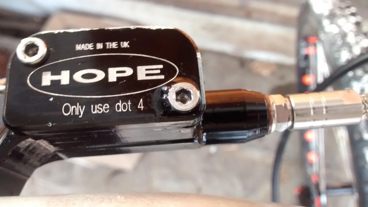

jnthebiker Posted November 20, 2014 Report Share Posted November 20, 2014 Hey all. My front hope mono trial that I just bought used is leaking from one of the screws on the diaphragm cap, after I just bled it. The diaphragm looks okay, I'm wondering did I maybe roll it in the wrong way or something? Thanks, J Quote Link to comment Share on other sites More sharing options...
AdamR28 Posted November 20, 2014 Report Share Posted November 20, 2014 It'll either be... - Bolts are too tight (undo then and just nip them up VERY gently, it doesn't have to seal under pressure, only gravity) - Excess fluid, wipe off and away you go Quote Link to comment Share on other sites More sharing options...
jnthebiker Posted November 20, 2014 Author Report Share Posted November 20, 2014 Thanks! It's not excess fluid, as when I pull the lever, bubbles come out.I'll try the bolts and get back to you. Quote Link to comment Share on other sites More sharing options...
jnthebiker Posted November 20, 2014 Author Report Share Posted November 20, 2014 It'll either be... - Bolts are too tight (undo then and just nip them up VERY gently, it doesn't have to seal under pressure, only gravity) - Excess fluid, wipe off and away you go I just tried the bolts. It's about 80% better, but still a few bubbles. How gently is VERY gently? Quote Link to comment Share on other sites More sharing options...
jnthebiker Posted November 20, 2014 Author Report Share Posted November 20, 2014 It's leaking more again. What should I do? Quote Link to comment Share on other sites More sharing options...

jnthebiker Posted November 22, 2014 Author Report Share Posted November 22, 2014 Diaphragm was a little crooked and the bolts were too tight. Now its mint! Quote Link to comment Share on other sites More sharing options...
jnthebiker Posted January 15, 2015 Author Report Share Posted January 15, 2015 Turns out it's not mint at all... It's leaked ever since a week after that. When I fix one problem, another arises. I'm pretty much ready to be done with this brake, unless it can really be fixed in a way that it will STAY! Does anyone have any ideas for how to deal with it? Quote Link to comment Share on other sites More sharing options...

AdamR28 Posted January 16, 2015 Report Share Posted January 16, 2015 We charge £20.83 per hour (weird price cos it's £25 with VAT) for labour, and do things on a job-by-job basis. We prefer not to do a 'full overhaul' on something if it doesn't need it, but happy to do so if you wish. We prefer to start with a free of charge inspection and quote for the job from there. Is there a leak anywhere? If so, where from exactly and when does it leak exactly? Quote Link to comment Share on other sites More sharing options...
jnthebiker Posted January 16, 2015 Author Report Share Posted January 16, 2015 Ok. I would let you guys judge what it needs if i were to send it. My goal is to have a very good brake, that doesn't feel like a sponge with a lever. It leaks a lot from the diaphragm as in the first picture I posted in this thread. Also, I think it may leak in the master cylinder piston area, as it makes squelching noises when the lever is pulled. The diaphragm leak is when I pull the lever. Thanks Quote Link to comment Share on other sites More sharing options...
AdamR28 Posted January 16, 2015 Report Share Posted January 16, 2015 Ok, all the above points to that it just needs a good bleed and a new diaphragm. The squelching will be fluid that's come out from under the reservoir cap and therefore 'farting' air through part HBSP102: http://www.roteccycles.co.uk/ekmps/shops/rotec/images/hope-mono-mini-master-cylinder-lever-lid-diaphragm-%5B2%5D-2107-p.jpg- it doesn't do this when it's dry. If the reservoir cap bolts have been too tight in the past it can deformed the diaphragm, and will never seal properly again, which is the likely cause of your leak. Quote Link to comment Share on other sites More sharing options...
