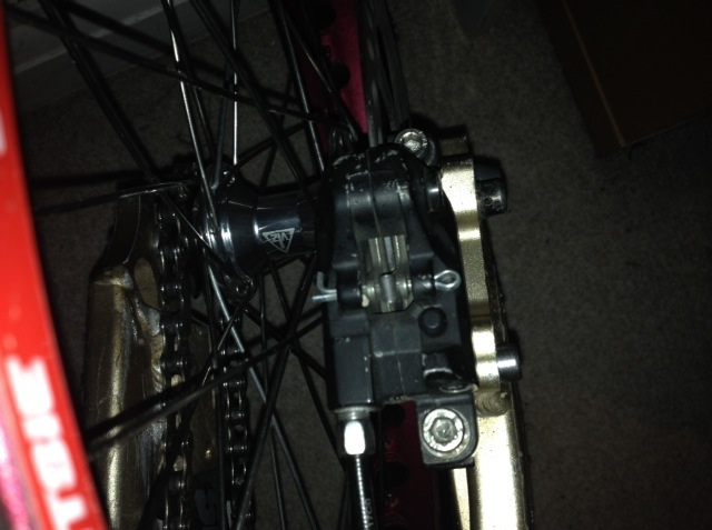

Herbertlemon102 Posted October 11, 2014 Report Share Posted October 11, 2014 In this case, pad rock! There's a fair bit of it going on here. Retaining pin moves laterally too. The noise it makes, the "clunk" I'm sure can be fixed with some copper grease, but I'm thinking something's up with my retaining pin? I'm not used to dual disc so it may be my paranoia but it's always good to know. Usually run magura on the rear Quote Link to comment Share on other sites More sharing options...
isitafox Posted October 11, 2014 Report Share Posted October 11, 2014 What brake is it? Quote Link to comment Share on other sites More sharing options...
FamilyBiker Posted October 11, 2014 Report Share Posted October 11, 2014 shimano deore or slx i'd assume.you'll get pad noise with nearly every shimano brake,its normal Quote Link to comment Share on other sites More sharing options...
isitafox Posted October 11, 2014 Report Share Posted October 11, 2014 Didn't realise bike manufacturers still used split pins for pad retention?! Quote Link to comment Share on other sites More sharing options...
niconj Posted October 11, 2014 Report Share Posted October 11, 2014 (edited) Didn't realise bike manufacturers still used split pins for pad retention?! Up to SLX/ZEE Shimano still does even though you've got the option of buying a retention screw*; the thread is there. As Peter said, pad rock is there and normal. You won't believe how noisy my Zee was. *And, contrary to what is said on this forum, the pad knock doesn't get better with the screw. It's still better upgrading when riding trials as the split pin might fall out. Had this problem so I know what I'm talking about. Edited October 11, 2014 by niconj Quote Link to comment Share on other sites More sharing options...

Herbertlemon102 Posted October 12, 2014 Author Report Share Posted October 12, 2014 What brake is it? shimano Deore, yep.shimano deore or slx i'd assume.you'll get pad noise with nearly every shimano brake,its normal would putting copper grease on the pad backings stop the creaking/clunking noise? I'll just have to get used to the rock I guess Quote Link to comment Share on other sites More sharing options...
niconj Posted October 12, 2014 Report Share Posted October 12, 2014 (edited) I'll just have to get used to the rock I guess I wouldn't put any grease near my brakes. The pad rock (noise) gets less but never ceases completely. Edited October 12, 2014 by niconj Quote Link to comment Share on other sites More sharing options...
Herbertlemon102 Posted October 12, 2014 Author Report Share Posted October 12, 2014 Copper grease on the pad backings, it's usually the standard thing to do? If you manage to get copper grease on the pads when you're putting it on the backings, there's something wrong there I wouldn't put any grease near my brakes. The pad rock (noise) gets less but never ceases completely. Quote Link to comment Share on other sites More sharing options...

Herbertlemon102 Posted October 13, 2014 Author Report Share Posted October 13, 2014 Quick return to the thread, pogo fixed it by putting 3 layers of insulation tape on my pad backings, so the pistons would cut groves for themselves to sit in the tape, and therefore they no longer rock. Hooray! Now, who were we insulting? Quote Link to comment Share on other sites More sharing options...
