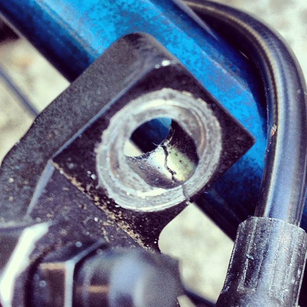

niconj Posted October 7, 2014 Report Share Posted October 7, 2014 (edited) Could someone explain the difference between the xt m775 lever, and the slx m665 lever? There's just one screw (the free stroke adjustment) that the SLX lacks but it's of no use anyways. I have run both combined with a Zee caliper and the feel is almost identical. The bit point and lever travel is in fact identical. It's just that the Saint/XT lever feels more solid. Niconj hasn't been on the forum enough to have seen other riders crack the bolt holes on their m810's when they first came out. Can you show me some? I would really be interested in some pictures as I can't find any on the internet. Quite frankly I don't see why they would've changed the area around the bolts form 810 to 820 so the 810 should be equally weak. Still, I have seen 5 broken 640s/820s and no 810. Edited October 7, 2014 by niconj Quote Link to comment Share on other sites More sharing options...

niconj Posted October 7, 2014 Report Share Posted October 7, 2014 (edited) I don't believe in the Zee=820 thingy What don't you believe? Just have a look at the exploded views over at Paul Lange* and you'll see that the Zee caliper and the Saint caliper are the same. Even the part numbers are the same. It's just a different label (obviously) and the retention pin on a Zee that is a retention screw on the Saint (the Zee even has the thread for the screw). *640 = 820 Edited October 7, 2014 by niconj Quote Link to comment Share on other sites More sharing options...

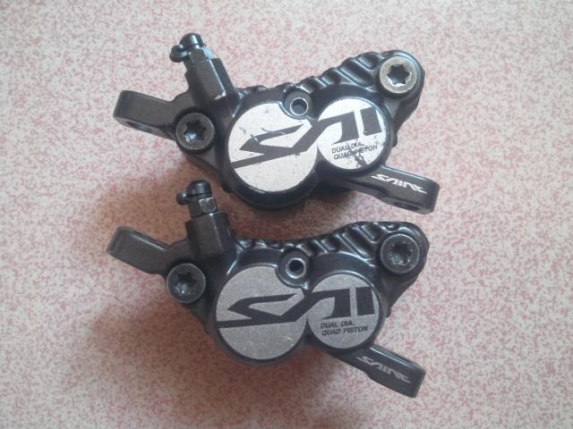

Paperclip Posted October 7, 2014 Report Share Posted October 7, 2014 There's just one screw (the free stroke adjustment) that the SLX lacks but it's of no use anyways. I have run both combined with a Zee caliper and the feel is almost identical. The bit point and lever travel is in fact identical. It's just that the Saint/XT lever feels more solid. Can you show me some? I would really be interested in some pictures as I can't find any on the internet. Quite frankly I don't see why they would've changed the area around the bolts form 810 to 820 so the 810 should be equally weak. Still, I have seen 5 broken 640s/820s and no 810. If you had both calipers side by side you would see quite the difference between them both. The m820 is about 2mm shallower where the bolts slot through also, the m820 has no form of stopping the pads from rocking like the m810 but that's because shimano are going for that whole "Ice tech" stuff and it helps cool the pads down for other disciplines. That being said I would (have) happily ride either caliper as long as I had the m810 lever. The M810 for a lot of people leaked too which is a pretty huge flaw resulting in the change of piston and shape so again without having both side by side it's hard to tell. I will take some picture's of two next to each other and show you how different they are if you are interested? I wondered what a 2 pot caliper on shimano m810 would be like compared to the 4pot saint/zee calipers? would they hold just as well? Quote Link to comment Share on other sites More sharing options...

niconj Posted October 8, 2014 Report Share Posted October 8, 2014 (edited) I wondered what a 2 pot caliper on shimano m810 would be like compared to the 4pot saint/zee calipers? would they hold just as well? Well, theoretically it's 8% weaker. I had a discussion with a guy from Trickstuff and he calculated it. Dunno if 8% is a lot or not. So if the 820 has 2mm less material, doesn't it make it more prone to brake than the 810? p.s.: My 1:1 comparisons are made between the 640 and the 820. They have both the same caliper, just with different labels. p.p.s.: I ran the Zee caliper with 810levers. It's a super powerful brake but as the caliper broke, I kinda lost confidence in it and got a Trialzone instead, which feels equally powerful but, as Ali C. stated correctly, I don't do huge stuff so I shouldn't be in a discussion about brakes' performance. Edited October 8, 2014 by niconj Quote Link to comment Share on other sites More sharing options...
