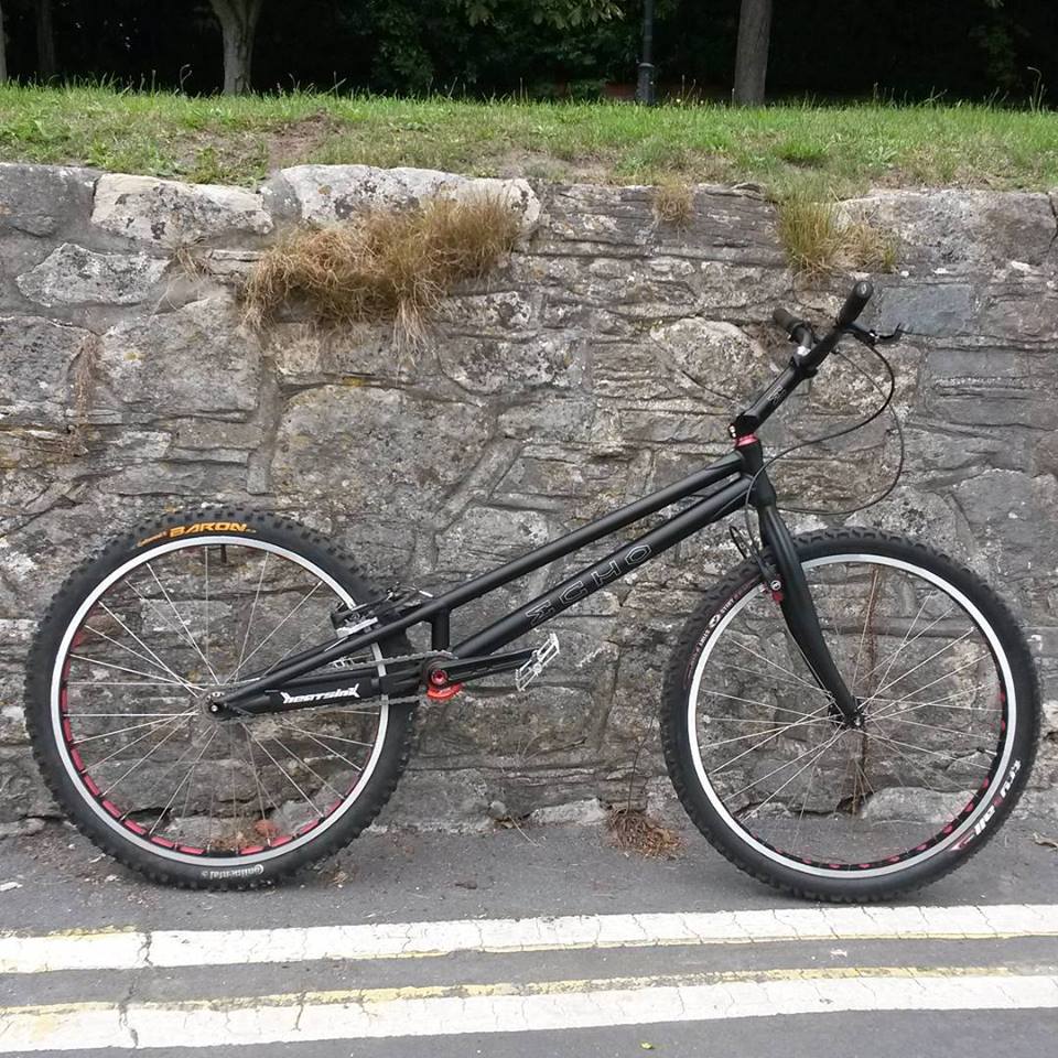

Culshaw95 Posted January 19, 2015 Author Report Share Posted January 19, 2015 (edited) Slight update of the SL. Shalt be spending much more as the set up feels pretty good at the moment and i'm getting a Mod at the end of the month Edited January 19, 2015 by Culshaw95 2 Quote Link to comment Share on other sites More sharing options...

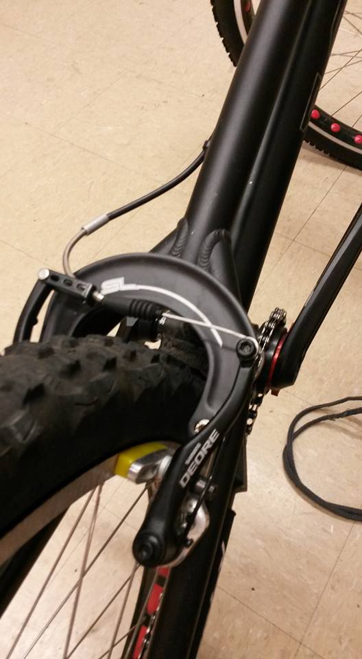

Culshaw95 Posted August 25, 2015 Author Report Share Posted August 25, 2015 Another Update. Converted to rear V brake again Quote Link to comment Share on other sites More sharing options...
niconj Posted August 25, 2015 Report Share Posted August 25, 2015 (edited) Another Update. Converted to rear V brake again Get one of those rare XTR Carbon Boosters (or Salsa for that matter) and your rear brake will performe much better. I ran mine with a TRP Booster in the beginning but putting on the Shimano booster still made a huge difference. Also, the SD7 lever gives you the opportunity to adjust the power of the brake. I dunno how the FRs are but dialing in all the way the little red knob on a SD7 gives you more power (better mechanical advantage/softer bite point). edit: Why not run front Vee as well? Edited August 25, 2015 by niconj Quote Link to comment Share on other sites More sharing options...
Culshaw95 Posted August 25, 2015 Author Report Share Posted August 25, 2015 (edited) Get one of those rare XTR Carbon Boosters (or Salsa for that matter) and your rear brake will performe much better. I ran mine with a TRP Booster in the beginning but putting on the Shimano booster still made a huge difference. Also, the SD7 lever gives you the opportunity to adjust the power of the brake. I dunno how the FRs are but dialing in all the way the little red knob on a SD7 gives you more power (better mechanical advantage/softer bite point). edit: Why not run front Vee as well?Front brake works so i don't see any need to change it, I always had rear brake issues and this brake is the only one that works for me as i use to be dual hydros. I have a Trialtech 2 bolt booster and that seems to make it perform a lot better than my old set up Im not overly bothered with tpa system as i know i dont need to make any adjustments to the brake. I run the same set up on my Breath 20" had no issues (Apart from front disc on the mod) Edited August 25, 2015 by Culshaw95 Quote Link to comment Share on other sites More sharing options...
niconj Posted August 25, 2015 Report Share Posted August 25, 2015 (edited) Front brake works so i don't see any need to change it, I always had rear brake issues and this brake is the only one that works for me as i use to be dual hydros. I have a Trialtech 2 bolt booster and that seems to make it perform a lot better than my old set up Im not overly bothered with tpa system as i know i dont need to make any adjustments to the brake. I run the same set up on my Breath 20" had no issues (Apart from front disc on the mod) How did you get this booster onto your rear brake? When writing "the little red knob" I don't refer to a TPA but the Speed Dial 7 Lever that gives you even more braking power as you can adjust the mechanical advantage. edit: Never mind. Just saw your setup on the 20''. I'll try that on mine as well running dual boosters. Edited August 25, 2015 by niconj Quote Link to comment Share on other sites More sharing options...
Dave Anscombe Posted August 25, 2015 Report Share Posted August 25, 2015 Slight update of the SL. Shalt be spending much more as the set up feels pretty good at the moment and i'm getting a Mod at the end of the month 960216_875064185848058_8866098037832609304_n.jpg Loveeeeeeeee it Quote Link to comment Share on other sites More sharing options...

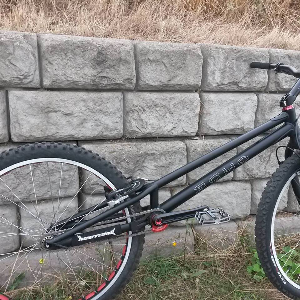

Culshaw95 Posted August 25, 2015 Author Report Share Posted August 25, 2015 (edited) How did you get this booster onto your rear brake? When writing "the little red knob" I don't refer to a TPA but the Speed Dial 7 Lever that gives you even more braking power as you can adjust the mechanical advantage. edit: Never mind. Just saw your setup on the 20''. I'll try that on mine as well running dual boosters. I know what you mean I'm just use to calling it a TPA (spent too long with the hydraulics :L) Slightly better photos of the set up for you: Edited August 25, 2015 by Culshaw95 Quote Link to comment Share on other sites More sharing options...
Culshaw95 Posted August 25, 2015 Author Report Share Posted August 25, 2015 Loveeeeeeeee it Top image is the most recent one of it. I lied to myself saying I wasn't going to get anymore but one thing led to another... Quote Link to comment Share on other sites More sharing options...
