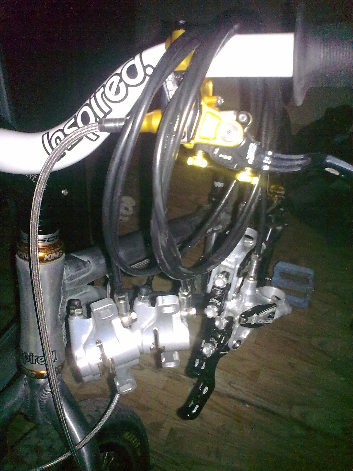

Clerictgm mk2 Posted September 28, 2014 Report Share Posted September 28, 2014 (edited) Now that's a really good bike. Can't imagine how to improve it anymore, so I'll ride it and ride it and ride it. Edited September 28, 2014 by Clerictgm mk2 2 Quote Link to comment Share on other sites More sharing options...

Clerictgm mk2 Posted September 28, 2014 Author Report Share Posted September 28, 2014 saints. Brakes from fishing rods manufacturer? No thanks. I can't imagine what's so good about them? Bite, hold and modulation of M4 are incredibly good, what else do you need? 2 Quote Link to comment Share on other sites More sharing options...

niconj Posted September 28, 2014 Report Share Posted September 28, 2014 (edited) I didn't know that Hope used those Avid type washers with the caliper screws. Pretty certain that they aren't necessary. Edited September 28, 2014 by niconj Quote Link to comment Share on other sites More sharing options...
dann2707 Posted September 28, 2014 Report Share Posted September 28, 2014 Brakes from fishing rods manufacturer? No thanks. I can't imagine what's so good about them? Bite, hold and modulation of M4 are incredibly good, what else do you need? More of those things. Seat should be lower but other than that I actually like it. Quote Link to comment Share on other sites More sharing options...
Filo Posted September 28, 2014 Report Share Posted September 28, 2014 Looks like there used just as a washer with a bigger surface area. Nothing really wrong with using them. I didn't know that Hope used those Avid type washers with the caliper screws. Pretty certain that they aren't necessary. Quote Link to comment Share on other sites More sharing options...
niconj Posted September 28, 2014 Report Share Posted September 28, 2014 Looks like there used just as a washer with a bigger surface area. Nothing really wrong with using them. Not saying that they're wrong, just not needed. Question is whether the bolts are long enough with that many washers but they do look like the ones Avid uses so it should be fine. Quote Link to comment Share on other sites More sharing options...
James281098 Posted September 28, 2014 Report Share Posted September 28, 2014 Saint cranks, hope gold rotors, lower seat and then your onto a winner Quote Link to comment Share on other sites More sharing options...
Filo Posted September 29, 2014 Report Share Posted September 29, 2014 Not saying that they're wrong, just not needed. Question is whether the bolts are long enough with that many washers but they do look like the ones Avid uses so it should be fine. Using the washed means the bolts don't dig into the caliper, the bolts dig into the alloy washes. I'd say it's a better set up then just cranking the bolts again the caliper, who knows it may help stop the caliper snapping like the ZEE tend to do. Quote Link to comment Share on other sites More sharing options...
niconj Posted September 29, 2014 Report Share Posted September 29, 2014 (edited) Using the washed means the bolts don't dig into the caliper, the bolts dig into the alloy washes. I'd say it's a better set up then just cranking the bolts again the caliper, who knows it may help stop the caliper snapping like the ZEE tend to do. Well, Shimano bolts have washers just like the hope bolts, so there's never a bolt directly screwed onto the caliper. I was referring to the correct length of the bolts. If they are too short to be using that many washers, the can crack. Edited September 29, 2014 by niconj Quote Link to comment Share on other sites More sharing options...

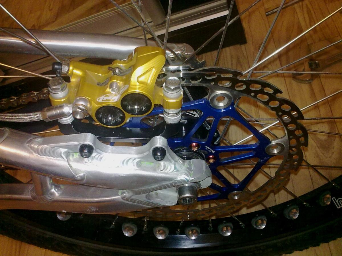

Clerictgm mk2 Posted September 30, 2014 Author Report Share Posted September 30, 2014 Some new parts arrived. Later I'll write a review on different hopes. Colors are not so match but if I'll like 203 rotors I'll get another color. Quote Link to comment Share on other sites More sharing options...

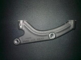

niconj Posted October 1, 2014 Report Share Posted October 1, 2014 (edited) Again. I might be mistaken but you should run another adaptor on the rear brake and get rid of the spacers between the adaptor and the caliper. Oh and I don't think you'll need a 203mm disc. Seeing how my Trialzone with Jitsie pads performs on a 180mm rotor, there's no need for a bigger one on your 4 pot brake. Edited October 1, 2014 by niconj Quote Link to comment Share on other sites More sharing options...
Clerictgm mk2 Posted October 2, 2014 Author Report Share Posted October 2, 2014 For some reason with 203 avid rear adaptor there are only 50% of pad surface touches the rotor. So it's impossible to use or I should file it down for 3+mm. Quote Link to comment Share on other sites More sharing options...
niconj Posted October 2, 2014 Report Share Posted October 2, 2014 (edited) For some reason with 203 avid rear adaptor there are only 50% of pad surface touches the rotor. So it's impossible to use or I should file it down for 3+mm. Get rid of the Avid Adaptor and buy this one instead (the 203mm rear version). The washers shouldn't really be there. Oh and from the pic you posted, there's no way that this is a 203mm adaptor for the rear! Such an Adaptor should be a +40mm one (unless the frame is +20). Edited October 2, 2014 by niconj Quote Link to comment Share on other sites More sharing options...
Clerictgm mk2 Posted October 2, 2014 Author Report Share Posted October 2, 2014 (edited) This adaptor is 203 avid one that doesn't fit. Adaptor with washers are 180mm(+20) one. Yep, I'll buy hope adaptors, they are really cool and light. Edited October 2, 2014 by Clerictgm mk2 Quote Link to comment Share on other sites More sharing options...
Clerictgm mk2 Posted October 2, 2014 Author Report Share Posted October 2, 2014 What about 203 rotors, I like this crazy bite and brutal hold. It's like hs33 without a headache (grinds, leaking, cleaning rims, adjusting pads, etc.) and with modulation. Quote Link to comment Share on other sites More sharing options...
niconj Posted October 2, 2014 Report Share Posted October 2, 2014 This adaptor is 203 avid one that doesn't fit. Adaptor with washers are 180mm(+20) one. Yep, I'll buy hope adaptors, they are really cool and light. Well, it Just doesn't look like a +40 adaptor. Nothing wrong with 203 discs just think that 180 is enough. Enough for me anyways. Quote Link to comment Share on other sites More sharing options...
