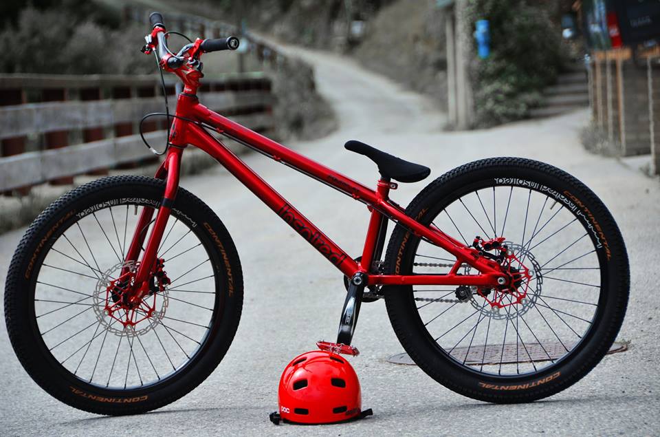

Don't use floating disks for trials. You'll end up with no teeth
Really? Ali riding ones.
And Fabio also riding with SAW floating.
Why they are bad for trials?

Ice techs aren't floating. It's an alloy spider with the disk firmly riveted to it, with no movement. Hope saw 'floating' rotors are motorbike style, with the steel outer attached to the alloy spider with button style rivets, so they float. And move, a lot like pad wobble. Upto you mate, but I wouldn't use hope floating rotors for trials, only hope solid rotors

That's not true, they do the floating rotors in a light XC version and a tougher DH version, the DH one is fine for trials and there is no rotor movement. The XC ones are a bit too spindly for my liking though.

Yep, how can I forgot that icetech are really not floating, just 2-piece.
Only wobble are shitty for trials... well Then I'll try some other 203 if I don't get enough power from echo 180 when they are fully bed in.
