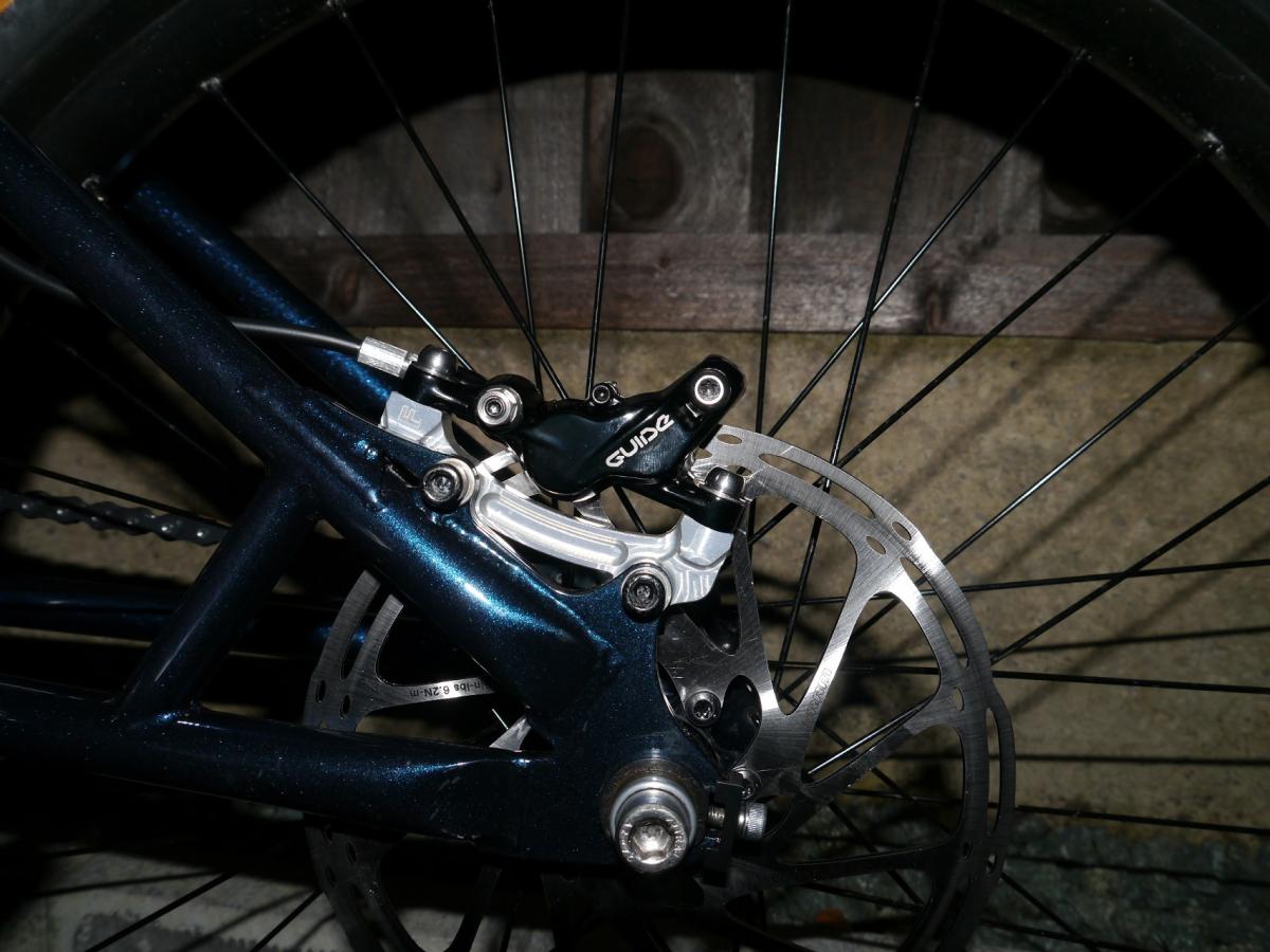

Dman Posted November 19, 2014 Report Share Posted November 19, 2014 Having a bad time with brakes, rode these tonight and they were ok for about half hour, no noise, but gradually the squeal came back really bad, can't figure out what's going on. Quote Link to comment Share on other sites More sharing options...
bing Posted November 19, 2014 Report Share Posted November 19, 2014 You changed rotors or just the brakes? Quote Link to comment Share on other sites More sharing options...
juanfeliz Posted November 19, 2014 Report Share Posted November 19, 2014 Are you using the same rotors? It looks to me like you'd be using a slightly bent rotor. Quote Link to comment Share on other sites More sharing options...
Dman Posted November 19, 2014 Report Share Posted November 19, 2014 Everything full New brake set, looking online it can be a number of things Contamination of pads/rotor Mounts need facing Caliper not aligned correctly One site said a bad bedding in period can cause squeal, if the pad material is Not laid down evenly on the disc. I'm pissed with brakes. I'm looking at different pads all I can find for them are these from uber bike http://www.uberbikecomponents.com/category/331/View-all-Avid-SRAM-Disc-Brake-Pads-here What compound would you recommend from what they offer? Kevlar Sintered Semi metallic Race Matrix Help!!!!!!! Quote Link to comment Share on other sites More sharing options...
Ali C Posted November 19, 2014 Report Share Posted November 19, 2014 definitely sintered Quote Link to comment Share on other sites More sharing options...
JamieWilliams Posted November 19, 2014 Report Share Posted November 19, 2014 I would say give the Sintered a go and maybe With some shimano SLX or hope Mono trial rotors Hope this helps Jamie Quote Link to comment Share on other sites More sharing options...
Dman Posted November 19, 2014 Report Share Posted November 19, 2014 definitely sintered Ordered. I would say give the Sintered a go and maybe With some shimano SLX or hope Mono trial rotors Hope this helps Jamie Surely these brakes should work best with the rotors that came with them. Quote Link to comment Share on other sites More sharing options...
