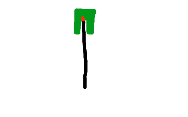

niconj Posted September 20, 2014 Author Report Share Posted September 20, 2014 (edited) file the holes upwards to lift the caliper? Or get a post mount Trialzone caliper. I don't think that this'll hold under pressure. The second option is the only I can think of right now but that is money I wasn't counting on spending. f**k!!! The rotor scrapes the caliper in the red area. Excuse my drawing skills. Edited September 20, 2014 by niconj Quote Link to comment Share on other sites More sharing options...
FamilyBiker Posted September 20, 2014 Report Share Posted September 20, 2014 get someone to grind down your rotor,best option imo.as long as the ring of your rotor is completely matching the pad it'll be fine Quote Link to comment Share on other sites More sharing options...
niconj Posted September 20, 2014 Author Report Share Posted September 20, 2014 get someone to grind down your rotor,best option imo.as long as the ring of your rotor is completely matching the pad it'll be fine There are two options. Getting a new caliper for 100€ or grinding down the rotor. That is some f**ked up shit. I am really angry right now. Should post in the Angry Thread. Quote Link to comment Share on other sites More sharing options...
