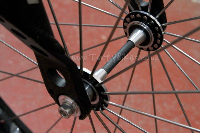

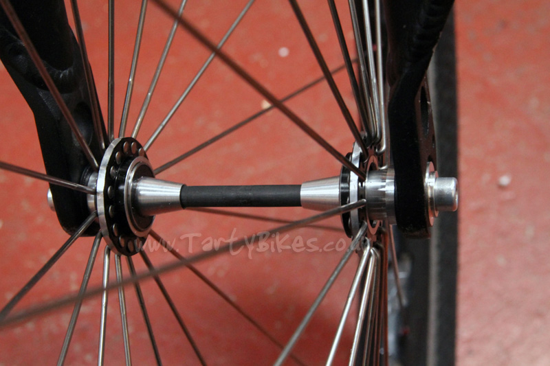

MartMini Posted September 6, 2014 Report Share Posted September 6, 2014 dont need the body? the bearings hold the flanges in place..... Quote Link to comment Share on other sites More sharing options...
FamilyBiker Posted September 6, 2014 Report Share Posted September 6, 2014 that thing is gonna fail so badly Quote Link to comment Share on other sites More sharing options...
MartMini Posted September 6, 2014 Report Share Posted September 6, 2014 (edited) that thing is gonna fail so badly how? for a start, im pretty sure its quite an old picture. The spokes pull the flanges in The bearings/axle stop the flanges from going in Wheres the problem? Edited September 6, 2014 by MartMini Quote Link to comment Share on other sites More sharing options...
weirdoku Posted September 6, 2014 Report Share Posted September 6, 2014 But when the wheel compresses the flanges move out? Quote Link to comment Share on other sites More sharing options...
Mark W Posted September 6, 2014 Report Share Posted September 6, 2014 Cap had a home-made hub like that that he ran for a reasonable amount of time. Quote Link to comment Share on other sites More sharing options...
weirdoku Posted September 6, 2014 Report Share Posted September 6, 2014 What happened to it? Quote Link to comment Share on other sites More sharing options...
Mark W Posted September 6, 2014 Report Share Posted September 6, 2014 Essentially, Cap happened to it. I think he started to make an improved version with different bearings, but they were trying to go with an even fancier axle. Then he started going from disc to rim brake and it got lost in the mists of time... EDIT: Just read back through the thread. This was actually the upgraded one (carbon axle, ACBs). The original one had an alloy axle and he ran that for 6 months. I think there was some issue with the bearing seats on this one after a while, and that's when the whole project fizzled out. 2 Quote Link to comment Share on other sites More sharing options...
Guillermo Marin Posted September 6, 2014 Report Share Posted September 6, 2014 this is awesome! 1 Quote Link to comment Share on other sites More sharing options...
Cap Posted September 6, 2014 Report Share Posted September 6, 2014 (edited) Still have the wheel and the hub still works, just not sure which safe place I left it in :/ Edited September 6, 2014 by Cap Quote Link to comment Share on other sites More sharing options...
JJ Leigh Posted September 7, 2014 Report Share Posted September 7, 2014 (edited) how? for a start, im pretty sure its quite an old picture. The spokes pull the flanges in The bearings/axle stop the flanges from going in Wheres the problem? the problem is hubs are made specifically, that doesn't look specific Edited September 7, 2014 by JJ Leigh Quote Link to comment Share on other sites More sharing options...
Cap Posted September 7, 2014 Report Share Posted September 7, 2014 the problem is hubs are made specifically, that doesn't look specific It was specifically made to save weight 2 Quote Link to comment Share on other sites More sharing options...
