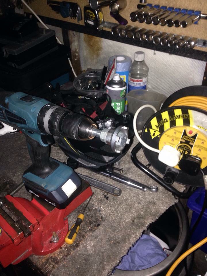

i got a freewheel-related question: is there another way of bedding in freewheel than riding around on the bike? sorry for my next-level-laziness here, but it's winter and i'm definitely not riding around on the trials bike for 4 hours as recommended. if i had known this before ordering, i would have gone for a different model, but it's too late now. since the skipping/coasting part seems to be the more important one, could i not put the wheel into the truing stand and fix the cog with some duct tape or something... and then keep the wheel spinning for half a day while watching tv? or come up with some contraption to put it on a drill and spin it on high power for half an hour??
This is how I did it
http://youtu.be/ke_Jt_lVc7E
Used a freewheel tool in a drill like this, using an m12 bolt and nut
post-29242-0-68157400-1418935686_thumb.j
post-29242-0-37689200-1418935701_thumb.j
Mine is skip free, solid engagement, loud as hell

Think I'd had a few ales at the time, but it worked spot on. It should be noted, first thing I did was wash it out with petrol. Then after that, I washed it out again to get the metal filings out, then oiled it with putoline gp10 two stroke oil. Worked a treat
