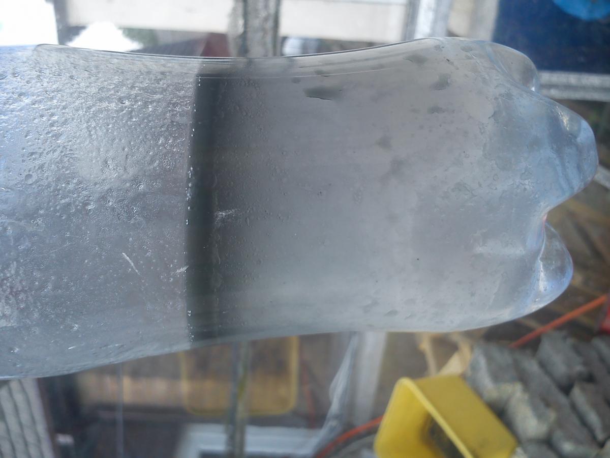

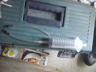

david509allen Posted August 15, 2014 Report Share Posted August 15, 2014 I did mine few days ago using a barbed fitting from tarty bikes cost a quid.a short length of pipe from a fish tank air pump i had spare and a 100ml syringe from ebay cost 1.60 i put a couple syringe fulls of water through the system first too flush it and then another syringe full through to fill the system up amd the brakes are fine with a real nice lever feelHere is my homemade bleed kit on top the tool box and the second pic shows my old magura blood mixed with water that was flushed out the ĺ 1 Quote Link to comment Share on other sites More sharing options...
