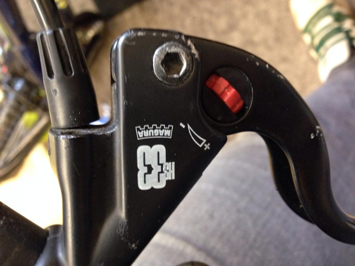

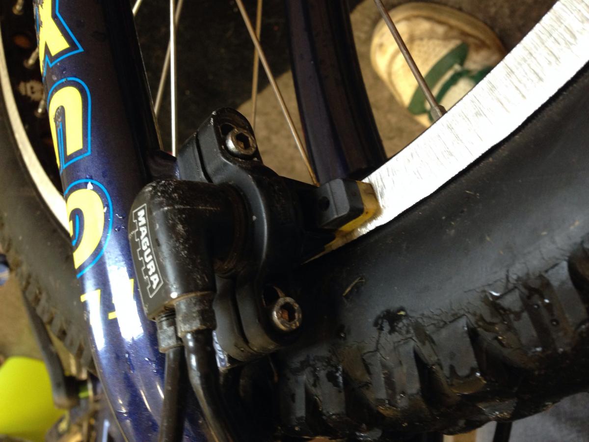

boozeman Posted August 12, 2014 Report Share Posted August 12, 2014 (edited) My zoot had magura hs33 brakes fitted when I bought it. Now I haven't bled it the brakes since I got the bike over a year ago because I don't know how to. Pure lazy I know! Anyways my problem is the fronts don't retract fully when the lever is released. One doesn't even move. Would bleeding them solve the problem or could it be something else. Also the twisty red bit has rounded off inside and doesn't actually adjust anymore. Can I get hold of a metal replacement? Edited August 12, 2014 by boozeman Quote Link to comment Share on other sites More sharing options...
ZArgrave Posted August 12, 2014 Report Share Posted August 12, 2014 if they dont fully go back into the slaves then its because the Tpa (twisty red bit) has been twisted in before it was rounded off and yes im sure there is some metal replacements in one of the for sale threads if not tartys do them too and as far as re bleeding them goes if you havent got a proper bleed kit for them they can be really easily done in your kitchen sink just using a set of allen keys. watch this video its a different model of hs33 but the same applies just the bleed bolt is in a slightly different place Quote Link to comment Share on other sites More sharing options...
bing Posted August 12, 2014 Report Share Posted August 12, 2014 You can't just bath bleed them straight away without flushing all the old oil out of the system first. My advice would be to buy a syringe and bleed pipe from tartys and flush the whole system out using hot water and fairy liquid. Then flush through with clean hot water. Then bleed using cold water and a dab of antifreeze if you want to. As for the tpa, try and get a chorrilas metal job. They work quite well from what I've heard. If you want to lubricate the slaves, pump them out with the lever and get a Teflon based spray and give them a light coating. As for the lever piston, use a bit of spray gun grease, its water resistant Quote Link to comment Share on other sites More sharing options...
