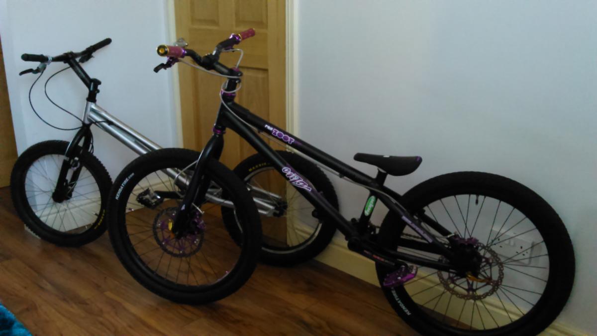

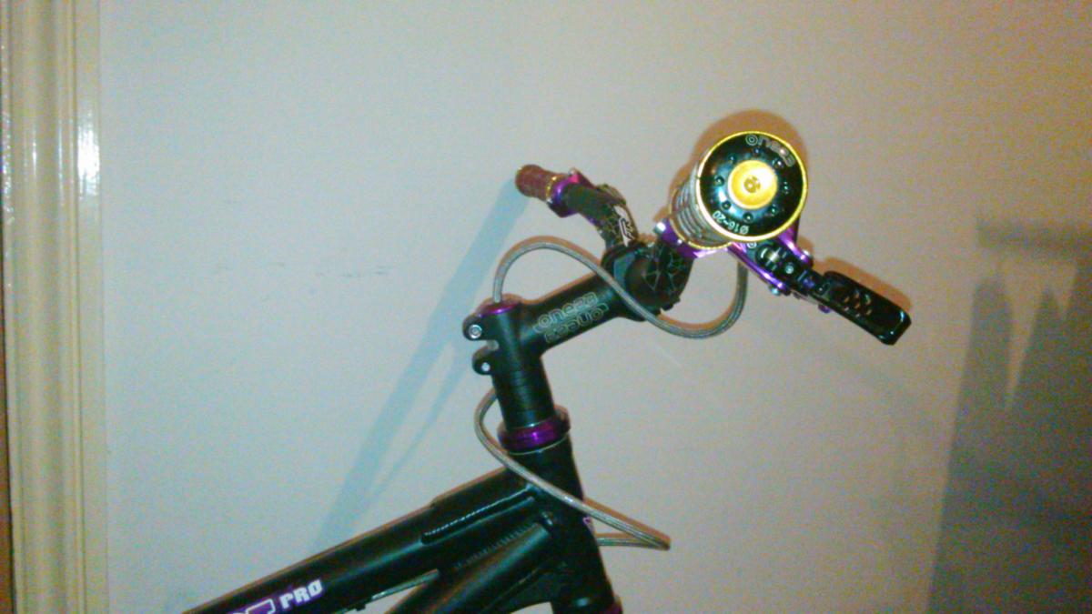

chris72 Posted August 5, 2014 Report Share Posted August 5, 2014 I have recently built up a Zoot pro but it feels quite weird to ride and do pure trials on, I was wondering if there is anything I could change like the stem to make it easier? Quote Link to comment Share on other sites More sharing options...

tdubz Posted August 5, 2014 Report Share Posted August 5, 2014 Before you start spending money try different bar angles those look a little bit back for trialsy moves Quote Link to comment Share on other sites More sharing options...
LEON Posted August 5, 2014 Report Share Posted August 5, 2014 That's a very high front for a fairly low bb, plus if you're into all the back wheel only type stuff then most people have the bars rolled forward a bit. Quote Link to comment Share on other sites More sharing options...
boozeman Posted August 5, 2014 Report Share Posted August 5, 2014 I have a zoot seatless and it felt so unnatural to ride, replaced the stem with a 90mm 35 degree rise and it already feels better. Only changed it today and have been out for about an hour but it still feels much better Quote Link to comment Share on other sites More sharing options...
waybe2014 Posted August 5, 2014 Report Share Posted August 5, 2014 This is my setup which I think is too low but would be interested to see what high level riders think (high compared to me which is most people) Quote Link to comment Share on other sites More sharing options...
chris72 Posted August 8, 2014 Author Report Share Posted August 8, 2014 Thanks for the help, I rolled my bars forward and its harder to do spinny tricks and manuals but on the whole feels so much better Quote Link to comment Share on other sites More sharing options...
