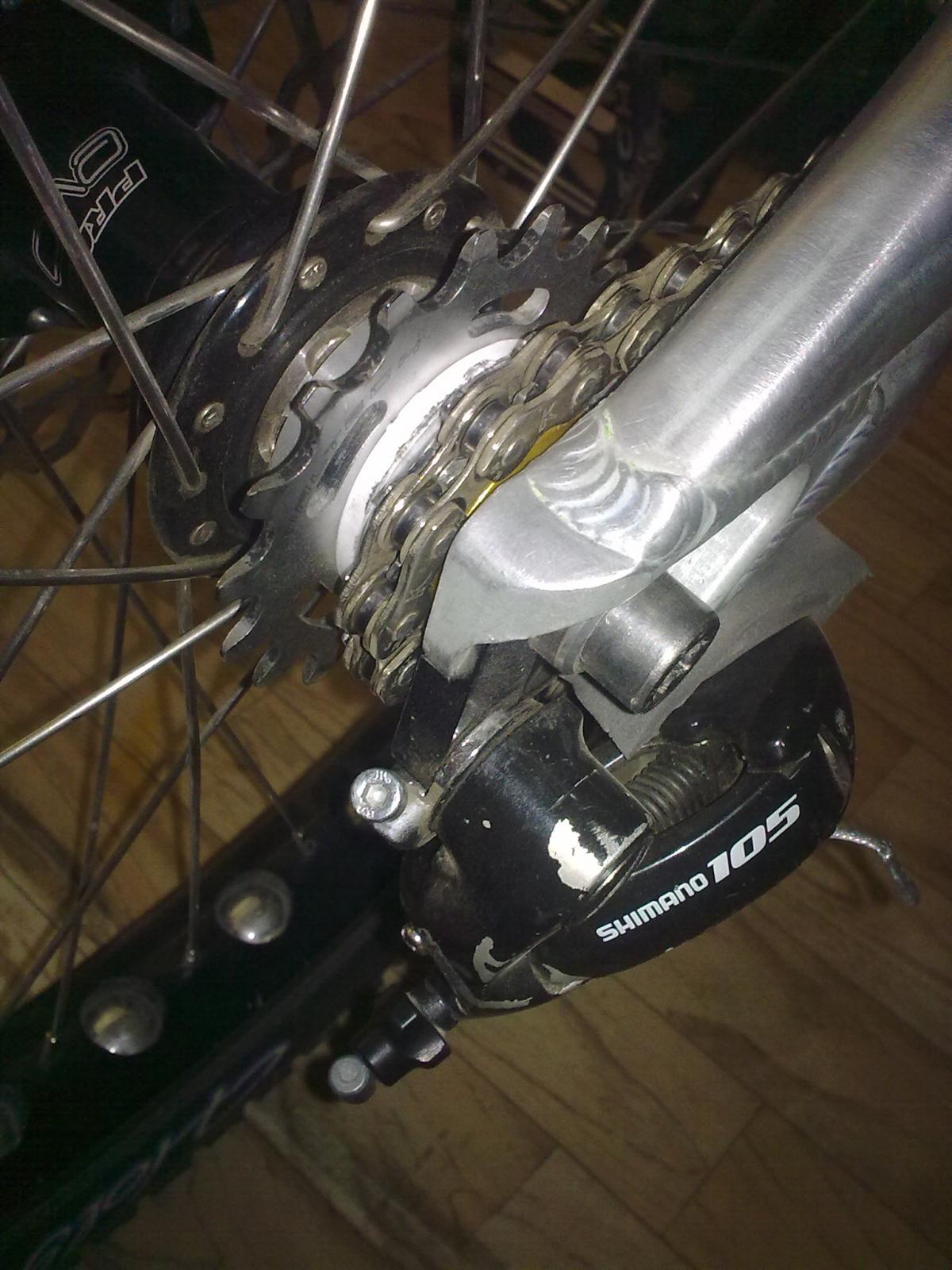

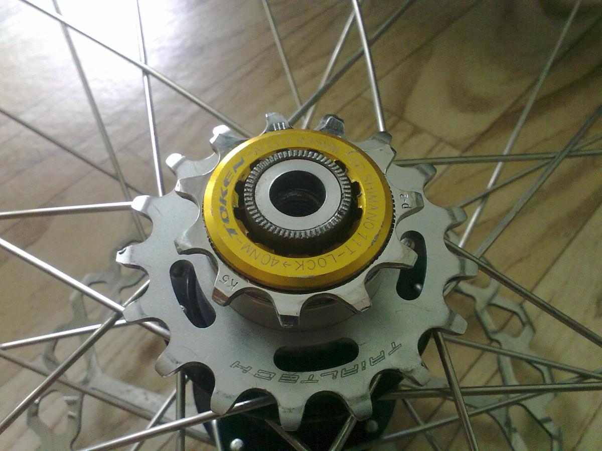

Now I'm using this setup and It's so awesome I can't live without it! Unimaginably high speed are perfect for pure street and comfy moving from spot to spot. You even can kinda cruising around or just cover so much spots as you want for just one ride.
Must have thing imo.
And my question is: can I have setup like that on Arcade/Console?

Not sure whether the chainstay length of 364mm on the Arcade is at the slammed position, but assuming it is then 22:12 would give a chainstay length of 367mm using 37.5 links as opposed to 38. Doesn't seem impossible to me, troll or not, assuming you were OK with running a half link. Obviously wouldn't be able to switch between the ratios, but there was no mention of that...

I've already found a solution. Aracde/Console CAN RUN sprung tensioner and even rear mech.

Ok let's ignore my lack of knowledge on which bikes run tensioner and the trolling of the op, theoretically how much adjustment would a sprung tensioner give In terms of rear cog 12t to?

I'm riding with setup on first picture of this thread with shimano 105 rear mech. No freakin' problem at all. Adjustment is perfect, tension with both cogs too. Whole month I have no problem with this setup.
