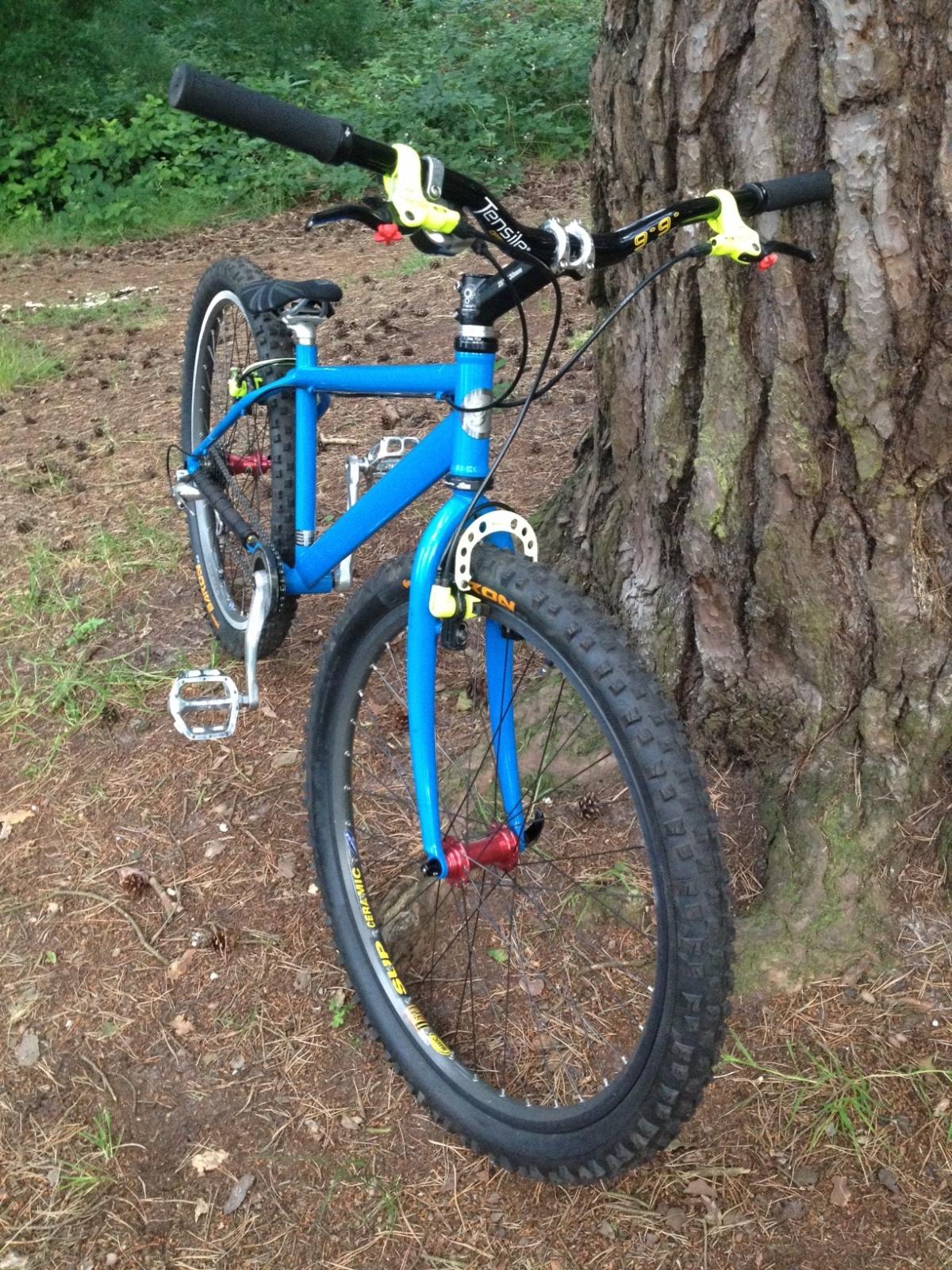

duncanp Posted July 8, 2014 Report Share Posted July 8, 2014 Hi all, Good forum you have here! I used to ride trials 10/15 years ago and recently have had a hankering to get back into it. Back in the day I always wanted a Pashley 26Mhz, but couldnt afford one. I found one last week and snapped it up as my new ride. Attached photo. I intend to restore it to its former glory, but its in pretty good nick any way. The rear rim is heavily ground and no matter how much i adjust it, the brake howls like mad and resonates through the steel frame. I swear you could hear it a mile away!! Anyway, its no good for me, and a shame as it was a really nice mavic ceramic rim. Is there any tricks to reducing this noise (different pads/sand off the grind), or am i going to have to get new a rim? Duncan Quote Link to comment Share on other sites More sharing options...
