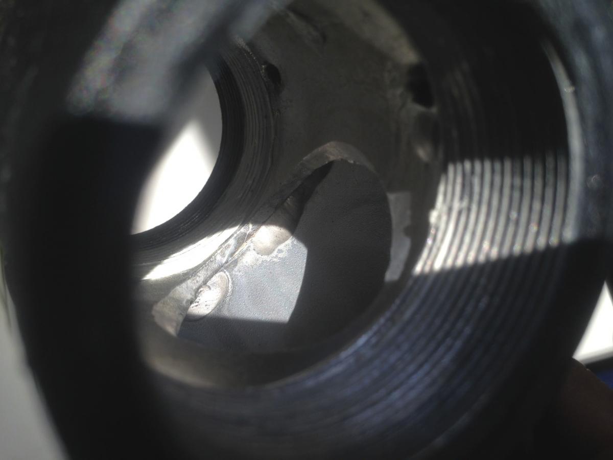

ericbenjaminjr Posted July 3, 2014 Report Share Posted July 3, 2014 (edited) I had multiple click and tick noises after building up my Ozonys Cannibal V4. Some of the sounds came from a defective ISIS mount on my left crank. So I got it replaced and my bike was silent. But every once and a while I would hear a single very faint tick. So I pushed and pulled on my cranks, bars and fork and would hear it every once and a while but not in such a way that I knew what I had to do to reproduce it. So I wedged the back wheel between my legs and twisted the bars and I could reproduce it every time. So now I'm thinking it could be the headset or bars but the sound keeps coming from the center where the bb is. But in twisting the bars with the back wheel wedged between my legs, theres no force at all on the bb. So I took the bike apart. Removed the wheels, fork, headset and bb leaving nothing but the frame just to exclude my worst fear. With the dropouts on the floor wedged between my feet, I stuck a broom stick through the head tube and twisted lightly and there is it, that light tick coming from the bb area. Its the f**king frame. I've inspected it for cracks but cant find any. So now what? I don't know if I can send the frame back to Ozonys since I've powder coated it. And if I could they take ages to ship stuff and I probably wont get another one back until the summers almost over. I don't have a clue what it could be but I probably wont have a the confidence I need to really ride anyway. WTF :'( Edited July 3, 2014 by iTrialer Quote Link to comment Share on other sites More sharing options...

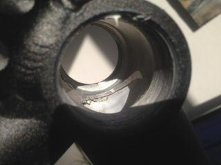

ericbenjaminjr Posted July 3, 2014 Author Report Share Posted July 3, 2014 I thought I was detailed enough in my description. Theres nothing on the frame anymore dude. Since I've posted I've even removed the bb. The frame is bare. With the dropouts on the floor wedged between my feet, I stuck a broom stick through the head tube and twisted lightly. I hear that same very faint tick coming from the bb area. I don't know if this has anything to do with anything but inside the bb, once side is welded from the inside but the other side is, well I don't even know what to call it. Quote Link to comment Share on other sites More sharing options...
ericbenjaminjr Posted July 3, 2014 Author Report Share Posted July 3, 2014 could be loose crank bolts, i thought that i had a stone stuck in my chainstay but no And once again, I've already excluded the bb. I'm able to reproduce the sound without force on the bb area. And without a bb altogether. Quote Link to comment Share on other sites More sharing options...

ericbenjaminjr Posted July 3, 2014 Author Report Share Posted July 3, 2014 From my inspection so far it seems like its metal rubbing against metal, I think where the down tube meets the bb. That could work itself into a crack over time. I've been building bikes since about 18 years and its just not me to tolerate such a thing. Its just not me to tolerate some half baked half broke shit with anything I touch. I don't care who rides with what noises not knowing if theres any more stress being put in their bikes than a retiree puts on their nordic walking sticks. Noises I can handle because I can fix them. But the f**king frame is creaking and thats not supposed to be. Its brand new and I've only ridden it a hand full of times. My neon bow creaked as well from the BB area. I couldn't find any source for it either. I've since got an inspired and. using all of the same componants and no creaking. I think some frames just creak. Not much you can do about it. Really?! So creaking is "acceptable"? Not covered in the warranty? Quote Link to comment Share on other sites More sharing options...
bing Posted July 3, 2014 Report Share Posted July 3, 2014 (edited) From my inspection so far it seems like its metal rubbing against metal, I think where the down tube meets the bb. That could work itself into a crack over time. I've been building bikes since about 18 years and its just not me to tolerate such a thing. Its just not me to tolerate some half baked half broke shit with anything I touch. I don't care who rides with what noises not knowing if theres any more stress being put in their bikes than a retiree puts on their nordic walking sticks. Noises I can handle because I can fix them. But the f**king frame is creaking and thats not supposed to be. Its brand new and I've only ridden it a hand full of times. Really?! So creaking is "acceptable"? Not covered in the warranty? I'm the same, it drives me nuts, as its a sign that something isn't right. My old limey 3 creaked like hell, and it drove me mad. Partly the reason I got rid, as well as swapping just about every part to try and shift it. It is unacceptable if its a new frame Edited July 3, 2014 by bing 1 Quote Link to comment Share on other sites More sharing options...

*gentlydoesit Posted July 3, 2014 Report Share Posted July 3, 2014 I thought I was detailed enough in my description. Theres nothing on the frame anymore dude. Since I've posted I've even removed the bb. The frame is bare. With the dropouts on the floor wedged between my feet, I stuck a broom stick through the head tube and twisted lightly. I hear that same very faint tick coming from the bb area. I don't know if this has anything to do with anything but inside the bb, once side is welded from the inside but the other side is, well I don't even know what to call it. IMG_4762.jpgIMG_4758.jpgneither are welded internally, both are just the penetration from the external weld. Quote Link to comment Share on other sites More sharing options...
ericbenjaminjr Posted July 3, 2014 Author Report Share Posted July 3, 2014 neither are welded internally, both are just the penetration from the external weld. Thanks for that. I obviously know nothing about welding. Any idea if riding the frame with such noises could mean cracking at some point? If you could post a video it might make it easier to diagnose. Heres the video: Quote Link to comment Share on other sites More sharing options...
FamilyBiker Posted July 3, 2014 Report Share Posted July 3, 2014 (edited) sorry to say and deffo dont want to alert you mate,but every single frame i've seen in years over years as a bike mechanic if making that noise had some kind of crack. maybe some weld not being fully closed and joint faces rubbing each other but definitely a warranty case imo Edited July 3, 2014 by FamilyBiker Quote Link to comment Share on other sites More sharing options...

Blake Posted July 3, 2014 Report Share Posted July 3, 2014 Sounds like my welds, insufficient penetration to the material so the metal is only held together on one side on the surface. Meaning there's room to creak and ping and crack and flack and back and smack. Powder coating will void the warranty, maybe wait till the warranty has expired next time? It will be fine to ride just man up Quote Link to comment Share on other sites More sharing options...
*gentlydoesit Posted July 3, 2014 Report Share Posted July 3, 2014 Sounds like my welds, insufficient penetration to the material so the metal is only held together on one side on the surface. Meaning there's room to creak and ping and crack and flack and back and smack. It will be fine to ride just man up Ally is a bit like that, you really only penetrate one side. Imagine two layers of cling film with water in the middle to be the composition of the metal, you can only weld through the first layer into the water. If you go through both sides the water leaks out. In ally that means a big hole :/ Ally weld is prone to shrink cracking, and the crack can be incredibly fine. Could be responsible for the sound?? Quote Link to comment Share on other sites More sharing options...
