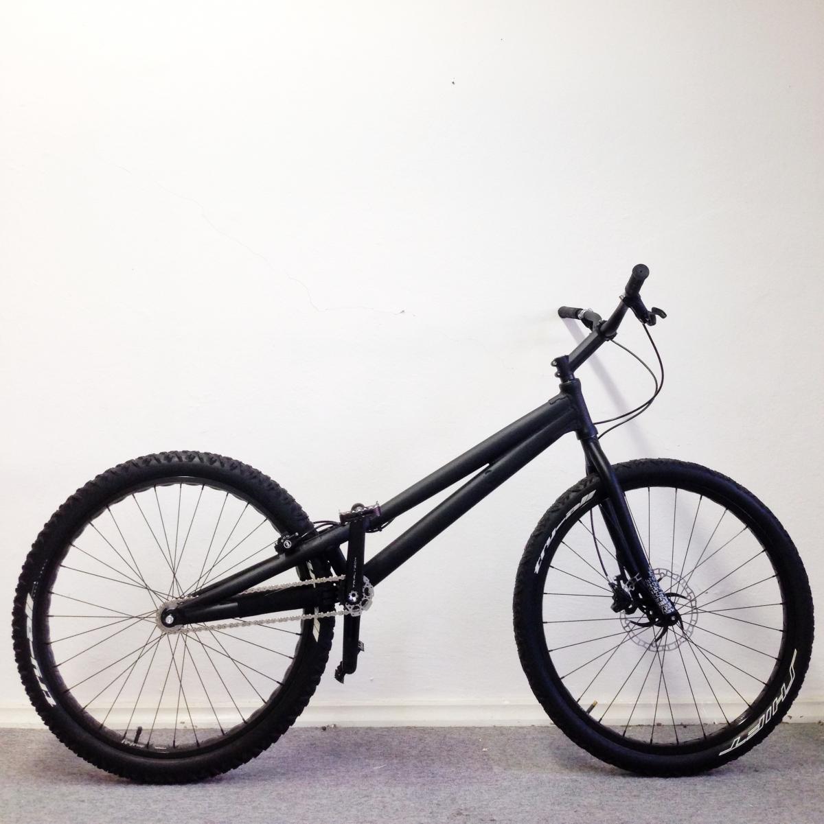

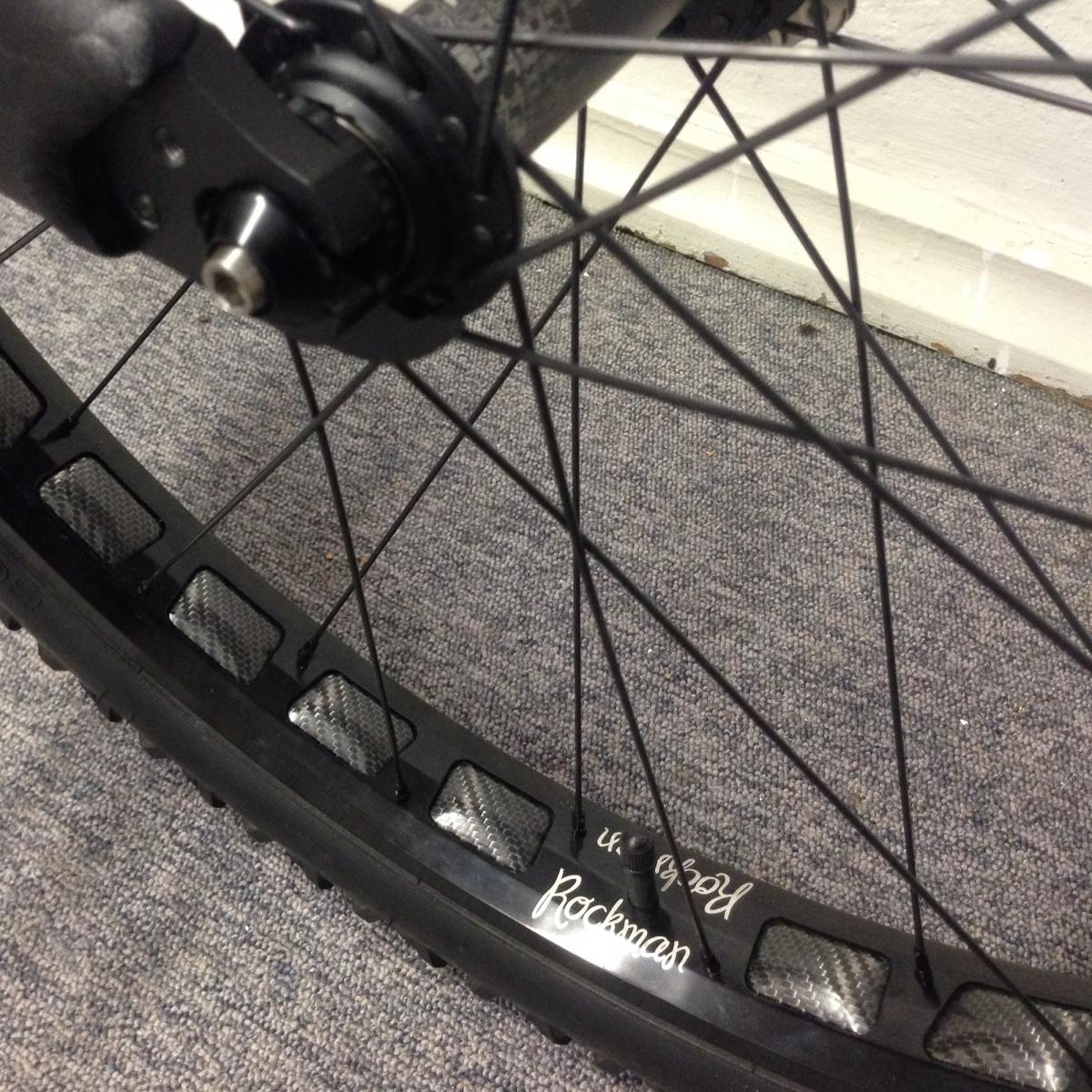

ericbenjaminjr Posted June 25, 2014 Report Share Posted June 25, 2014 (edited) Just finished my Ozonys Cannibal. My goal was to build the best compromise between street/trials and light/strong possible. I tried to keep everything stealthy black design wise. Decided to try something new using carbon fiber accents. I'm still getting used to it but its by far the best bike I've ever built. The geo is perfect for my riding style. Weight is 8.4 kilo. I've never ridden a bike this light and I didn't expect it to have such a big impact on my riding but O M G !!! Its very responsive and predictable. But I've had to drastically dial down the strength and body language I put into some moves because it gives back so much more than my old bikes. So far so good! Specs: updated 18/09/2014 Frame: Ozonys Cannibal V4 Frame Geometry: Wheelbase: 1055mm, BB Rise: 45mm, Head tube angle: 71.5° Front Wheel: Rockman 28 hole rim, Schwalbe Rocket Ron tire, custom carbon fiber weave rim tape, Trialtech Sport Light hub with ti bolts, Sapim 2.0/1.8/2.0 spokes, VIZ aluminum nipples, 2 cross half radial lacing Rear Wheel: Rockman 32 hole rim, Schwalbe Nobby Nic tire, custom carbon fiber weave rim tape, Trialtech Sport Light hub with ti bolts, Sapim 2.0/1.8/2.0 spokes, VIZ aluminum nipples, 3 cross lacing Drivetrain: Trialtech SL cranks, Trialtech single cage pedals with Stan titanium axles, Try-all Symetrik rock ring, Echo SL Freewheel, Trialtech SL bottom bracket, Trialtech 15t rear sprocket, KMC Z610HX chain, Clean snail cams Steering: Trialtech SL bars, Trialtech foam grips, Trialtech Sport stem with ti bolts, Trialtech SL Ti Topcap, Bonz Pro Light integrated headset, Trialtech Sport Light disc only fork Front Brake: Magura MT-2, 180mm Ashima ARO 08 Ultralight disc rotor, ti bolts Rear Brake: Magura HS-33r with Trialtech Y splitter, Heatsink CNC Yellow brake pads, Echo TR brake clamps, ti bolts Cut 0.2mm carbon fiber sheet, wrapped the steerer tube and cut out inlays for the frame. laminated real carbon fiber weave for rim tape. I think the jaf ring with the try-all no war crank bolts make a nice combo. I'm not too sure about the top cap though. Looked better in my mind... Building and bleeding these was the worst nightmare I've ever experienced in all my bike building years. The final product. Edited August 18, 2014 by ericbenjaminjr 10 Quote Link to comment Share on other sites More sharing options...

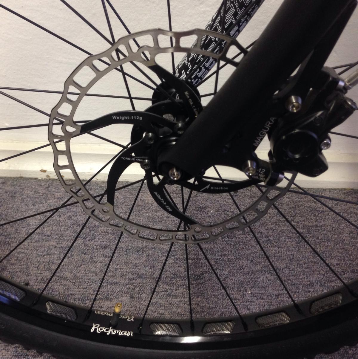

SamKidney Posted June 25, 2014 Report Share Posted June 25, 2014 How're those rear brake pads working for you? Quote Link to comment Share on other sites More sharing options...
ericbenjaminjr Posted June 25, 2014 Author Report Share Posted June 25, 2014 (edited) They're ok(ish) but maybe too soft. I ran them on my old bike with tar and found that it ripped out small chunks of rubber. So I filed them down and still trying them out without tar to see how they do. I'm waiting on a set of Heatsink Blueberry CNC pads to compare. Edited June 26, 2014 by iTrialer Quote Link to comment Share on other sites More sharing options...

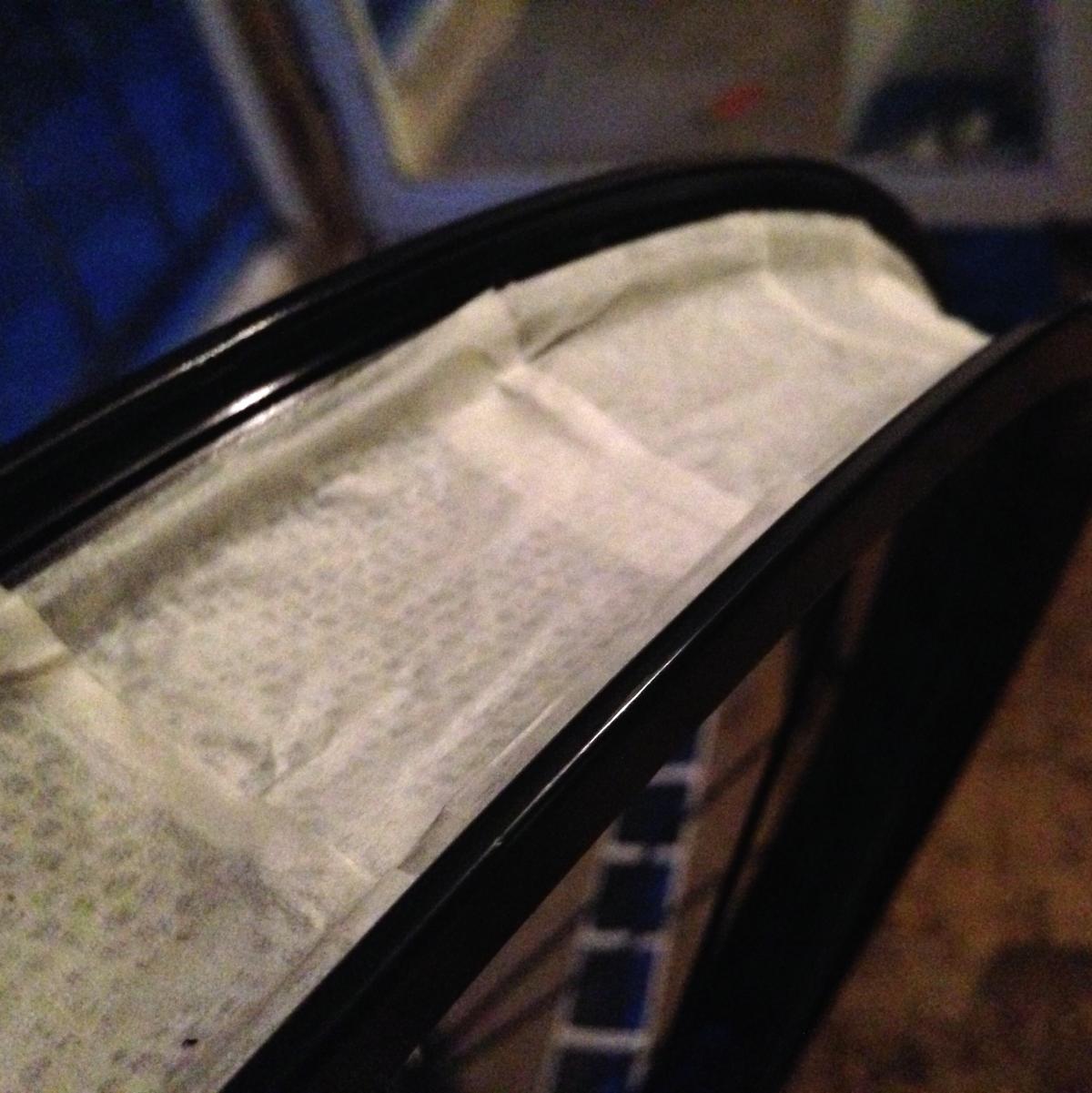

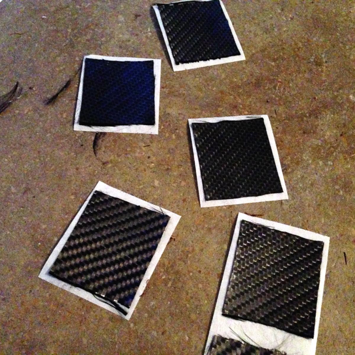

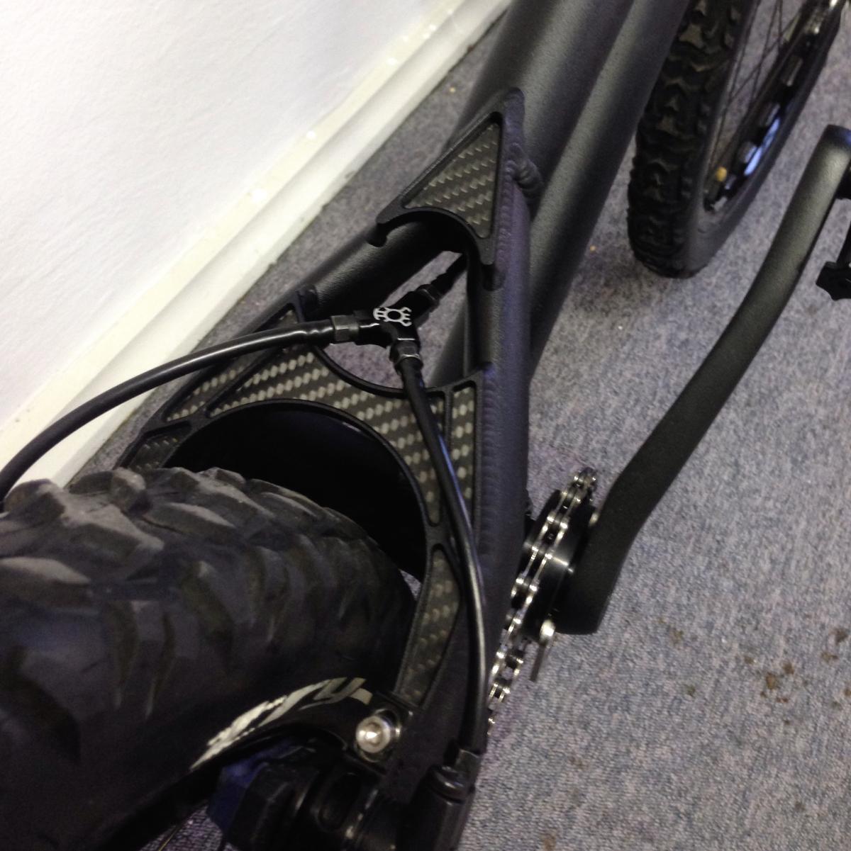

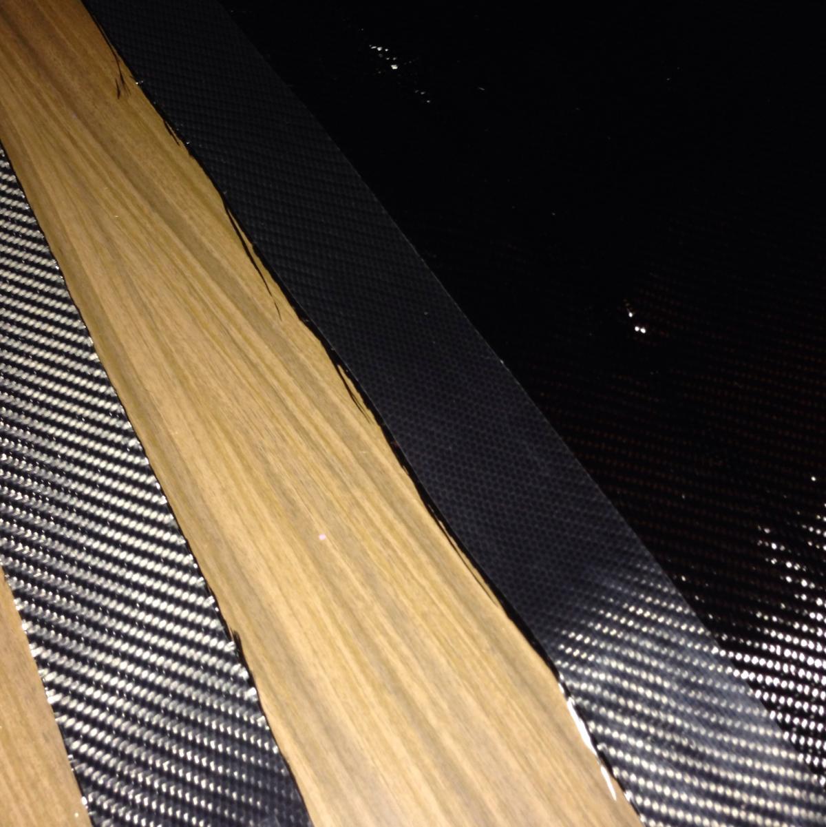

*gentlydoesit Posted June 26, 2014 Report Share Posted June 26, 2014 (edited) Love the carbon rim tape I'd thought about getting gold or silver weave but couldn't find any . Why did you cut it into squares? Totally agree, splitters are and absolute twat to fit and bleed! could have been worse though, you could have gone for racing line ones like I did. Edited June 26, 2014 by *gentlydoesit Quote Link to comment Share on other sites More sharing options...
ericbenjaminjr Posted June 26, 2014 Author Report Share Posted June 26, 2014 I tried wrapping it in one piece and ruined a strip. The weave itself deforms nicely but not the plastic I used to laminate. I'm experimenting with the leftovers to try and find a way to do a one piece rim tape. You can get silver fiberglass weave easy and much cheaper than carbon fiber. Quote Link to comment Share on other sites More sharing options...

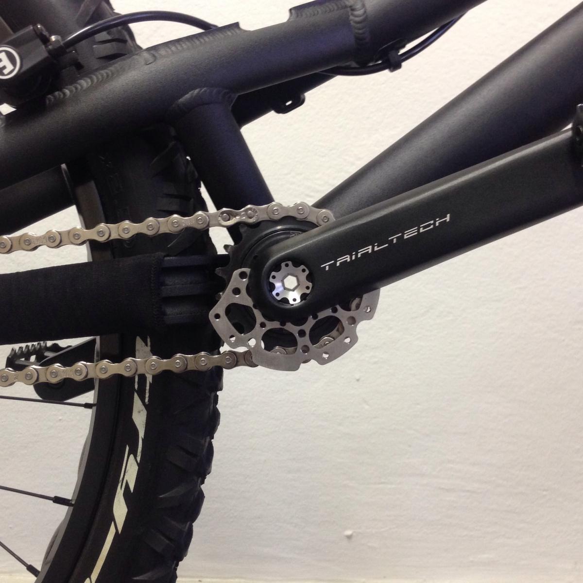

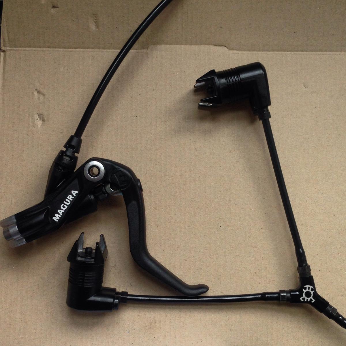

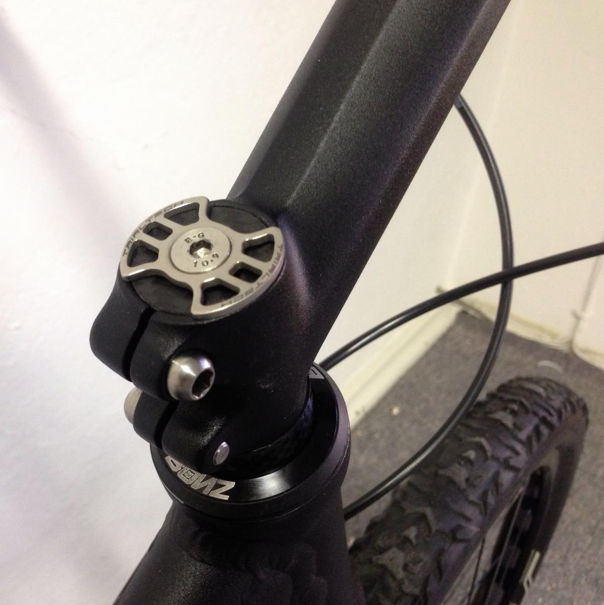

Ross McArthur Posted June 26, 2014 Report Share Posted June 26, 2014 (edited) Get rid of that quick link NOW!! Thats going to seriously ruin your day when it snaps. They're not known for being strong, and that one looks bent and f**ked already. That a-side, holy mother, thats hawt! Well done on the build. One little thing that annoyed me was the steerer top cap bolt looks a bit gash. Something a bit cleaner would be better. Forgot to say, I'm loving the matching levers for the disc and rim brake combo! Not often you see that. Edited June 26, 2014 by Ross McArthur 2 Quote Link to comment Share on other sites More sharing options...

ericbenjaminjr Posted June 26, 2014 Author Report Share Posted June 26, 2014 (edited) Get rid of that quick link NOW!! Thats going to seriously ruin your day when it snaps. They're not known for being strong, and that one looks bent and f**ked already. That a-side, holy mother, thats hawt! Well done on the build. One little thing that annoyed me was the steerer top cap bolt looks a bit gash. Something a bit cleaner would be better. Forgot to say, I'm loving the matching levers for the disc and rim brake combo! Not often you see that. Yeah you've mentioned the two things on my mind. I have a carbon top cap bolt on the way and that link bothers me too. Its not bent yet but I'll be pressing a link in as soon as I get my tool. that's so nice that I'd be scared of riding it just in case I scratched it! great job I know what you mean. The first scratch is always kind of ... liberating Edited June 26, 2014 by iTrialer Quote Link to comment Share on other sites More sharing options...
Ross McArthur Posted June 26, 2014 Report Share Posted June 26, 2014 I use this http://www.tartybikes.co.uk/chains/kmc_split_link/c7p11014.html Works a treat. Even rejoining chains can be bad news. Quote Link to comment Share on other sites More sharing options...
ericbenjaminjr Posted June 26, 2014 Author Report Share Posted June 26, 2014 Thanks for the tip! Quote Link to comment Share on other sites More sharing options...
dann2707 Posted June 26, 2014 Report Share Posted June 26, 2014 Sexiest build on here for a long time and you choose to use tie fighter pads?!?!?!?!?!! Get some ADM's, they're black too 1 Quote Link to comment Share on other sites More sharing options...
Ross McArthur Posted June 26, 2014 Report Share Posted June 26, 2014 Phat pads do a black backing which could look good! Quote Link to comment Share on other sites More sharing options...
ericbenjaminjr Posted June 26, 2014 Author Report Share Posted June 26, 2014 I'm still waiting on a set of Heatsink Blueberry CNC pads. I'm not so much concerned about the color of the pads just the performance. Although if could powder coat or paint them I probably would :-P Quote Link to comment Share on other sites More sharing options...

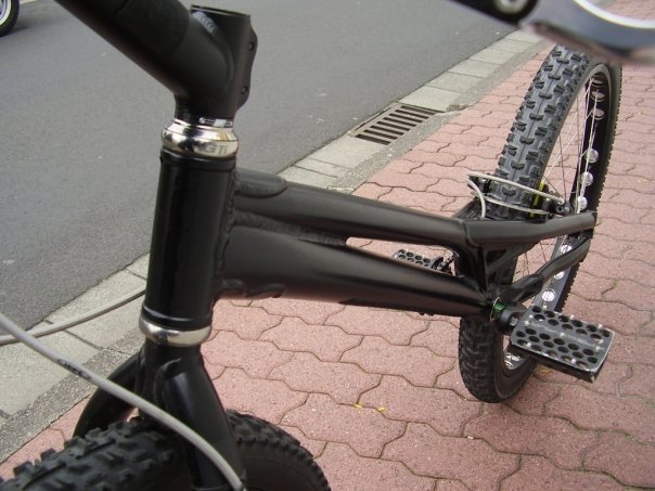

Rusevelt Posted June 26, 2014 Report Share Posted June 26, 2014 Makes me think back to the days when the 07 Adamant A1 kinda started the whole stealth black look Quote Link to comment Share on other sites More sharing options...

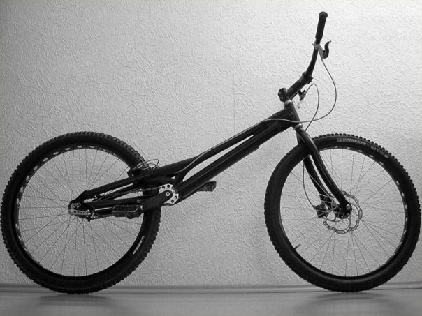

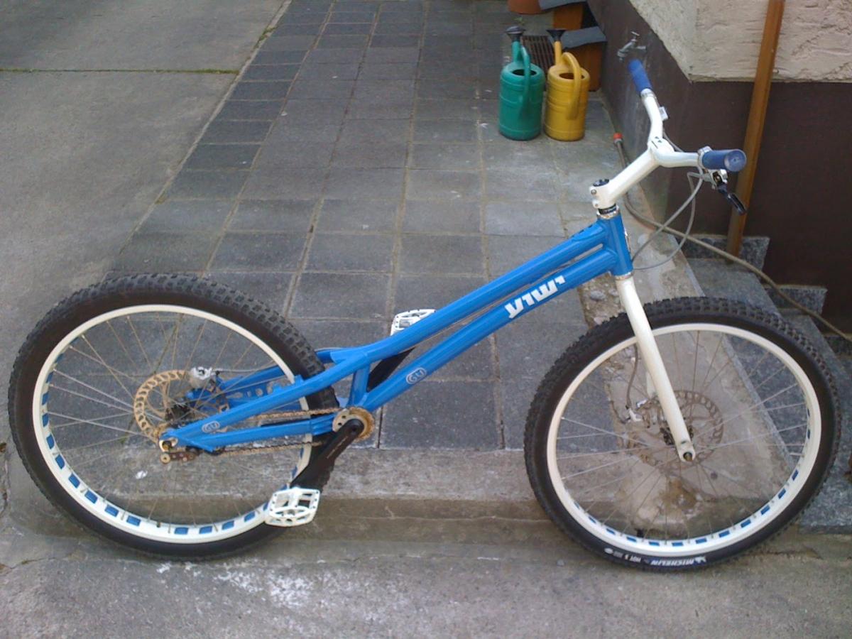

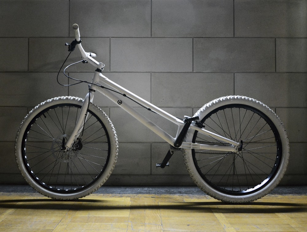

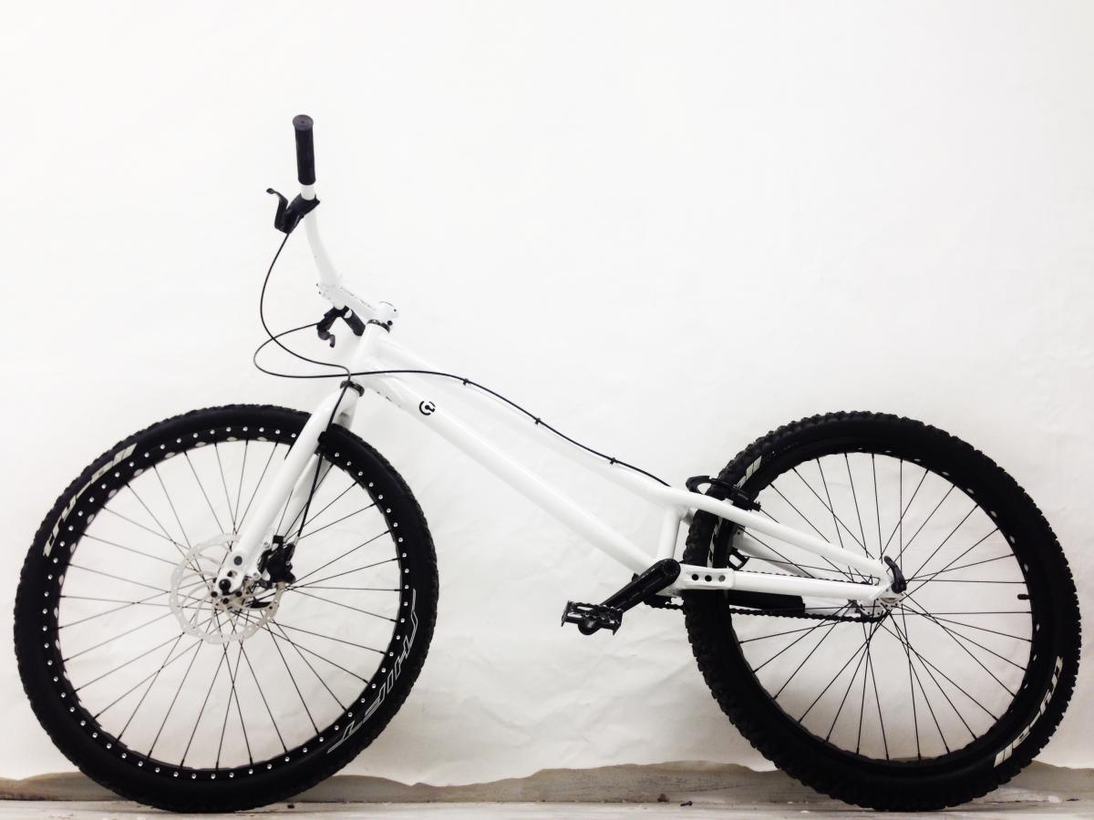

ericbenjaminjr Posted June 26, 2014 Author Report Share Posted June 26, 2014 (edited) Makes me think back to the days when the 07 Adamant A1 kinda started the whole stealth black look Did you say Adamant? A short recap of my bike history. I started building stealth bikes with my second trials bike when I powder coated my zoo pitbull. Adamant used to be my favorite I rode it for about 5-6 years. Sadly I don't have any better pics of it. Just this failed attempt at product photography. It was my third trials bike. Then I went all colorful but I had to sell this one for financial reasons. The fork was a bad decision anyway. And who knows how long the rear disc would have held up. I didn't ride for almost 4 years and this is what I built to reenter the sport. The frame was really flexy and I never felt secure on it. So I made some minor changes to lighten it up and finally had bike that felt good after so many years without wheels. Simultaneously I started drawing up the concept for the cannibal. Luckily I had buyers lined up for all the parts and frames I wouldn't need. I hope to ride the cannibal one at least as long as I did my adamant. Edited June 26, 2014 by iTrialer 2 Quote Link to comment Share on other sites More sharing options...
Blake Posted June 26, 2014 Report Share Posted June 26, 2014 I'm still waiting on a set of Heatsink Blueberry CNC pads. I'm not so much concerned about the color of the pads just the performance. Although if could powder coat or paint them I probably would :-P Are you after performance on a smooth rim? Yellows over blues man blues are poopoo Quote Link to comment Share on other sites More sharing options...
ericbenjaminjr Posted June 26, 2014 Author Report Share Posted June 26, 2014 Yellow for smooth rims? Quote Link to comment Share on other sites More sharing options...

jack dickinson Posted June 26, 2014 Report Share Posted June 26, 2014 Are you after performance on a smooth rim? Yellows over blues man blues are poopoo +1 yellows ***!! Yellow for smooth rims? yes or they work witha dead or light grind as well Quote Link to comment Share on other sites More sharing options...
