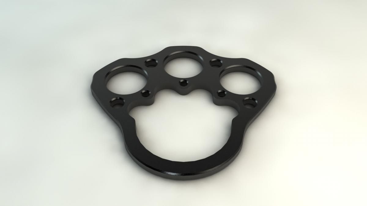

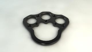

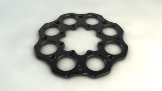

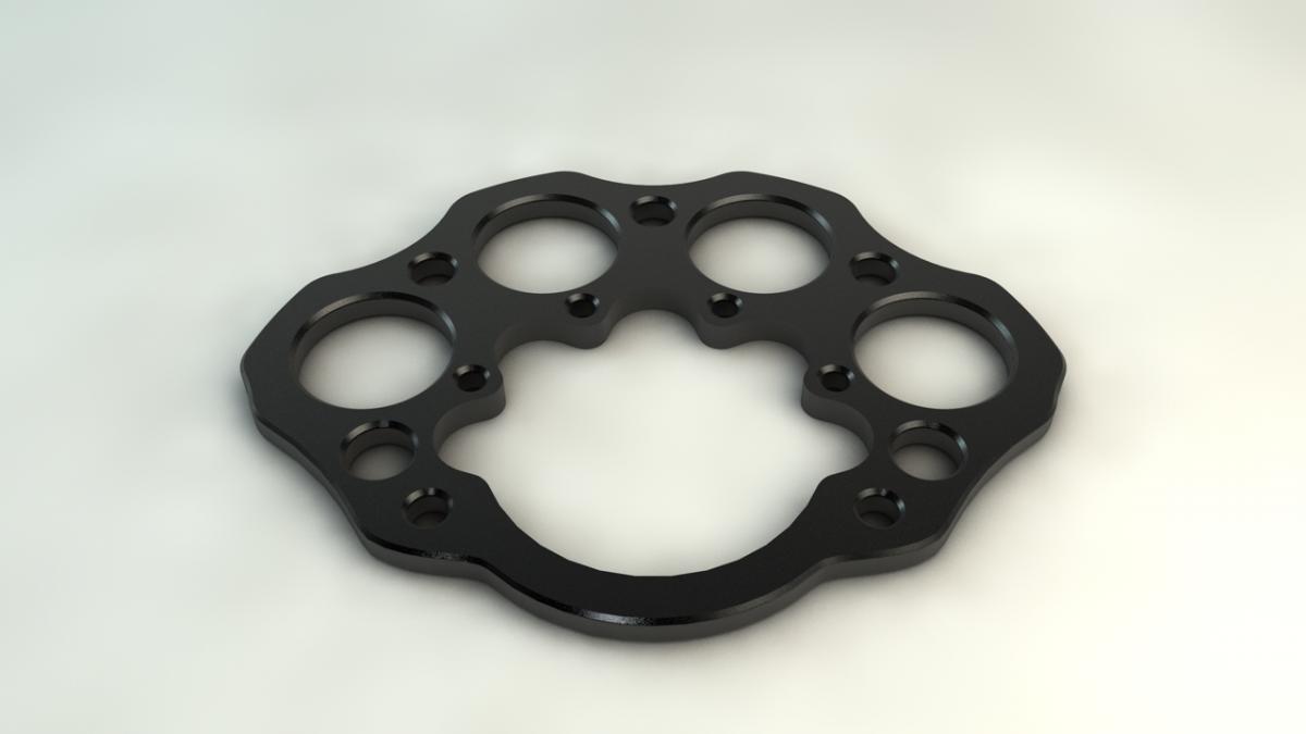

ericbenjaminjr Posted June 10, 2014 Author Report Share Posted June 10, 2014 Got the full and quarter rings done 3 Quote Link to comment Share on other sites More sharing options...
bing Posted June 10, 2014 Report Share Posted June 10, 2014 I'll test the 3 holed version if you want to donate one to me Quote Link to comment Share on other sites More sharing options...
