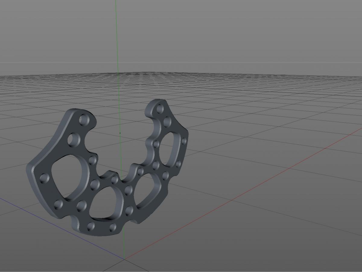

Yeah you're right, the original has two sections without any holes at all. But like I said, this was only a workflow test. I needed a subject right away. This workflow is for an 8 section design. Jaff was a great subject because of the complexity. I'll be making a few more workflows before I start to get creative myself..

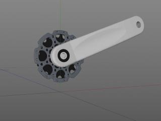

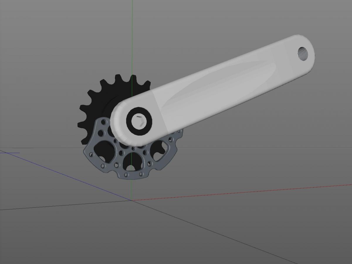

I added a generic crank and freewheel to the template so I can better see what the end result would look like. Also started drawing up a few ideas of my own on paper. Actually came up with a few. But I'm still very interested in whats wrong with the JAF ring. I really love the design and maybe I can improve on it..

They're good. I have bent mine to the point it affected my drive train. I bent it back. Loosened my ffw rotated the bash and I'm still using the same ring...
Make it so you can put a bolt in it that sits against the crank so when you tighten the ffw the bash can't rotate...

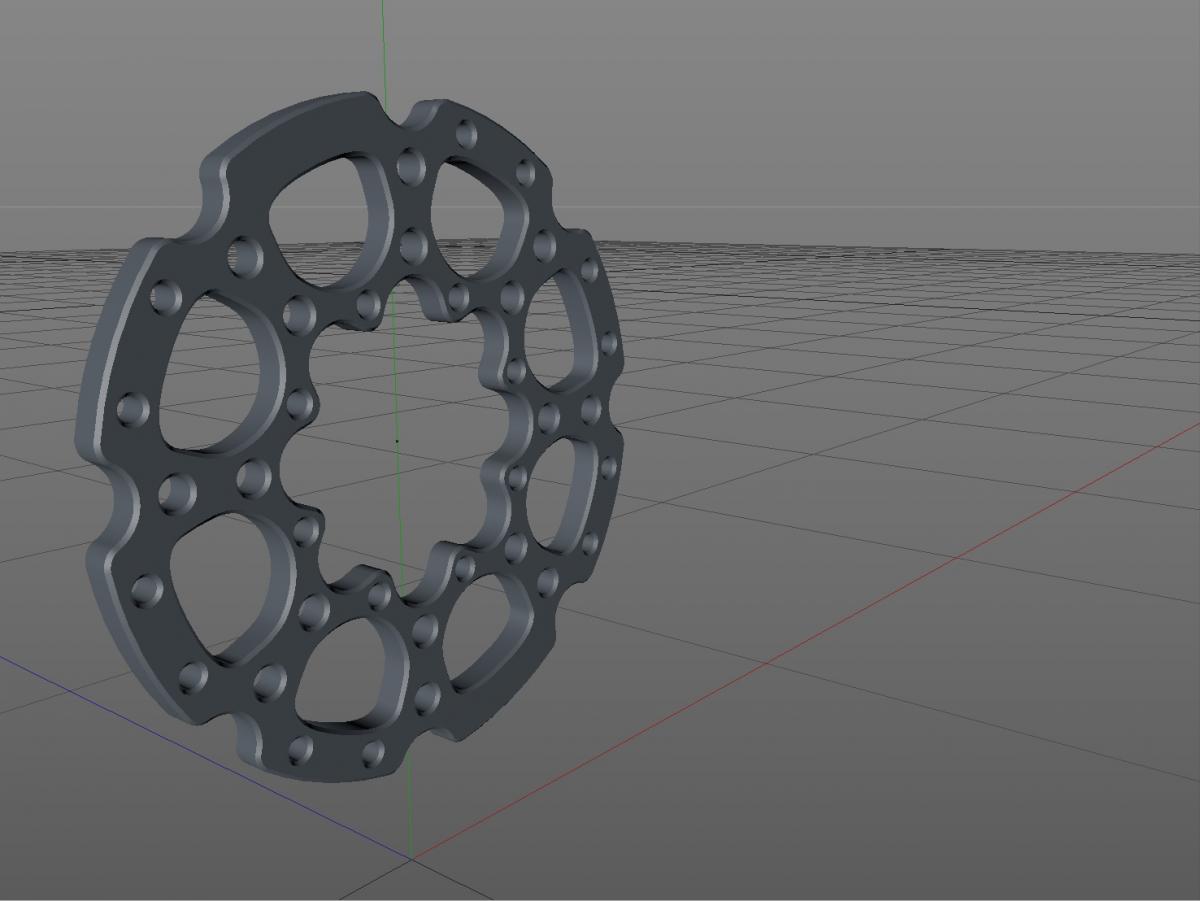

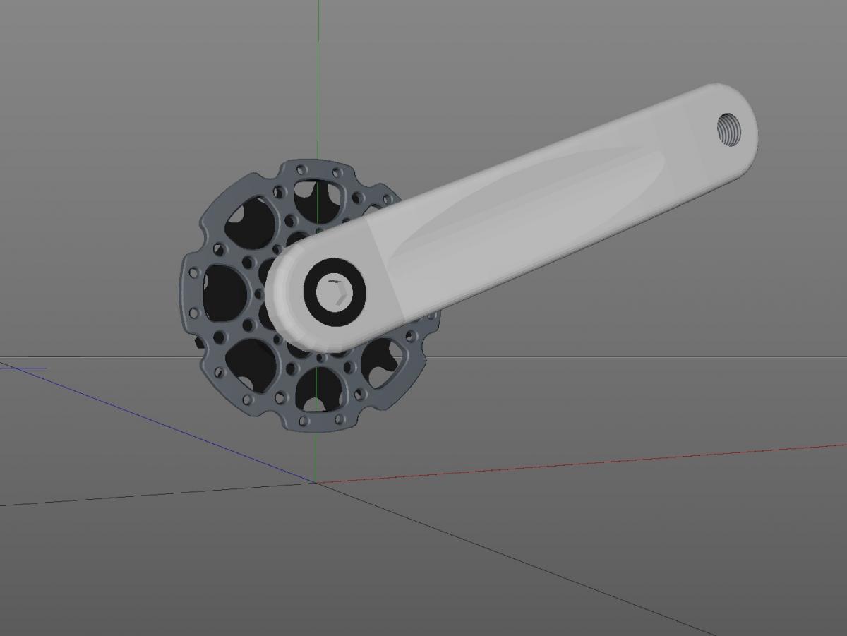

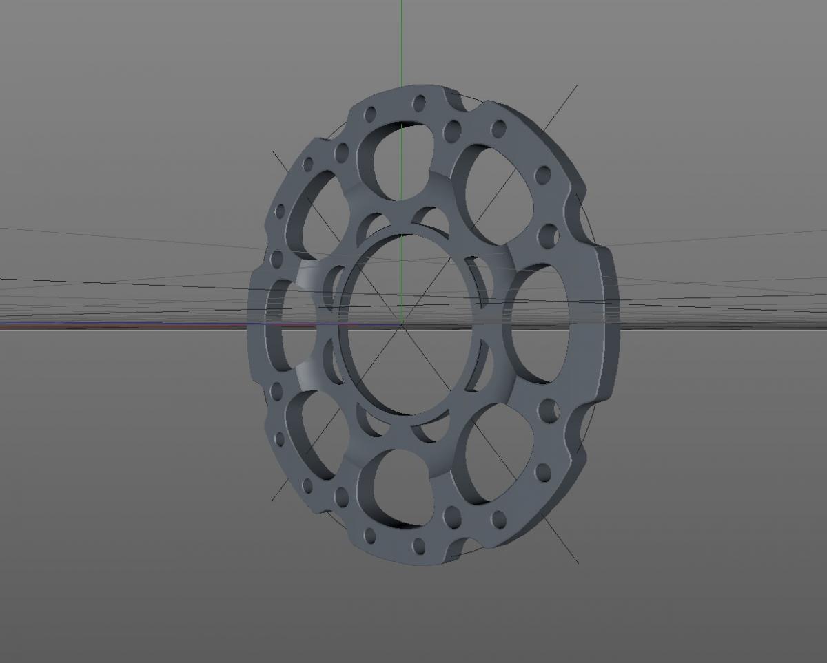

Well bending isn't good. Never had a bash ring bend on me. Not really something I'd like to start accepting as normal. I made a few changes to prevent bending, and a few minor design changes as well. This is of course no long a steel design.
1. Made it taper to 5mm thicker.
2. Removed some holes.
3. Left the ring around the crank intact. You still wont see it when the crank is on.

Will the new taper clear the crank?
What material are you thinking of using?
Yeah it tapers to the inside towards the freewheel. The crank side is flat. I'm thinking of 7075 aluminum. So far this is all theory. Fun and games with the option to get serious if I come up with something really good.
i'd agree that bending isn't good, but snapping a bashplate isn't good either; alu is likely to bend but if it does it's usually likely to die soon after. bending back the ring wasn't a problem either (Y)
the impact that bent it was a bit of a wierd scenario, i don't imagine any bash ring would have faired very well in the incident.
I understand. I guess you're right. I've never run a bash ring that wasnt tapered.
I've been reading up on the properties of 7075 aluminum and it seems to be the perfect choice for this bash ring. It has the lightness of aluminum and hardness of steel.
I'm no physics expert but I imagined the JAF ring as a straight bar with all its waves and cutouts and imagined twisting it would be fairly easy. Thats how I came up with closing the inner ring, thinking it would stiffen up the structure as a whole. I need to research how I could get one off prototypes done cheaply. Maybe I would take this a bit further...

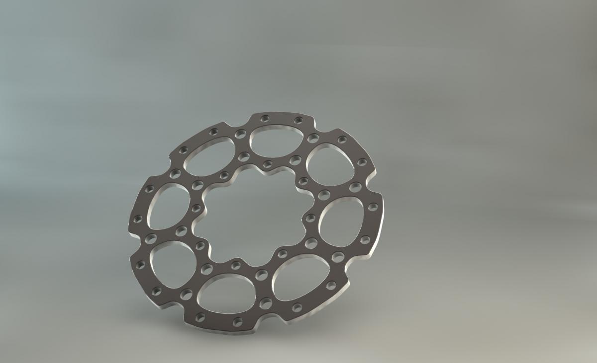

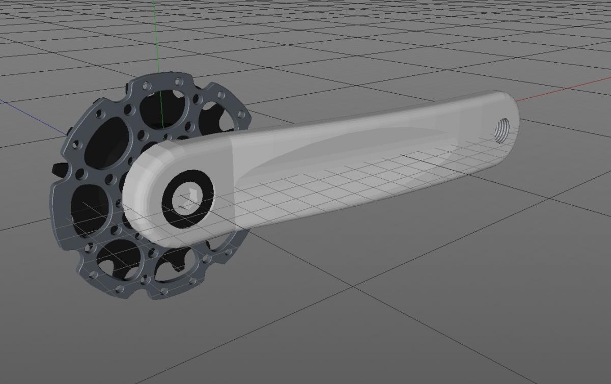

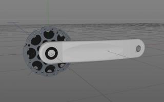

I finally got some time to finish up the remake. I decided on keeping the design as close as possible with the few minor changes. I made the diameter 91.1mm to prevent the chain being hit between the cutouts around the outer rim. The large cutouts are a bit larger and all the same shape. I did a bit of research and I'm thinking making the entire ring 5mm thick will be enough to prevent bending. I'm just wondering how much lighter it would be with 7075 alu or if at all due to the thickness.
I also got my Jaf ring from TartyBikes. Its 3mm thick and just by looking at it I know I'll bend it sooner or later. So I'll be moving on to some of my own designs now.

i always think 5mm clamp section is always overkill on bashrings. I always ran 3mm, and had no issues.
I'd rarther destroy a bashring, then strip the threads on a crank due to their not being enough thread engagement.
Yeah, I had an echo urban I think it was. Didn't fancy using it on my zhi cranks, worked well on my tryall though. Guess it depends on the cranks you ride.
Thanks for the info guys. I'll check into it a bit more.

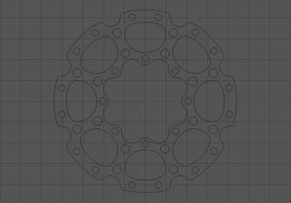

I've done a bit more research and asked around a bit. It seems 5mm is ok but not optimal for all setups. So I'm going to wait and try out my original JafBikes ring until I bend it and analyze the damage.

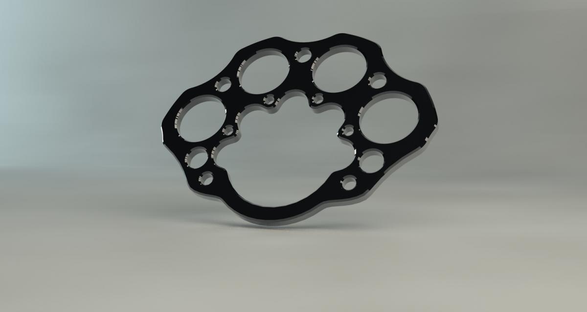

In the meantime I worked on one of my own designs. I couldn't help myself but to be inspired by the Jaf ring though. I took a guess on completing the circle of the ring hoping it would provide some stiffness. This is my first draft. I call it the knucklering.
