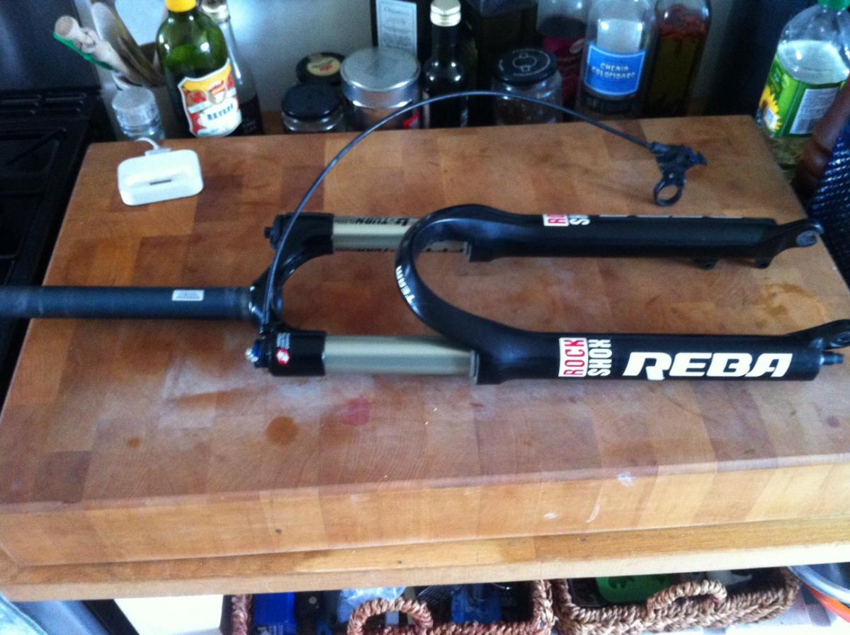

I just got my rebas off Paul Oliver and they're awesome, set them up right and they're super plush, can be locked out to help with some climbs and lightweight to boot. My only issue with them is that they're only 4.5" travel on my 5.5" frame, ideally I should have some 5" forks minimum but they work ok if you increase the preload to make them run higher in the travel.
  • Like 1
To be honest Paul sold me the forks for far less than their market value, that was his decision though not mine - I just got a monster of a deal!
About 150 quid seems to be the going rate for them dependant on spec and age, mine are 2007 dual air u-turn teams with remote lockout. From what I've read the dual airs are better forks because you can fine tune the negative chamber to adjust the plushness. The motion control damper is ridiculously simple once you figure out how it works.
I'm still in two minds wether to ditch the remote lockout or not, without it you can set the compression damper to work as a slow speed circuit by adjusting the floodgate control; with the remote lockout it is either locked or fully open. If you get some non lockout rebas then I might consider a try out swap of the dampers if you fancy it?
