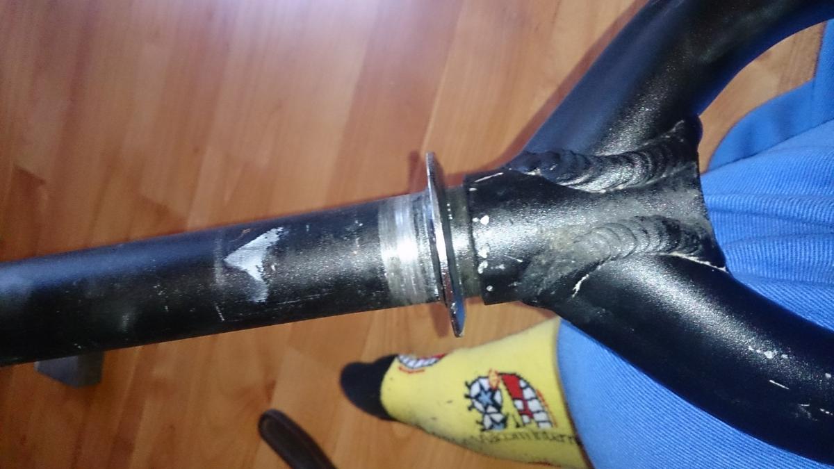

HippY Posted April 23, 2014 Author Report Share Posted April 23, 2014 (edited) just checked: I have every part, bearings, cups, crowns, compression ring and crown race as well Now I need to hammer the crown race to the bottom of the steerer tube. How should I do it if I dont have any larger tubes? If I would use a spanner, that is larger than the steerer and sits on the crown race, and just hammer would it be good? The crown went down as low as this, now it needs a proper hammering Edited April 23, 2014 by UKHippY Quote Link to comment Share on other sites More sharing options...
dezmtber Posted April 23, 2014 Report Share Posted April 23, 2014 Chop the fitting end off an bmx stunt peg a basic steel one the remaining part can be used as a headset crown setter. if the crown still is way too tight, cut a slot into the crown race with a hacksaw so it expands over the fork. basicly convert your unslotted crown race into a slotted one much like hope use. Quote Link to comment Share on other sites More sharing options...
Blake Posted April 23, 2014 Report Share Posted April 23, 2014 nice socks. Screwdriver and a hammer has worked in the past with me 1 Quote Link to comment Share on other sites More sharing options...
