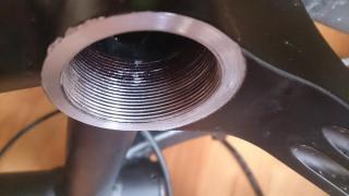

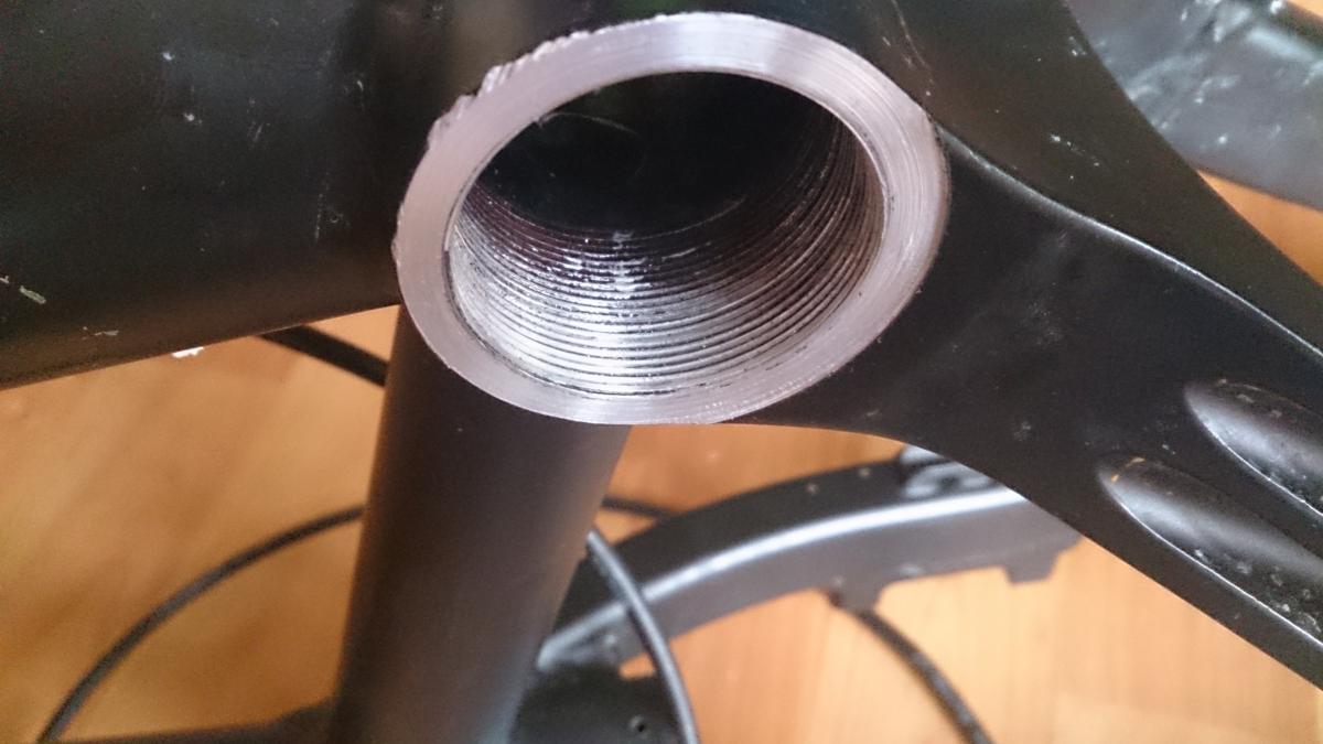

well, I got my BB tool, so I started to insert the BB
Non drive side went in easily, finely, no problems
Drive side... well I greased it, turned it clock wise, click noise, turn it anti clock wise to tighten it... and it get stuck after 3mm.
I thought that it can be normal so I used a little power there, turned ut back as well, nothing
It is got stuck at the same spot, after 2-3 threads but I see nothing in the threads, what should it be?
Could always get the threads chased at your lbs
it seems like found the problem, it is crossthreading. I bring the frame to my Local Bike Shop (or Legendary Burrito Shop, not sure atm) and ask them if they can chase the thread a little bit.
