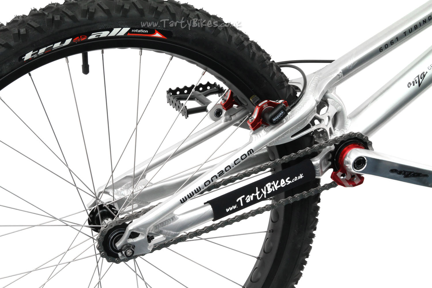

AdamR28 Posted April 9, 2014 Report Share Posted April 9, 2014 I'll try grab a couple tonight That'd be good One of the ones we built is this one: Lines up perfectly as you can see. Is it possible the gear ratio isn't 18:15? Slightly silly question but that's the only thing I can imagine causing an issue... Quote Link to comment Share on other sites More sharing options...
