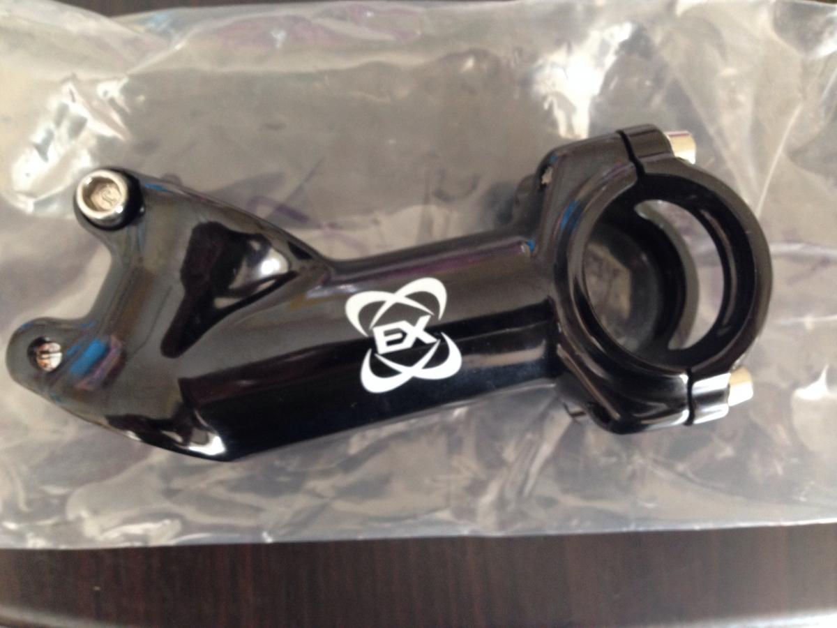

boozeman Posted August 5, 2014 Author Report Share Posted August 5, 2014 The new stem arrived today. Will be fitting it in a few mins. Hopefully will make the bike easier to ride. If it doesn't, what would people recommend? High rise bars? Quote Link to comment Share on other sites More sharing options...

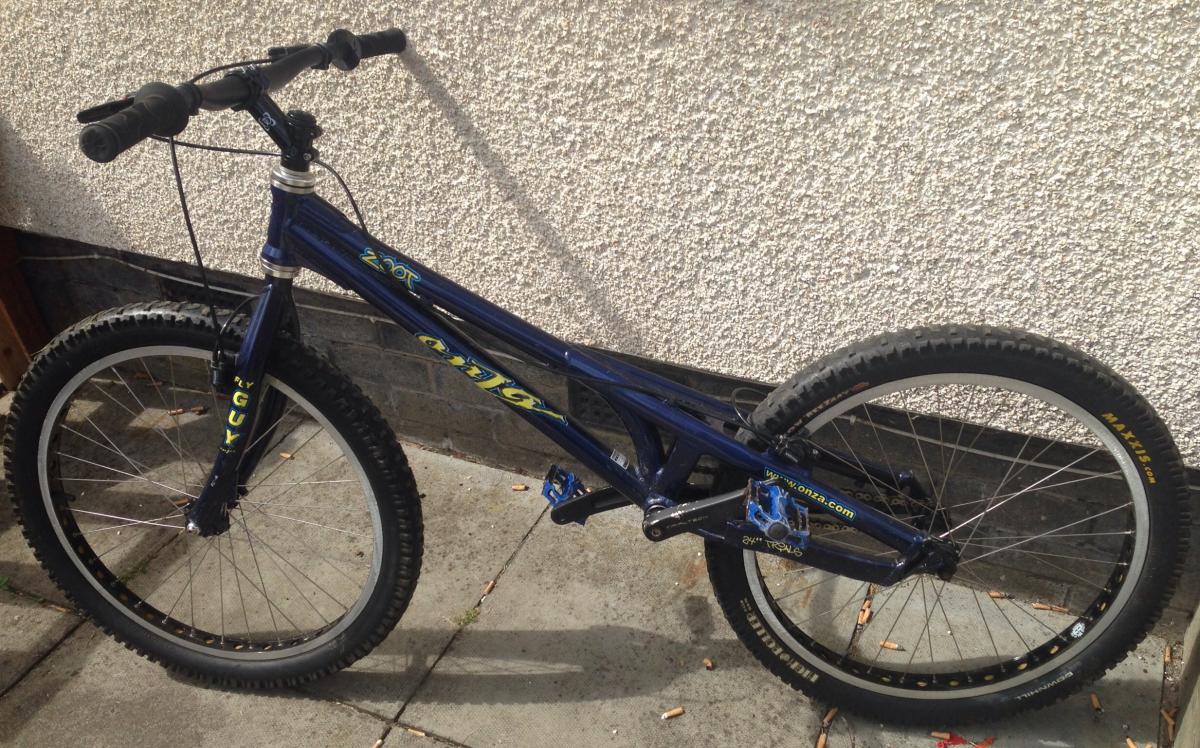

boozeman Posted August 5, 2014 Author Report Share Posted August 5, 2014 I think I have started on the hardest bike ever to ride. I can manage to get the bike up onto the rear easier and can even Get it on the front wheel and balance better. It's a step in the right direction Quote Link to comment Share on other sites More sharing options...
James281098 Posted August 6, 2014 Report Share Posted August 6, 2014 From looking at the picture if it was me I would roll the bars slightly forward and make sure the levers are angled down abit more, that could just be personal preference though Quote Link to comment Share on other sites More sharing options...
bing Posted August 6, 2014 Report Share Posted August 6, 2014 You need a longer stem on that, probably a 130x25 trialtech or something like that. Pretty sure the geo on them is the same as the first ever fourplay Quote Link to comment Share on other sites More sharing options...
boozeman Posted August 7, 2014 Author Report Share Posted August 7, 2014 You need a longer stem on that, probably a 130x25 trialtech or something like that. Pretty sure the geo on them is the same as the first ever fourplay Thats my next step, I'm going to give this a go first. From looking at the picture if it was me I would roll the bars slightly forward and make sure the levers are angled down abit more, that could just be personal preference though Just rolled them forwards a bit. hope that'll help. Quote Link to comment Share on other sites More sharing options...
boozeman Posted August 12, 2014 Author Report Share Posted August 12, 2014 Just been out for a good ride. The new stem has worked a treat. I can now get on and stay on the back wheel for longer. All I did was roll the bars forward 10degrees. Quote Link to comment Share on other sites More sharing options...
