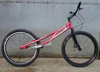

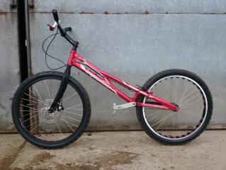

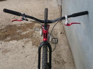

isitafox Posted March 26, 2014 Report Share Posted March 26, 2014 Right lads, after loads of messing about I've finally got my Inpulse built up. Still needs a few minor touches but for now it is (almost) rideable, will be coming to work tomorrow night to bleed the rear brake and then I'll be away! If anyone wants a full spec I'll write one up when I'm not on my phone! EDIT: Got some spacers made up for my Trialtech bottom bracket and fitted some new Trialtech Sport Lite forks, swapped the rear wheel for a TR hub with Trialtech SL rim and Echo SL FFW. Need to have a play with the wheel as I'm pretty sure the axle is bent but it doesn't worry me! 5 Quote Link to comment Share on other sites More sharing options...

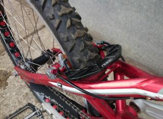

Neon-trials Posted March 26, 2014 Report Share Posted March 26, 2014 How's ur brake line up with the rim ? And what's ur chain tension like I always loved these frames ! My wife got me one for my bday but I had to return it because the brake mounts was about 15mm away from the rim I was super gutted ( Quote Link to comment Share on other sites More sharing options...
isitafox Posted March 26, 2014 Author Report Share Posted March 26, 2014 I got a half link which technically would have cured it but the small blocks on the adjusters still held the wheel miles too far back. Simple solution, I just unscrewed the block and filed them down 5mm. Now the chain tension is perfect and I've got a good bit of adjustment to work with, still might give 18-16 a try at some point though. Quote Link to comment Share on other sites More sharing options...
