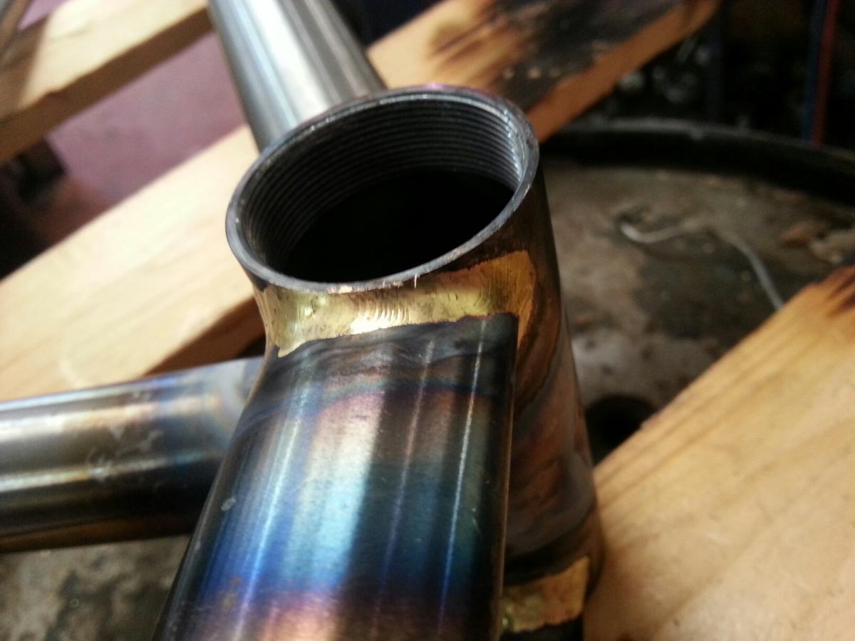

mike425 Posted August 9, 2014 Author Report Share Posted August 9, 2014 Thanks for all the positive comments, just getting ready to fully braze it as we speak. Geo is: 1090wb 380cs +50bb 71.5 headtube able Quote Link to comment Share on other sites More sharing options...

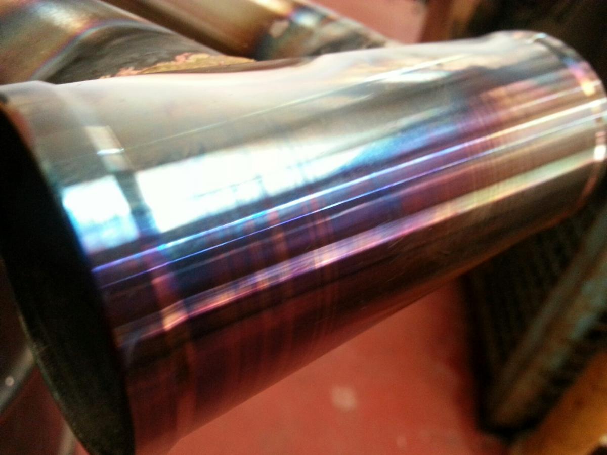

mike425 Posted August 9, 2014 Author Report Share Posted August 9, 2014 Couple of photos, only did half as I was shattered. 3 Quote Link to comment Share on other sites More sharing options...

eskimo Posted August 9, 2014 Report Share Posted August 9, 2014 Looking tidy. What you doing about the bb? Quote Link to comment Share on other sites More sharing options...

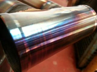

MartMini Posted August 9, 2014 Report Share Posted August 9, 2014 Looking tidy. What you doing about the bb? If you click on the first picture, you can see its threaded? Quote Link to comment Share on other sites More sharing options...
mike425 Posted August 9, 2014 Author Report Share Posted August 9, 2014 Thanks for all the positive comments so far. There are a couple of bits I am already not happy with design wise, but this is the beauty of building your own, there is always something to change on future builds! I am going to fabricate some steel plate chainstay protectors and incorporate them into a reinforcing bridge so they all look slick. I built this frame around an old pair of middleburn square taper cranks. This meant I could try something with a 100mm bb, I basically have massive tyre clearance but the chainstays are dead straight so the rear should be mega stiff. This would limit future ISIS cranks but it was something I really wanted to try. Quote Link to comment Share on other sites More sharing options...
