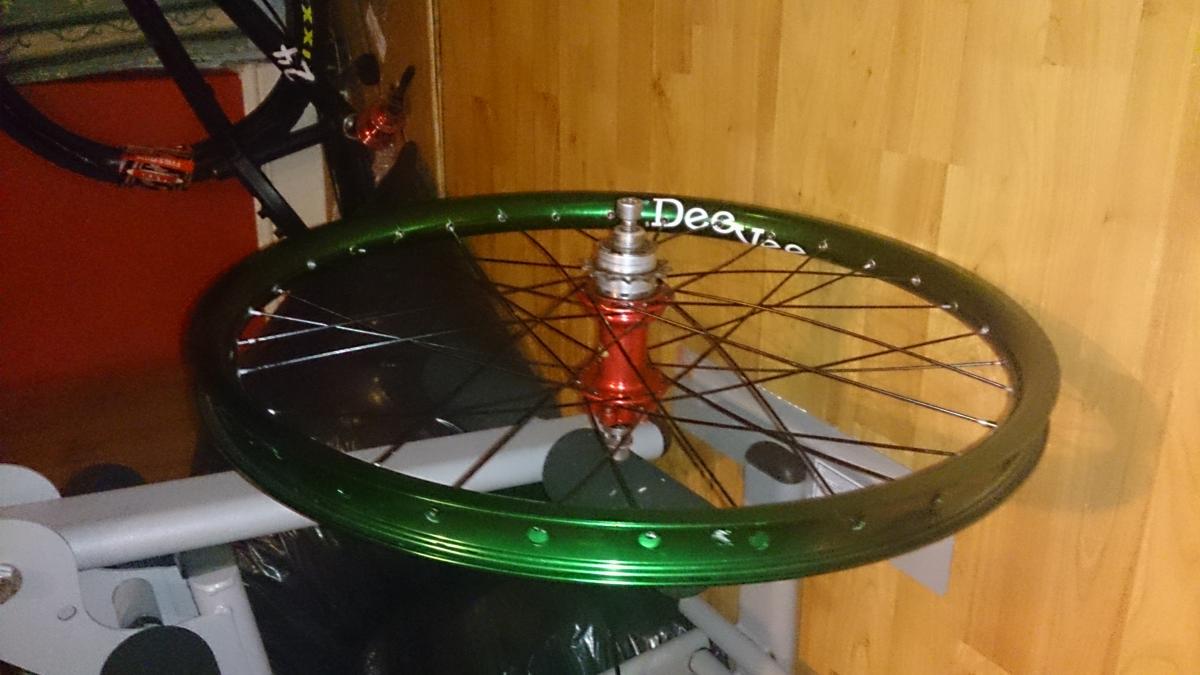

HippY Posted April 3, 2014 Author Report Share Posted April 3, 2014 Well, little update the 2nd rim and the red disc bolts are on the post in Germany, should be with me next week I am going to change the front sprocket tomorrow at the bike shop, I do not have a vice I will make an order for a BB and a lockring tool (although I will ask how much would it cost to install BB and change rear sprocket) I laced up the rear wheel! It is beautiful, needs to put in some work, as there is only the first 3 turn tension in it, so I will spend the rest of the night sorting that out, but god damn it, the wheel is beautiful... hopefully the front wheel will look good with the pinkish hub pictures 3 Quote Link to comment Share on other sites More sharing options...

HippY Posted April 5, 2014 Author Report Share Posted April 5, 2014 little update: the guys wanted to charge me £20 for inserting the BB, changin the rear sprocket and front sprocket, so I will do the front sprocket as I cannot do it myself and just buy a BB tool. When I took the pictures I laced half of the spokes wrong, as on the rim there is eyeleted holes for the right and left side, but I laced it other way around... after several hours of re-lacing and some basic tensioning it seems really stiff, although the spokes seems to flex a little when I push together so I might them them a little bit more, as I will run a disc on it. ohh and after FFW it is so strange, that the loud Pro2 hub got even louder, thanks the wheel just amplify the sound Rim is in GB, should be with me by around Wednesday Quote Link to comment Share on other sites More sharing options...

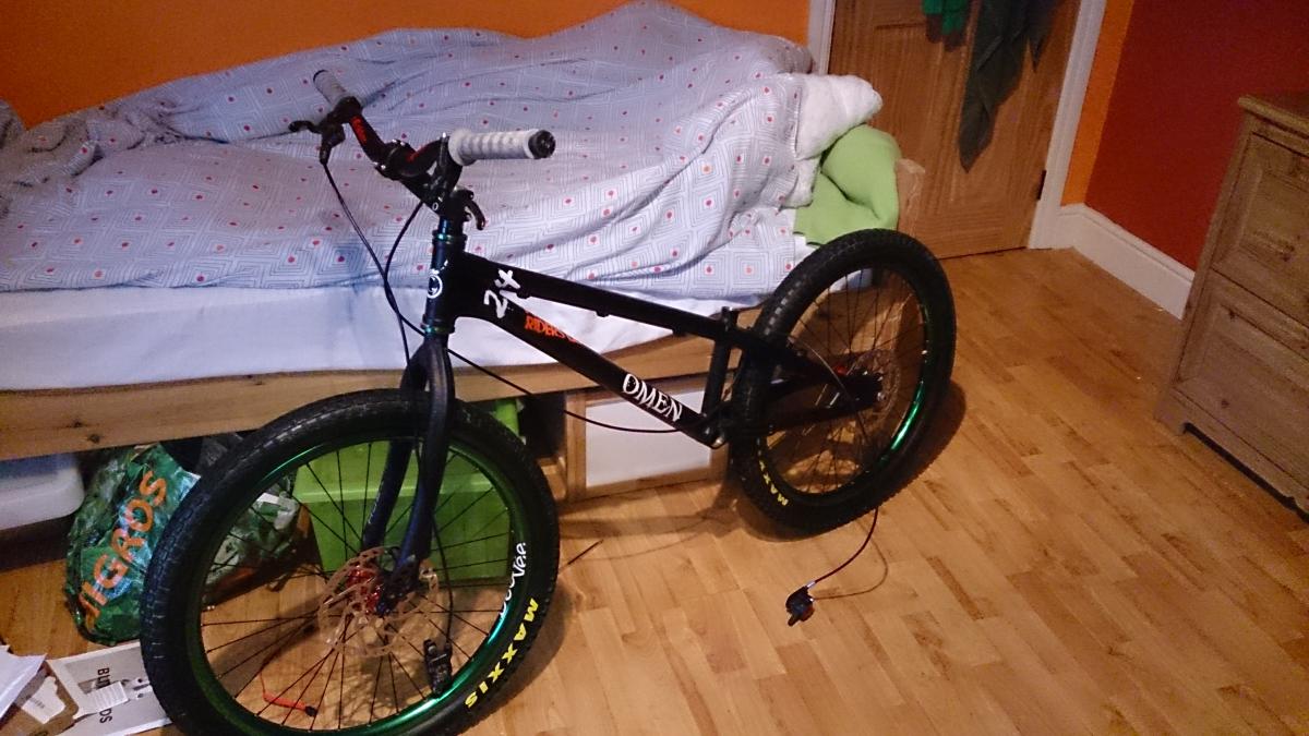

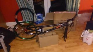

HippY Posted April 9, 2014 Author Report Share Posted April 9, 2014 Little update: All parts should arrive tomorrow, and the final assembly will be on Friday Wheels are done, although they move up and down a little bit, but they the spokes are tight Brakes needs sorted And saw it for the first time with wheels. so beautiful, but raised some eyebrows, as basically it is nothing like my previous bike. I wait with the final decision until the first ride:) pics will follow Quote Link to comment Share on other sites More sharing options...
marshole82 Posted April 9, 2014 Report Share Posted April 9, 2014 You need to get rid of those eggs in the wheels mate. If the egg is away from the hub then you need to tighten the egged part and loosen around it, opposite if the egg is a dip into the rim. 1 Quote Link to comment Share on other sites More sharing options...

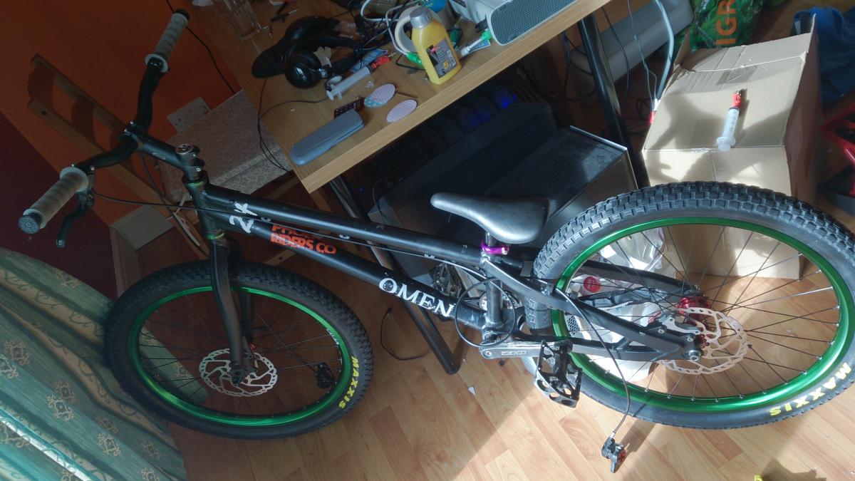

HippY Posted April 11, 2014 Author Report Share Posted April 11, 2014 Yess, it looks like a bike now! Things to sort: Inserting heaset cups (Seabass, please reply me) My archenemies, the brakes needs sorted: First, Avid juicy 3 pistons sticking, I cannot pull them back Rear: adapter needs modified and spaced, it seemed like there was a small leak from the lever.... Chain needs to be waaaay shorter and installed Rear sprocket needs changed Just a question from you: I am looking for a new set of brakes. It is important to be new, should be cheapish, so like £90 max, but lower is better I am not looking for a super high end M810 set, as I dont have the money, neither the abilities to use that power, I am 100% sure I am looking at Elixir 5/7, as on new Inspired Fourplay, Zee maybe, Schimano 2 pots.. mainly them 4 Quote Link to comment Share on other sites More sharing options...
