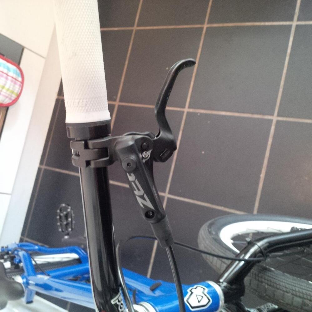

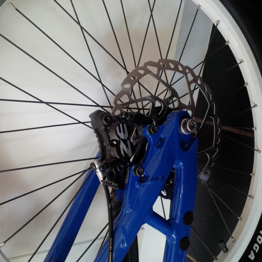

Yes I saw that, apparently the saint is a bling version of the vee. I have just left my lbs with a nice new set of vee's so will put them on tomorrow and post pics. I've also bought some new vee discs as the ice tech feel very flimsy to me, I may be wrong but they're contaminated anyway and thought I'd try the vee discs to compare. Thanks everyone for input
Zees, bloody auto correct on phone...
on maggies you do not need to rebleed at hose shortening, as vaccum keeps the oil in the system, not sure how it works at discs...
Is it that long? Personally I do not shorten my hoses, as less place to make a fault, and at 24 it handy for framespins and handlebar spins
