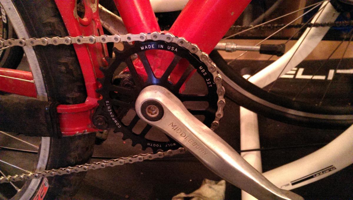

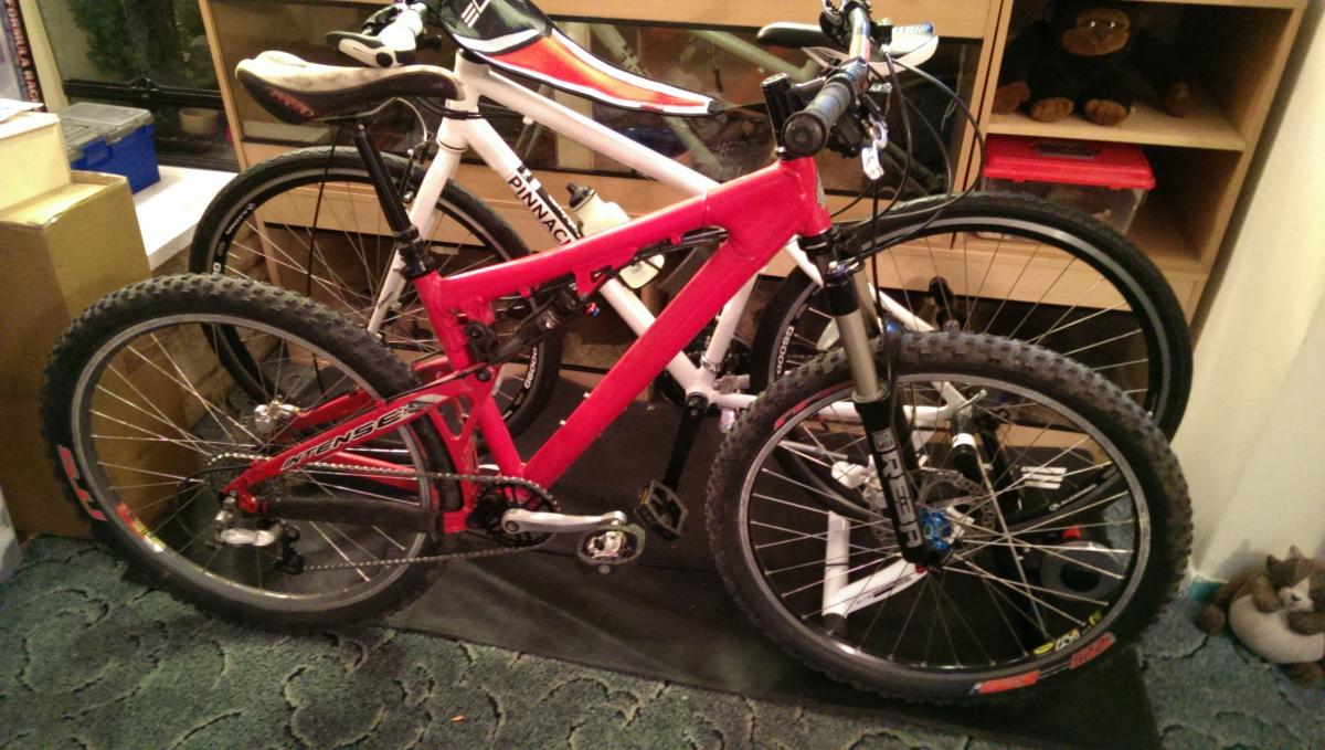

forteh Posted May 28, 2014 Report Share Posted May 28, 2014 My dropstop ring arrived from wolf tooth today, it's a lovely bit of kit, really well made and fits a treat. By ditching the middleburn spider, blackspire ring and mrp system1 chain guide the bike has shed best part of a pound! Should be about 28.7 pounds now 1 Quote Link to comment Share on other sites More sharing options...

ZeroMatt Posted May 28, 2014 Report Share Posted May 28, 2014 My dropstop ring arrived from wolf tooth today, it's a lovely bit of kit, really well made and fits a treat. By ditching the middleburn spider, blackspire ring and mrp system1 chain guide the bike has shed best part of a pound! Should be about 28.7 pounds now IMAG0308_BURST002.jpgIMAG0309.jpg How are you finding the chain line with the x-type offset ring on isis/sq taper arms? Quote Link to comment Share on other sites More sharing options...
forteh Posted May 28, 2014 Report Share Posted May 28, 2014 (edited) How are you finding the chain line with the x-type offset ring on isis/sq taper arms? The chainline is actually a fair bit better than it was before :$ Before it was where ever the middle ring was on the 110mm xc spider (the mrp took up the outside ring position) and that put the chainline about straight on 6-7 on the block. I guess it's probably about 10mm inboard now and sitting straight on 3-4ish which is where more torque is put in. When I first got it out the packet I was a bit suprised by the amount of dish but it's worked out really well. For reference I'm using a 121mm x73 hope ti square taper bb in a 68mm shell so the drive side cup sticks out a bit further than intended but it works fine. The inside face of the cranks are within 1-2mm of the BB cups, looks like an external set up edit: weighed the bike today, 13.067kg - 28.75lbs - not bad I don't think for an elderly intense 5.5 Edited May 30, 2014 by forteh Quote Link to comment Share on other sites More sharing options...
