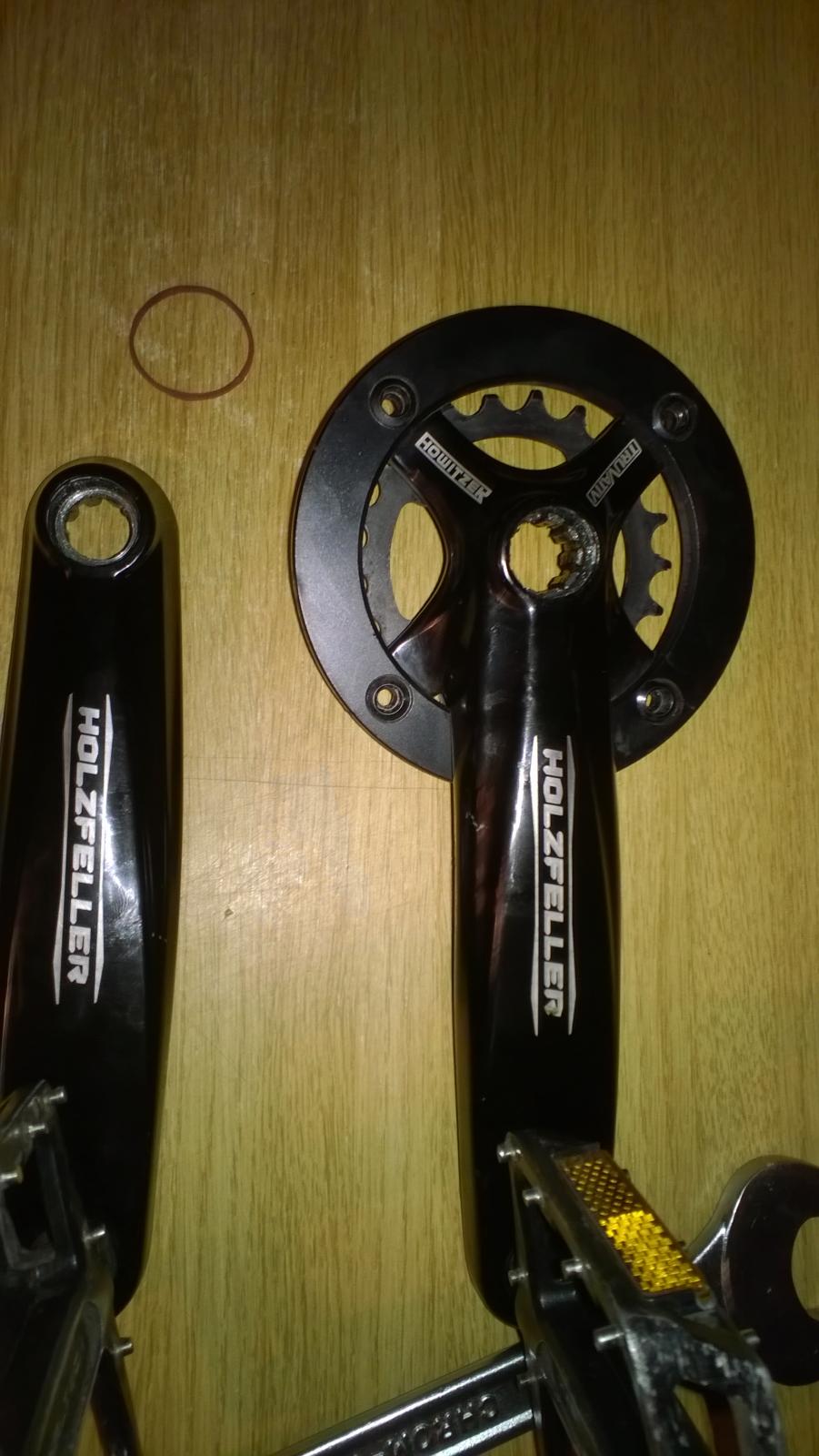

bing Posted January 28, 2014 Report Share Posted January 28, 2014 (edited) Put a picture of your cranks up, then we can find the right bb for you. Chances are it's this one Edited January 28, 2014 by bing Quote Link to comment Share on other sites More sharing options...
psiron Posted January 28, 2014 Author Report Share Posted January 28, 2014 That's the same as the one i took out. What i find a bit strange is, 1 tarty bikes don't offer the above as a direct replacement, 2 the only one i could find with any reference to a fourplay was in reply to a question posted on the Trialtech sport light description, guess which one i ordered. Quote Link to comment Share on other sites More sharing options...

bing Posted January 28, 2014 Report Share Posted January 28, 2014 You need 2 spacers on the drive side, one on the none drive side. I don't understand why it won't work, as that's the bb designed to go with those cranks. Have you got the axle in the right way? Quote Link to comment Share on other sites More sharing options...
psiron Posted January 28, 2014 Author Report Share Posted January 28, 2014 The axle on the trialtech measures 128mm and the howitzer 150mm Quote Link to comment Share on other sites More sharing options...
err Posted January 28, 2014 Report Share Posted January 28, 2014 From what Dan (bing) is saying the holzfellers use a unique spline size so won't be compatible with the trialtech bb (which uses isis splines) Quote Link to comment Share on other sites More sharing options...
bing Posted January 28, 2014 Report Share Posted January 28, 2014 Only the howitzer bb will work with those cranks, and give the correct offset/clearance Quote Link to comment Share on other sites More sharing options...
AdamR28 Posted January 29, 2014 Report Share Posted January 29, 2014 The Trialtech BB does fit the Fourplay frame, however the cranks you have aren't compatible with the BB. It is ISIS and the cranks use their own spline. The reason we don't stock the BBs separately is two fold - they never break, and other places listed them at silly prices cos they can get OE stock. Quote Link to comment Share on other sites More sharing options...
