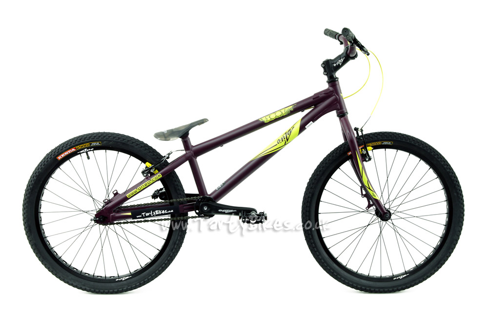

HippY Posted January 26, 2014 Author Report Share Posted January 26, 2014 (edited) it is not priority, I mean the alienation rim is out of choice, as I want good quality rims, but I am looking for some coloured options, as it is not essential, but preferable for example http://www.trials-forum.co.uk/topic/173944-zoot-finally-ready-new-pics-added/?hl=spank vs http://www.tartybikes.co.uk/images/custom/bikes24/large_onzazoot2013.jpg For me personally the coloured rim version looks better somehow, and of course, I would not spend £100 on 2 rims and if I cannot find a coloured rim at reasonable price at goof quality, then the DMR will be my choice! And a question as it could make my choice easier: How hard is it to paint a wheel? JD did that if I remember well, I would look for somekind of metallic colour Edited January 26, 2014 by UKHippY Quote Link to comment Share on other sites More sharing options...
