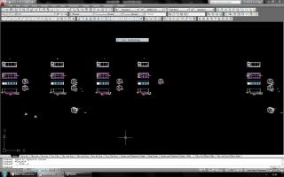

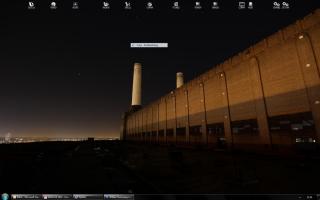

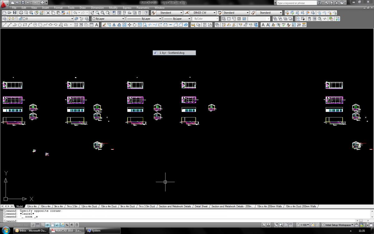

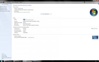

stoozie Posted January 9, 2014 Report Share Posted January 9, 2014 I've been having a problem with my PC for a while now, and just wondered if anyone on here would know what's going on. Occasionally when using AutoCAD 2010 or Photoshop CS3 some of the menus leave an imprint on the screen that only go away by logging off and logging back on again, or restarting the computer. This can be annoying at times when doing work having to save everything and then get back to where I was. If anyone has any idea it would be appreciated! I've attached some print screens below and also my system specification if that helps Quote Link to comment Share on other sites More sharing options...

stoozie Posted January 16, 2014 Author Report Share Posted January 16, 2014 No luck, driver has been uninstalled and re-installed twice now and this still happens Quote Link to comment Share on other sites More sharing options...
Azarathal Posted January 16, 2014 Report Share Posted January 16, 2014 How olds the screen? Although it sounds software related its a possibility. Any changes to the pc before it happened? Updated program/driver/windows update etc Quote Link to comment Share on other sites More sharing options...
Muel Posted January 17, 2014 Report Share Posted January 17, 2014 I've seen windows do this before, only reinstalling it fixed it. Quote Link to comment Share on other sites More sharing options...
