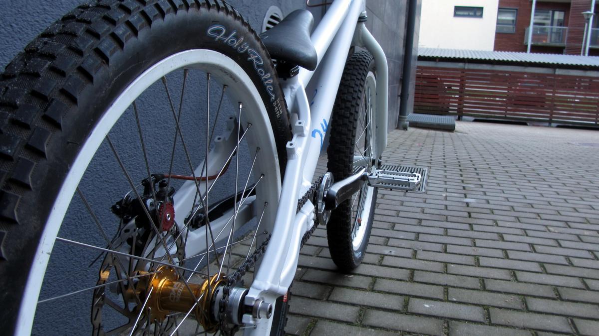

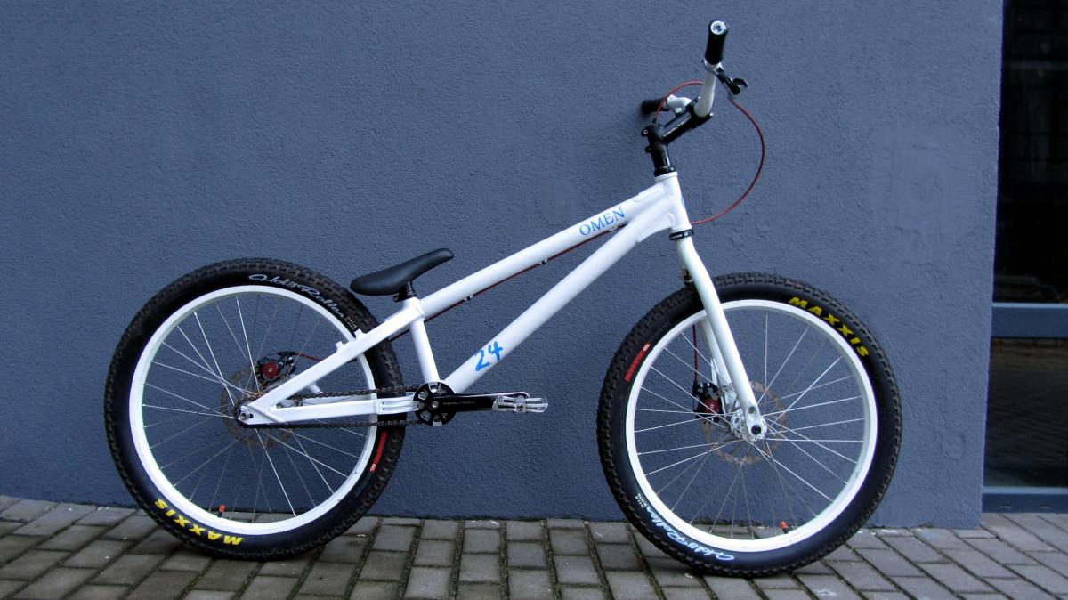

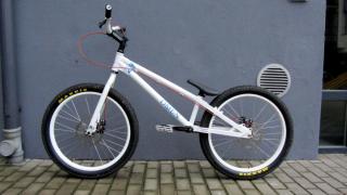

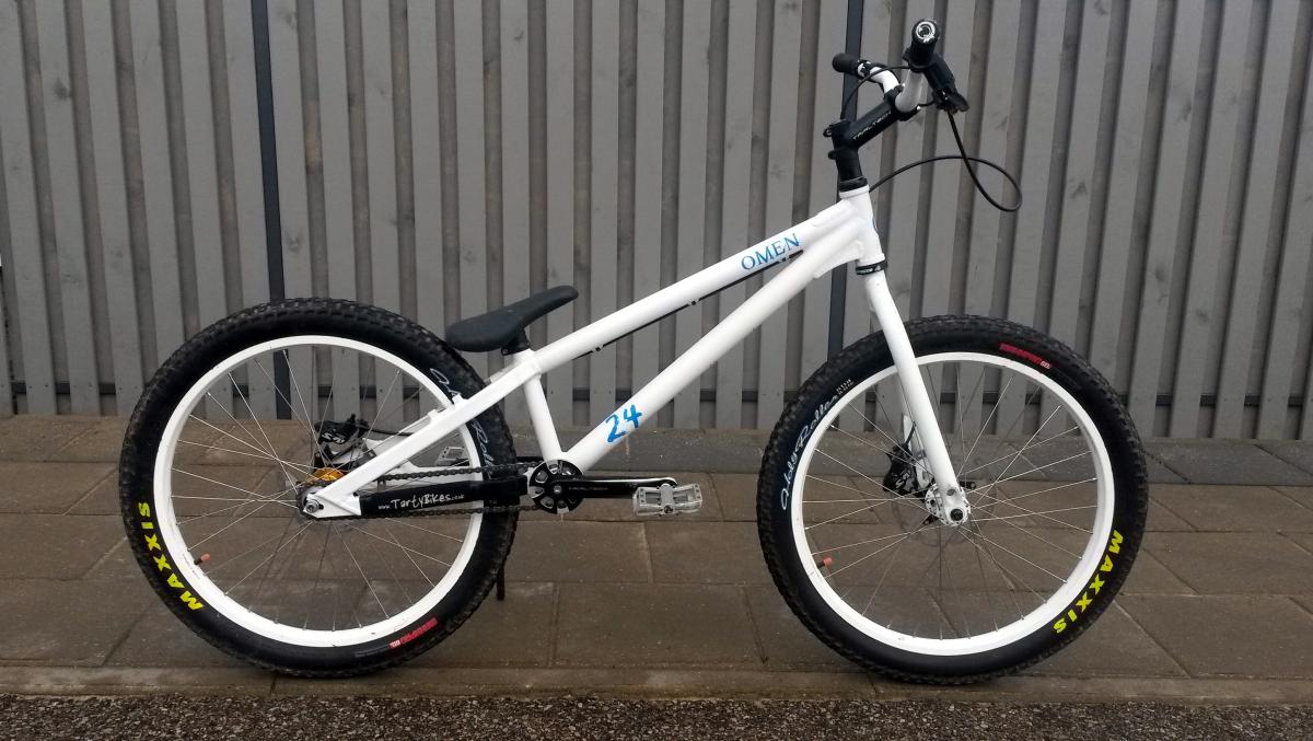

Petras Posted December 12, 2013 Report Share Posted December 12, 2013 (edited) Specs: Frame and Fork - Frame: OMEN TwentyFour - Forks: Inspired Team 2011 Wheels - Front hub: Trialtech Race Sealed Disc - Rear hub: Hope Pro 2 Evo Trials, 32h - Cassette Lockring: Pro-Bolt Alloy Lockring - Front rim: Trialtech Sport, 24" - Rear rim: Trialtech Sport, 24" - Spokes: Sapim/Halo - Inner tubes: Maxxis - Tyres: Maxxis Holy Roller 24 x 2.4" Brakes - Front brake: Avid BB7 180mm Disc - Rear brake: Avid BB7 180mm Disc - Brake levers: Avid FR5 Drivetrain - Cranks: Trialtech Sport Forged - Front Sprocket: Trialtech Sport Screw On, 18T - Chain: KMC Z610 - Rear Sprocket: Trialtech Sport Splined, 14T - Pedals: Nekeproof Neutron - Bottom bracket: Rockman OEM ISIS - Bashring: OMEN Seating - Saddle: Dartmoor - Lite Combo - Seat Clamp: Promax Steering - Headset: FSA Pig, 1-1/8" - Stem: Trialtech Race Welded - Grips: OMEN lock-On - Handlebar: Inspired Riser Geometry - Wheelbase: 1028mm - Chainstay: 383mm - BB Height: +30mm - Head Angle: 73˚ Edited February 23, 2014 by Petras 1 Quote Link to comment Share on other sites More sharing options...
AkuskaUK Posted December 27, 2013 Report Share Posted December 27, 2013 LOVE IT! One of the best looking 24s out there Quote Link to comment Share on other sites More sharing options...
Petras Posted December 27, 2013 Author Report Share Posted December 27, 2013 Thanks, Mate! Quote Link to comment Share on other sites More sharing options...

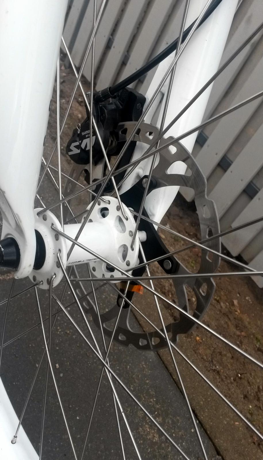

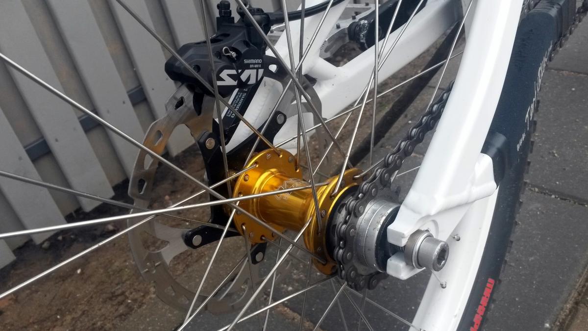

Petras Posted February 23, 2014 Author Report Share Posted February 23, 2014 (edited) UPDATE: Shimano Saint M810 brakes Shimano RT76 rotors Edited February 23, 2014 by Petras Quote Link to comment Share on other sites More sharing options...
Petras Posted February 23, 2014 Author Report Share Posted February 23, 2014 (edited) Now I can say that's my dream bike Edited February 17, 2016 by Petras 1 Quote Link to comment Share on other sites More sharing options...
HippY Posted February 23, 2014 Report Share Posted February 23, 2014 yesss, yess, oh yess How are the brakes? where did you got them? do you still like it? Quote Link to comment Share on other sites More sharing options...
Petras Posted February 23, 2014 Author Report Share Posted February 23, 2014 Well what i can say about these brakes...AMAZING, g-turn now feels 200% better. I bought them from CRC and Wiggle Quote Link to comment Share on other sites More sharing options...

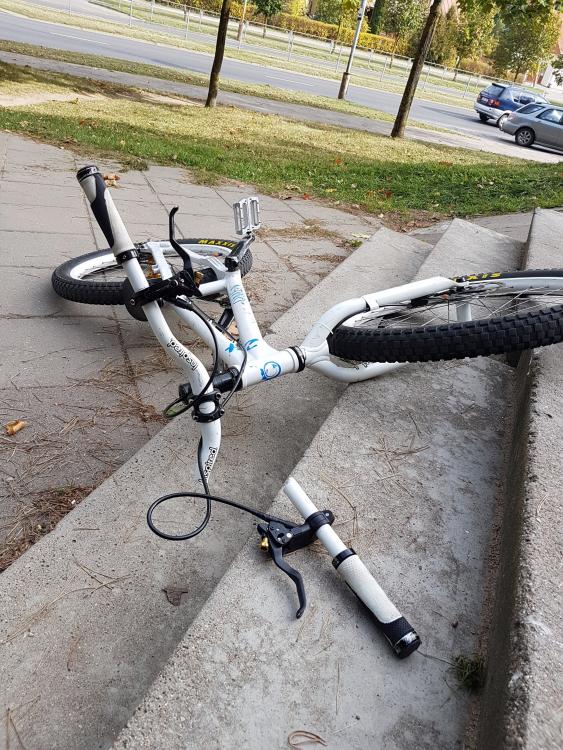

Petras Posted September 23, 2016 Author Report Share Posted September 23, 2016 (edited) Inspired..yeah Edited September 23, 2016 by Petras Quote Link to comment Share on other sites More sharing options...
AdamR28 Posted September 23, 2016 Report Share Posted September 23, 2016 Bugger... But, the handlebars are nearly 3 years old? Quote Link to comment Share on other sites More sharing options...
Petras Posted September 23, 2016 Author Report Share Posted September 23, 2016 13 minutes ago, Adam@TartyBikes said: Bugger... But, the handlebars are nearly 3 years old? Yes, about 3 years ago I bought it from your shop. Such a good handlebars :(, too bad they snapped. Probably it was time for it because I ride quite a lot. Quote Link to comment Share on other sites More sharing options...
Paperclip Posted September 23, 2016 Report Share Posted September 23, 2016 (edited) 16 minutes ago, Adam@TartyBikes said: Bugger... But, the handlebars are nearly 3 years old? Hahaha reminded me of this. Edited September 23, 2016 by Paperclip 1 Quote Link to comment Share on other sites More sharing options...
Christiaan Posted September 23, 2016 Report Share Posted September 23, 2016 Haha 3 years isn't bad at all. All bars will brake sooner or later. Quote Link to comment Share on other sites More sharing options...
Petras Posted September 23, 2016 Author Report Share Posted September 23, 2016 4 minutes ago, Christiaan said: Haha 3 years isn't bad at all. All bars will brake sooner or later. Sad reality :'(. Companies should write: will broke in 2-3 years Quote Link to comment Share on other sites More sharing options...
Christiaan Posted September 23, 2016 Report Share Posted September 23, 2016 Good excuse to update your front-end a little. Shorter stem and high rise bars will make a huge difference Quote Link to comment Share on other sites More sharing options...
Petras Posted September 23, 2016 Author Report Share Posted September 23, 2016 Just now, Christiaan said: Good excuse to update your front-end a little. Shorter stem and high rise bars will make a huge difference Hmm maybe you are right Quote Link to comment Share on other sites More sharing options...

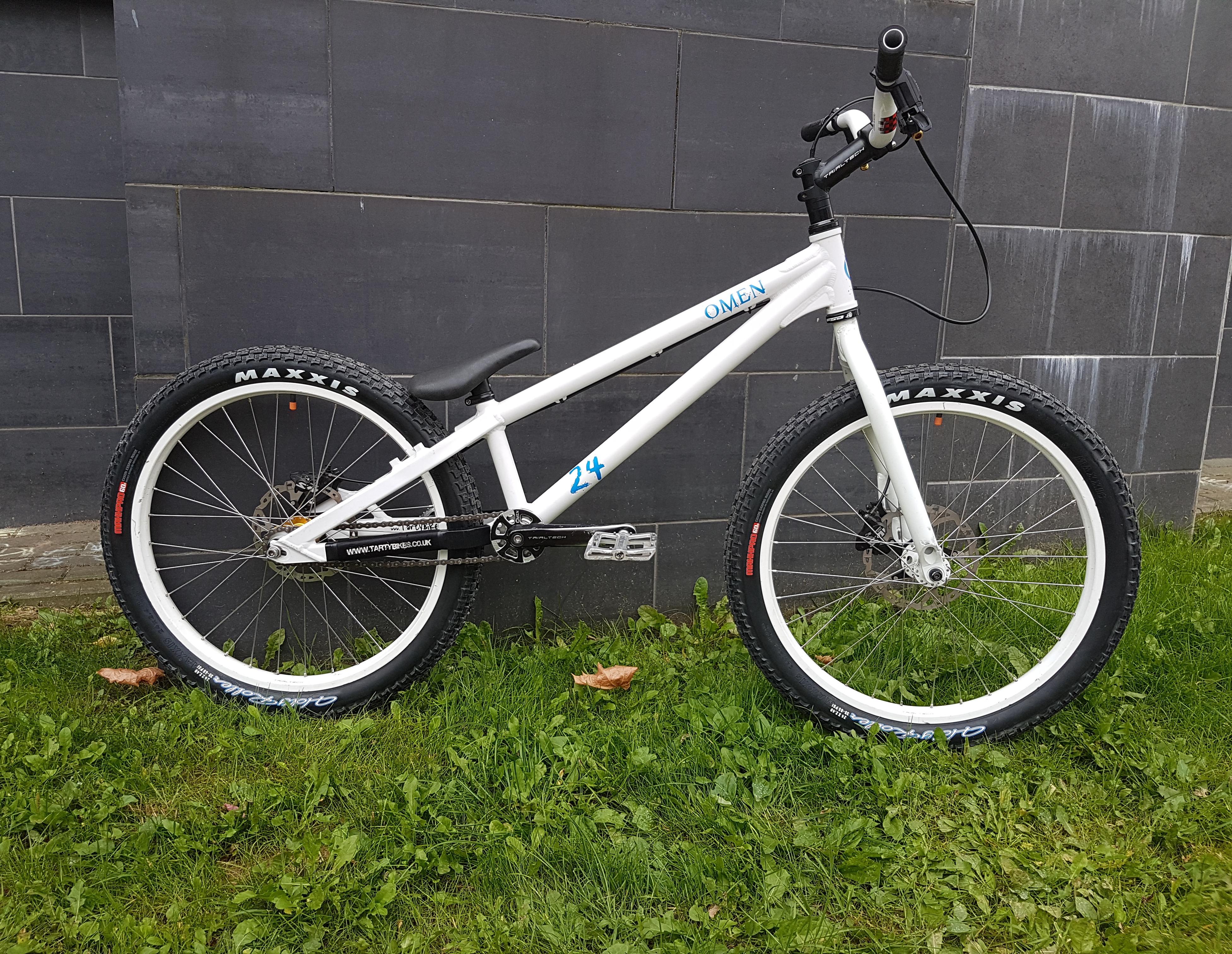

Scott Gibbs Posted September 23, 2016 Report Share Posted September 23, 2016 After riding Simon's omen I really like the way they ride despite his bizarre set up! Bike looks sick dude. Quote Link to comment Share on other sites More sharing options...
Petras Posted September 23, 2016 Author Report Share Posted September 23, 2016 (edited) 5 hours ago, Scott Gibbs said: After riding Simon's omen I really like the way they ride despite his bizarre set up! Bike looks sick dude. Good to hear, that you like it Edited September 23, 2016 by Petras 1 Quote Link to comment Share on other sites More sharing options...

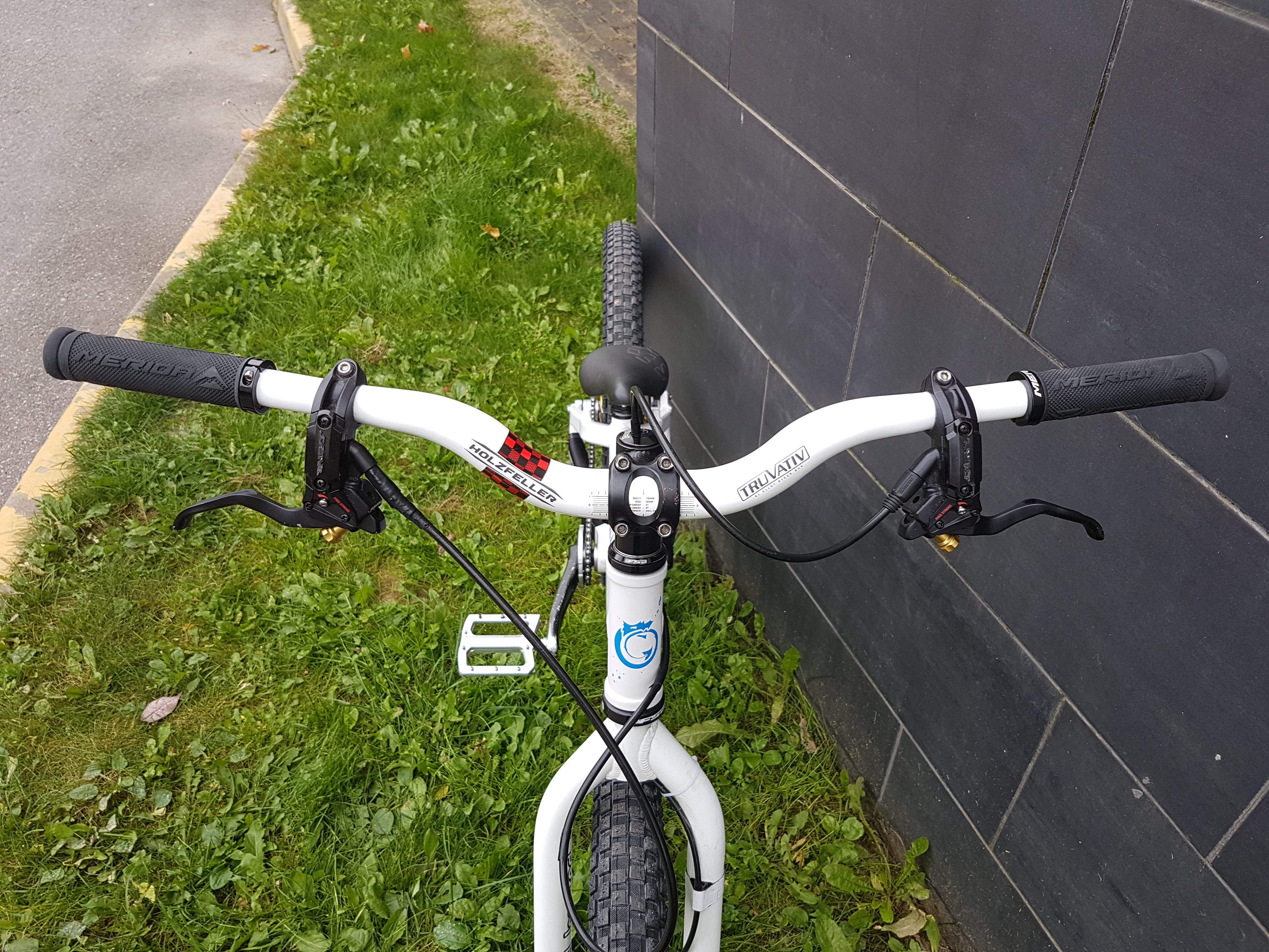

Petras Posted September 28, 2016 Author Report Share Posted September 28, 2016 (edited) Went to local bike shop and grabbed a pair of new tyres and Truvativ Holzfeller bars Edited September 28, 2016 by Petras 1 Quote Link to comment Share on other sites More sharing options...

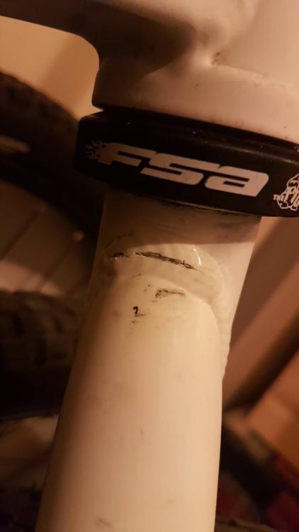

Petras Posted October 16, 2016 Author Report Share Posted October 16, 2016 well, my third fork :| 1 Quote Link to comment Share on other sites More sharing options...
NINJА Posted October 16, 2016 Report Share Posted October 16, 2016 Expensive parts are bombproof only in one case: if you are not riding. Quote Link to comment Share on other sites More sharing options...
AdamR28 Posted October 18, 2016 Report Share Posted October 18, 2016 Forks are how old? Quote Link to comment Share on other sites More sharing options...
Petras Posted October 18, 2016 Author Report Share Posted October 18, 2016 2 hours ago, Adam@TartyBikes said: Forks are how old? I bought it 4 years ago and actual riding was almost 2 years. Maybe it happens for all of you guys. I will try to weld it, do you think it is a good idea? Quote Link to comment Share on other sites More sharing options...
