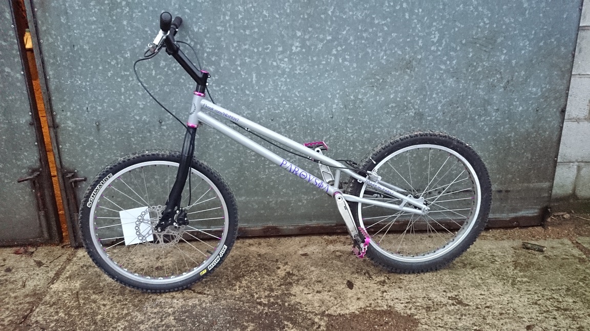

isitafox Posted December 12, 2013 Report Share Posted December 12, 2013 Got my forks and stem re-anodised in black, got a new front tyre and got a single carbon headset spacer to tidy the front end up a bit. Just awaiting some bits for my new brake and then I'll be switching the MT2 for a Trial Zone. Quote Link to comment Share on other sites More sharing options...

Blake Posted December 12, 2013 Report Share Posted December 12, 2013 Is this a 24? Looks nice man Quote Link to comment Share on other sites More sharing options...
isitafox Posted December 12, 2013 Author Report Share Posted December 12, 2013 Yup, almost an Echo 24 but the headangle is 73° to stretch the reach to 665 and the head tube is 5mm longer Quote Link to comment Share on other sites More sharing options...
i like cunning stunts Posted December 12, 2013 Report Share Posted December 12, 2013 Nicest marino ive seen to date is he still using that awful 'tensioner' system? Also whats the stem? Quote Link to comment Share on other sites More sharing options...
FamilyBiker Posted December 12, 2013 Report Share Posted December 12, 2013 (edited) whats the geo of that stem? seeing how high your setup is i´d like to see a vid from you on that bike again,to check your stance on this bike. maybe the steepy stems arent too bad... Edited December 12, 2013 by FamilyBiker Quote Link to comment Share on other sites More sharing options...
isitafox Posted December 12, 2013 Author Report Share Posted December 12, 2013 Stem is a Trialtech 150mm x 30°, tensioner is a bolt one through the dropout. It's a bit tight to get at but I prefer it to cams. FamilyBiker, my GET2 vid was done on the exact same setup though I'll hopefully have a quick play this weekend if it's dry so will get the camera out! Quote Link to comment Share on other sites More sharing options...
FamilyBiker Posted December 12, 2013 Report Share Posted December 12, 2013 (edited) haha, watched it as you replied.you seem to be a few inches taller than me,so... damn,i cant find a stem that could improve my setup,seems like i´ll have to keep the one i have and get better(or die trying lol) atm i have custom handlebars in the making,theyre with horizontal backsweep and no upsweep in rolled forward position. on topic:do you think the steepened ht angle improved your geo from an echo? Edited December 12, 2013 by FamilyBiker Quote Link to comment Share on other sites More sharing options...
isitafox Posted December 12, 2013 Author Report Share Posted December 12, 2013 Yes cause it stretched the reach meaning I didn't need to run a 165 mod stem like everyone else seems to do. I was tempted to try a Trialtech high rise stock stem (can't remember the geo off the top of my head) but I didn't want to waste my money if it didn't work. Quote Link to comment Share on other sites More sharing options...
Jake. Posted December 12, 2013 Report Share Posted December 12, 2013 Thought it was a very good photoshop at first! Looks good Dave Quote Link to comment Share on other sites More sharing options...
