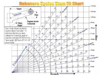

James281098 Posted December 13, 2013 Author Report Share Posted December 13, 2013 Thanks guys for all help! I have one other question abit off topic and thought I'd post in here instead of starting a new topic, I was talking to mark about stem choices and he said the shorter the stem is the "poppier" your bike is... (In his own words haha) .I had a 110x35bbb and now have a truvative 80x7 and it feels quite good, I am thinking about buying a hope 75x25 will this feel a lot different to what I have now? Thanks james Quote Link to comment Share on other sites More sharing options...
isitafox Posted December 13, 2013 Report Share Posted December 13, 2013 Yes, the extra height alone will make a difference. If you're not sure I have an Onza stem that's 70 x 25° you could have cheap?? Quote Link to comment Share on other sites More sharing options...
James281098 Posted December 13, 2013 Author Report Share Posted December 13, 2013 I would usually snap that offer up but I can't as I'm on a budget for a stem and brake but thanks for the offer. Would this make the bars feel a lot closer to me or not so much? I know that there would be a fairly big increase in rise but not to sure on if it would feel to close to me? If you get what I mean? Aha Quote Link to comment Share on other sites More sharing options...
isitafox Posted December 13, 2013 Report Share Posted December 13, 2013 Behold the almighty stem geometry chart, it will serve you well! Quote Link to comment Share on other sites More sharing options...
James281098 Posted December 13, 2013 Author Report Share Posted December 13, 2013 Haha thanks Quote Link to comment Share on other sites More sharing options...
