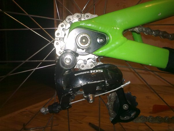

ТrialsRider Posted November 16, 2013 Report Share Posted November 16, 2013 How is it strong in comparison with usual tensioners? Quote Link to comment Share on other sites More sharing options...
valk Posted November 16, 2013 Report Share Posted November 16, 2013 Unnecessarily heavy; looks like you can hit it in anything and it'll break. Quote Link to comment Share on other sites More sharing options...
dk2 Posted November 16, 2013 Report Share Posted November 16, 2013 Its strong enough for tension, but bends/breaks easy and hangs fairly low.... Quote Link to comment Share on other sites More sharing options...
sideburns(dnt ask) Posted November 16, 2013 Report Share Posted November 16, 2013 Much better off just running a chain tensioner imo. So many anoying little things that can bugger up. That said I always did like the look of rear mechs on trials bikes Quote Link to comment Share on other sites More sharing options...
dngr2self Posted November 16, 2013 Report Share Posted November 16, 2013 Much better off just running a chain tensioner imo. So many anoying little things that can bugger up. He's running 2 sprockets though otherwise I would agree. Quote Link to comment Share on other sites More sharing options...
isitafox Posted November 16, 2013 Report Share Posted November 16, 2013 In that case a normal sprung tensioner like a Trialtech would actually be easier to switch between gears with Quote Link to comment Share on other sites More sharing options...
old boy chez Posted November 17, 2013 Report Share Posted November 17, 2013 No it's not a bad idear I have run bikes like this for years and never had a prob. Yes it is heavier but I still think they work better then some tensioner's. Quote Link to comment Share on other sites More sharing options...
dngr2self Posted November 17, 2013 Report Share Posted November 17, 2013 In that case a normal sprung tensioner like a Trialtech would actually be easier to switch between gears with Would it be wide enough to run two gears though? Quote Link to comment Share on other sites More sharing options...
isitafox Posted November 17, 2013 Report Share Posted November 17, 2013 Yeah the bar that you use to centralise the sprockets is long enough if memory serves me right. Quote Link to comment Share on other sites More sharing options...
LEON Posted November 17, 2013 Report Share Posted November 17, 2013 Yeah the bar that you use to centralise the sprockets is long enough if memory serves me right. I did this for a while, a Trialtech tensioner works fine & has enough adjustment on the pin to have a fat chain on 2 different sprockets. Takes 30 secs to change the gear with a 4mm allen key. Quote Link to comment Share on other sites More sharing options...
Vivian-Trial Posted November 19, 2013 Report Share Posted November 19, 2013 It wasn't a bad idea around 10 years ago. Viv Quote Link to comment Share on other sites More sharing options...
