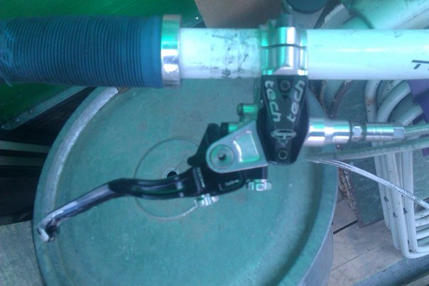

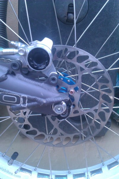

ТrialsRider Posted November 11, 2013 Author Report Share Posted November 11, 2013 Oh, it's clear now, #3 on tartys. Thanks. But I want to buy some used Rear 160mm 2012 Hope brake stainless hose (tech mono trial?) Will it fit to my frame with 180 mm rotor? Here is the pictures: Quote Link to comment Share on other sites More sharing options...
Mark W Posted November 11, 2013 Report Share Posted November 11, 2013 That caliper would work on your Fourplay frame with a 180mm rotor. Quote Link to comment Share on other sites More sharing options...
