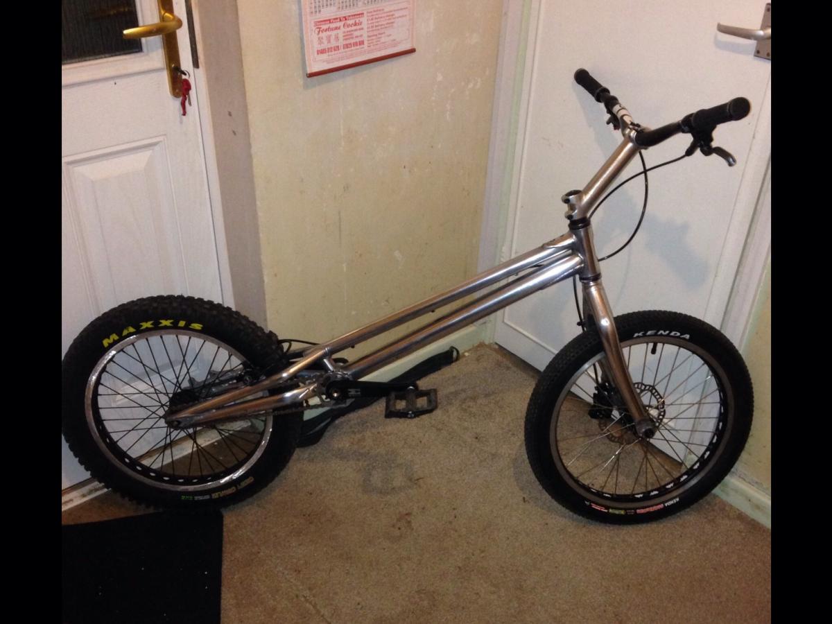

bing Posted November 10, 2013 Report Share Posted November 10, 2013 (edited) So all the crap before about getting a stock turned out to be a load of old shit, I couldn't ride it for toffee nor did I have any confidence in riding. So the only way for me to get it back was to go back to mod. I was planning to build another 09 onza blade, but then this came up. The geo is perfect for me, it rides so much better than my old onza blade. Miles more stable on the back wheel, so easy to get on the back wheel. It's the combination of long ish wheelbase for a mod, and what feels to me quite a long reach. For those that are interested, its 1020wb, +80bb, 350cs and 72ha. Spec is 2011 echo lite frame with echo press fit bb, fly bikes bearings neon forks Viz pro700 bars, inspired lock on grips Onza forged stem Rear 04 magura with racing line piston and spring, 2011 slaves Echo washerless clamps, proper French coust pads Monty hubs, rear tryall rim, front onza hog rim Trialtech cranks, tryall half bash, mg-1 pedals, tensile 60 click freewheel Kmc 610hx chain, maestro snail cams It's waiting some tarting up at the mo, needs the stem spraying properly and the wheels colour matching, but I fancy a single wall rear rim and a new hub at some point. I was out with thinkdougie on Friday morning and had a right laugh. I can't remember the last time I enjoyed riding, felt like I was making progress. I wish I'd never got rid of my onza blade with the saints on. Got static upto rears back, and am working on getting my natural terrain ridng skills back. Edited February 14, 2014 by bing Quote Link to comment Share on other sites More sharing options...

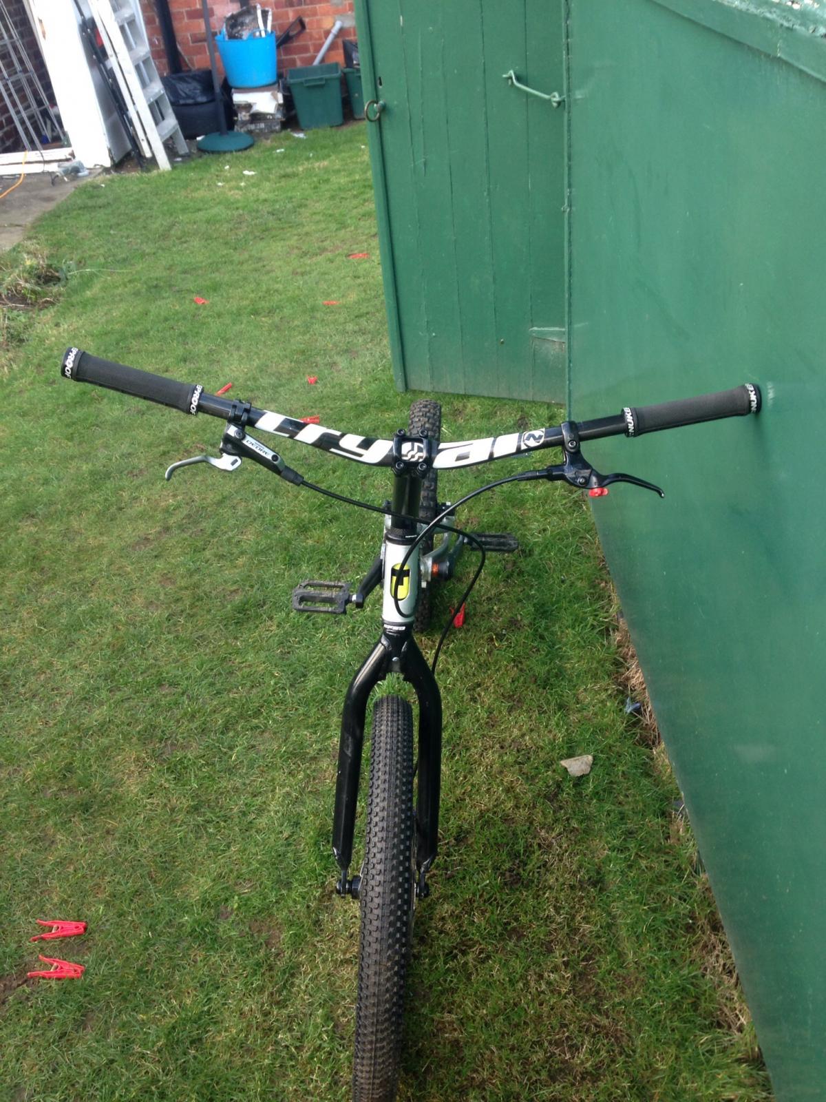

bing Posted January 9, 2014 Author Report Share Posted January 9, 2014 Few upgrades. Changed the front tyre to a 2.1 small block 8, rebled my rear brake, changed the bash to a rawed onza zoot bash because I like the look of it, fitted new white rim tapes, new nukeproof lock on grips, and got some new bars in the form of try all carbons. Just needs a sprinkling of ti bolts now Quote Link to comment Share on other sites More sharing options...

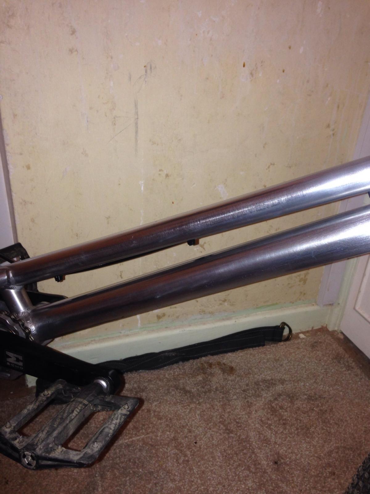

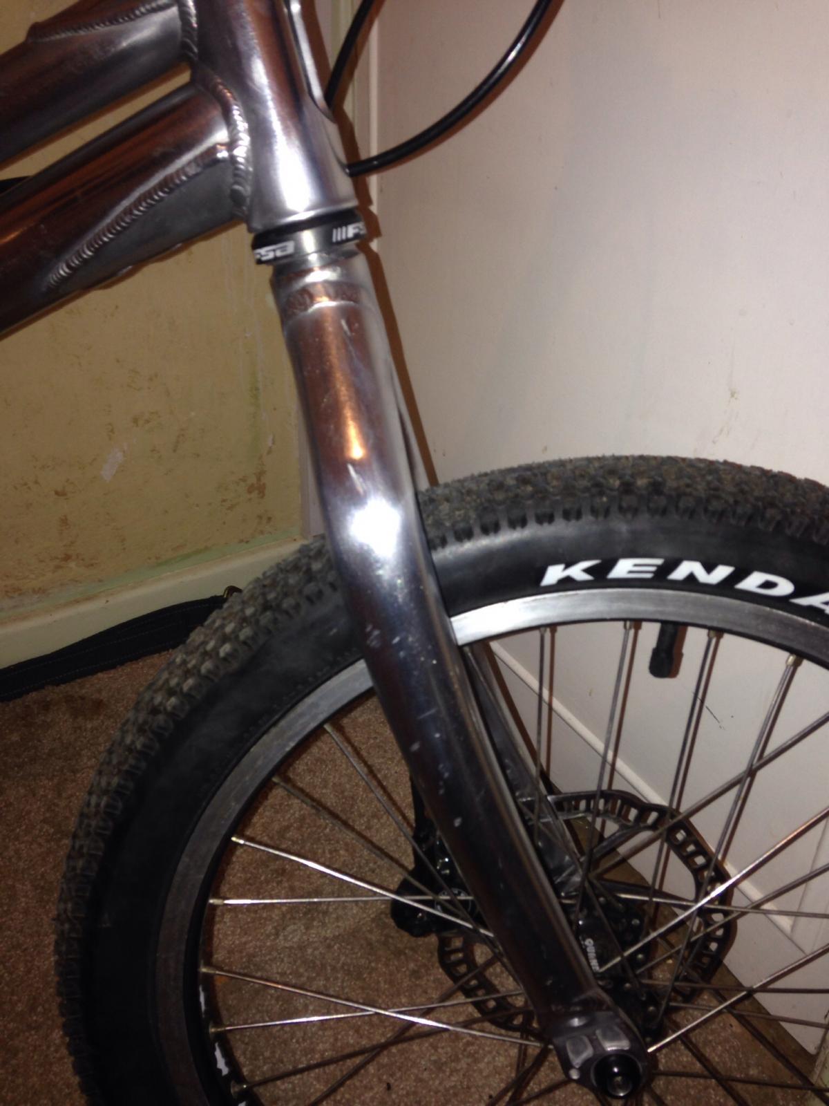

bing Posted January 23, 2014 Author Report Share Posted January 23, 2014 Did a spot of polishing today. I rawed my forks and stem last week, but then ogre put the idea in my head about autosol. I got some, I was only gonna do my forks and stem but ended up doing the whole bike. Came out ok I think 2 Quote Link to comment Share on other sites More sharing options...
