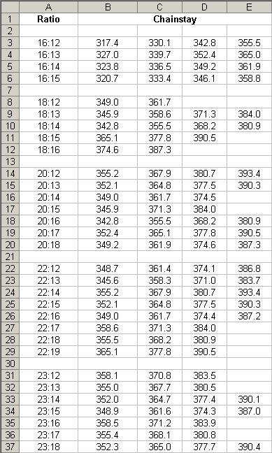

Skorp Posted October 28, 2013 Report Share Posted October 28, 2013 Hey I will maybe buy a bike, my RubberQueen tyre fits exactly if the chainstay is 380mm or more. the chainstay lenght is supposed to be 380mm, but it can be adjusted to around 390mm. Do anybody know how long the chainstay needs to be with a worn/new chain with a 18-15 gear ratio? Cheers, Quote Link to comment Share on other sites More sharing options...
FamilyBiker Posted October 28, 2013 Report Share Posted October 28, 2013 (edited) http://www.tartybikes.co.uk/images/custom/sprockets/chainstay.xls Edited October 28, 2013 by FamilyBiker Quote Link to comment Share on other sites More sharing options...
Skorp Posted October 28, 2013 Author Report Share Posted October 28, 2013 Thanks! Do you know if this is a new chain? Quote Link to comment Share on other sites More sharing options...
FamilyBiker Posted October 28, 2013 Report Share Posted October 28, 2013 as far as i know,yes. Quote Link to comment Share on other sites More sharing options...
