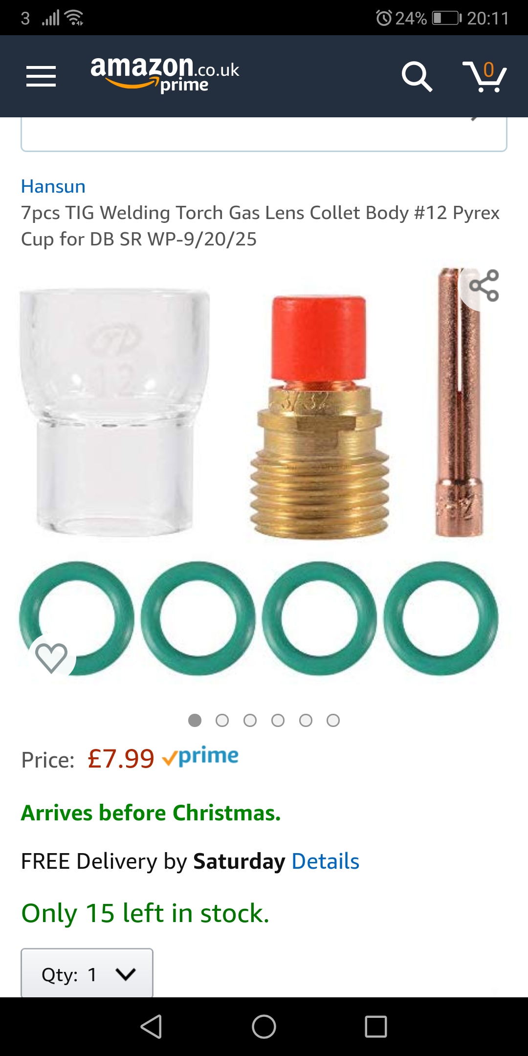

forteh Posted November 3, 2019 Author Report Share Posted November 3, 2019 (edited) A gas lense gives better laminar flow of the gas to give a more stable shield at lower flow rates. Can't quite tell if that's a mesh screen or a lense element. Google it edit: https://www.millerwelds.com/resources/article-library/gas-lens-basics-for-tig-gtaw-applications Edited November 3, 2019 by forteh Quote Link to comment Share on other sites More sharing options...
dann2707 Posted November 3, 2019 Report Share Posted November 3, 2019 Oh right yeah I'm using a gas lens kit with it mate 1 Quote Link to comment Share on other sites More sharing options...

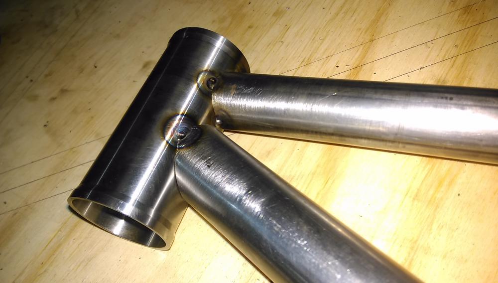

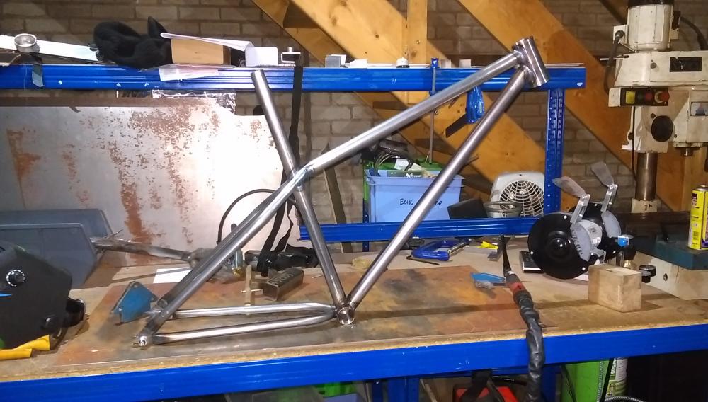

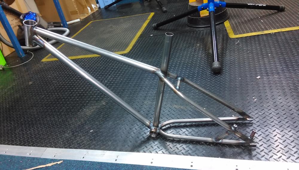

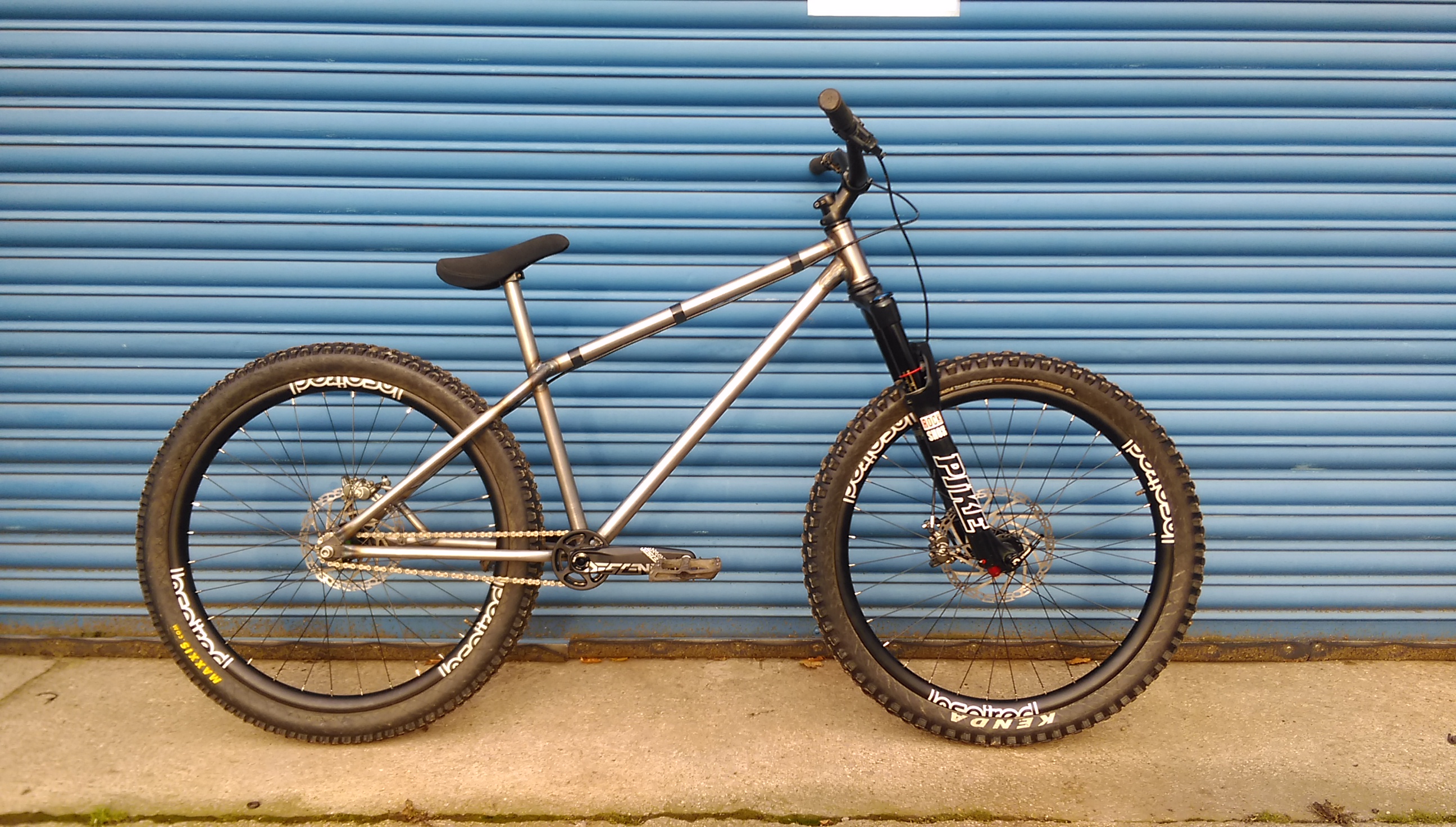

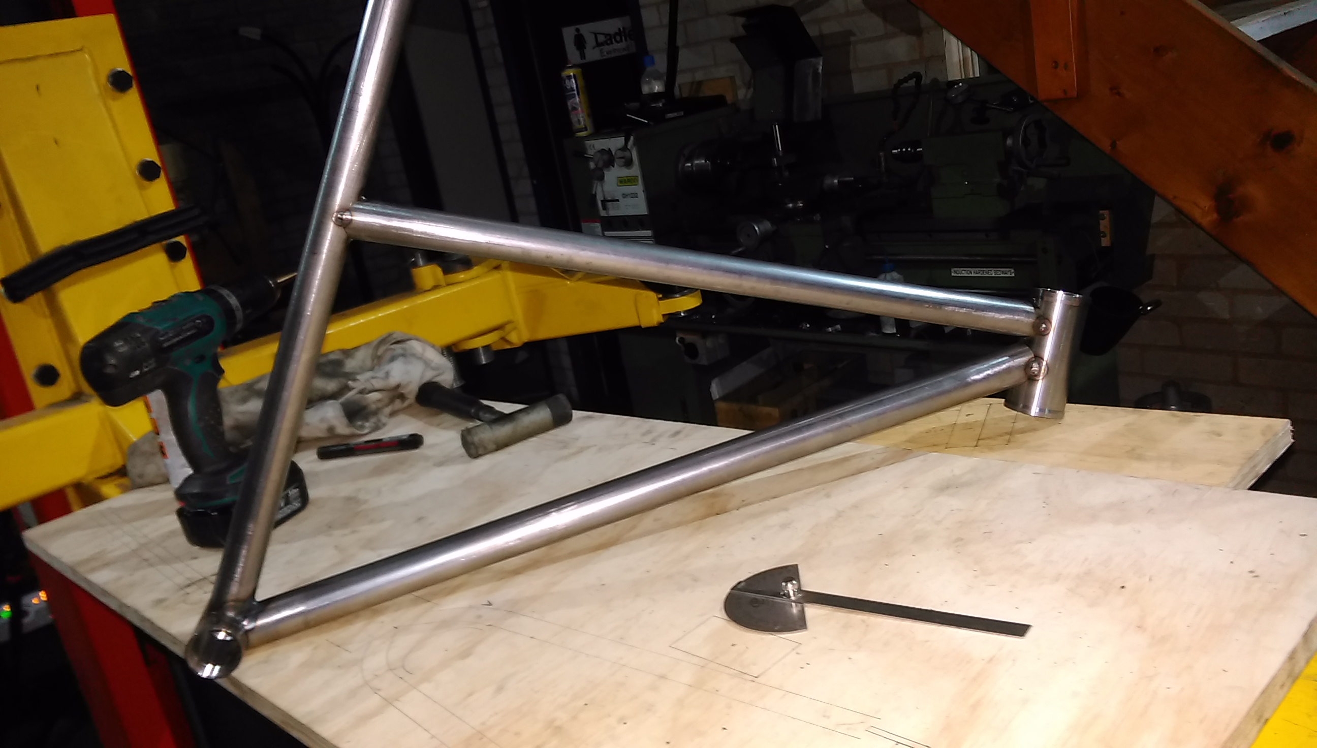

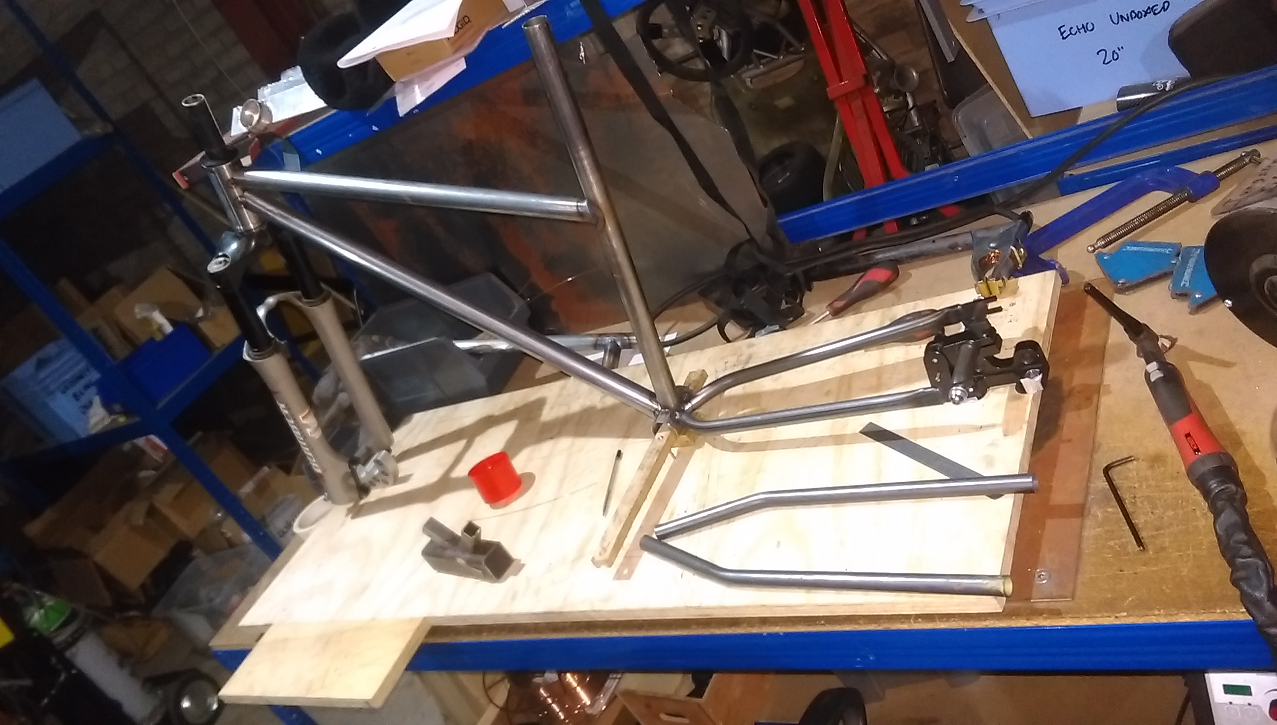

AdamR28 Posted December 17, 2019 Report Share Posted December 17, 2019 Decided my TIG needed some practice, so built myself a frame... Learned a lot, especially about cup sizes and how to cope with tight areas. Best with sound on so you can hear how lovely and quiet it is Loving singlespeed - it's so... freeing. It's just 'a bike', like being a kid again - "Mum, I'm going out on my bike!" - no shock settings to think about, gears to think about, saddle height to think about. Definitely recommend it 9 Quote Link to comment Share on other sites More sharing options...
Tony Harrison Posted December 17, 2019 Report Share Posted December 17, 2019 That's mint! Quote Link to comment Share on other sites More sharing options...
dann2707 Posted December 17, 2019 Report Share Posted December 17, 2019 Seriously cool stuff adz! Quote Link to comment Share on other sites More sharing options...
aener Posted December 17, 2019 Report Share Posted December 17, 2019 Kinda one-upped me there, didn't you! In every aspect. I don't "get" hardtails, but damn it looks nice enough to make me want it anyway! Quote Link to comment Share on other sites More sharing options...
AdamR28 Posted December 19, 2019 Report Share Posted December 19, 2019 Thanks guys! I don't reckon I 1-upped you Flipp, your custom frame was the inspiration to give it a go! 1 Quote Link to comment Share on other sites More sharing options...
dann2707 Posted December 19, 2019 Report Share Posted December 19, 2019 I only use these gas lense kits now. 900% cheaper than the fupa ones and give really awesome coverage of gas. Downside is I smashed two in one day as I was being clumsy. Really are worth it though, especially as you can have your stick out a ridiculous length for tight places. Helped with thr exhaust massively. 1 Quote Link to comment Share on other sites More sharing options...
AdamR28 Posted December 20, 2019 Report Share Posted December 20, 2019 Cheers Dan, that's handy info! I guess the glass helps with vision too? 1 Quote Link to comment Share on other sites More sharing options...

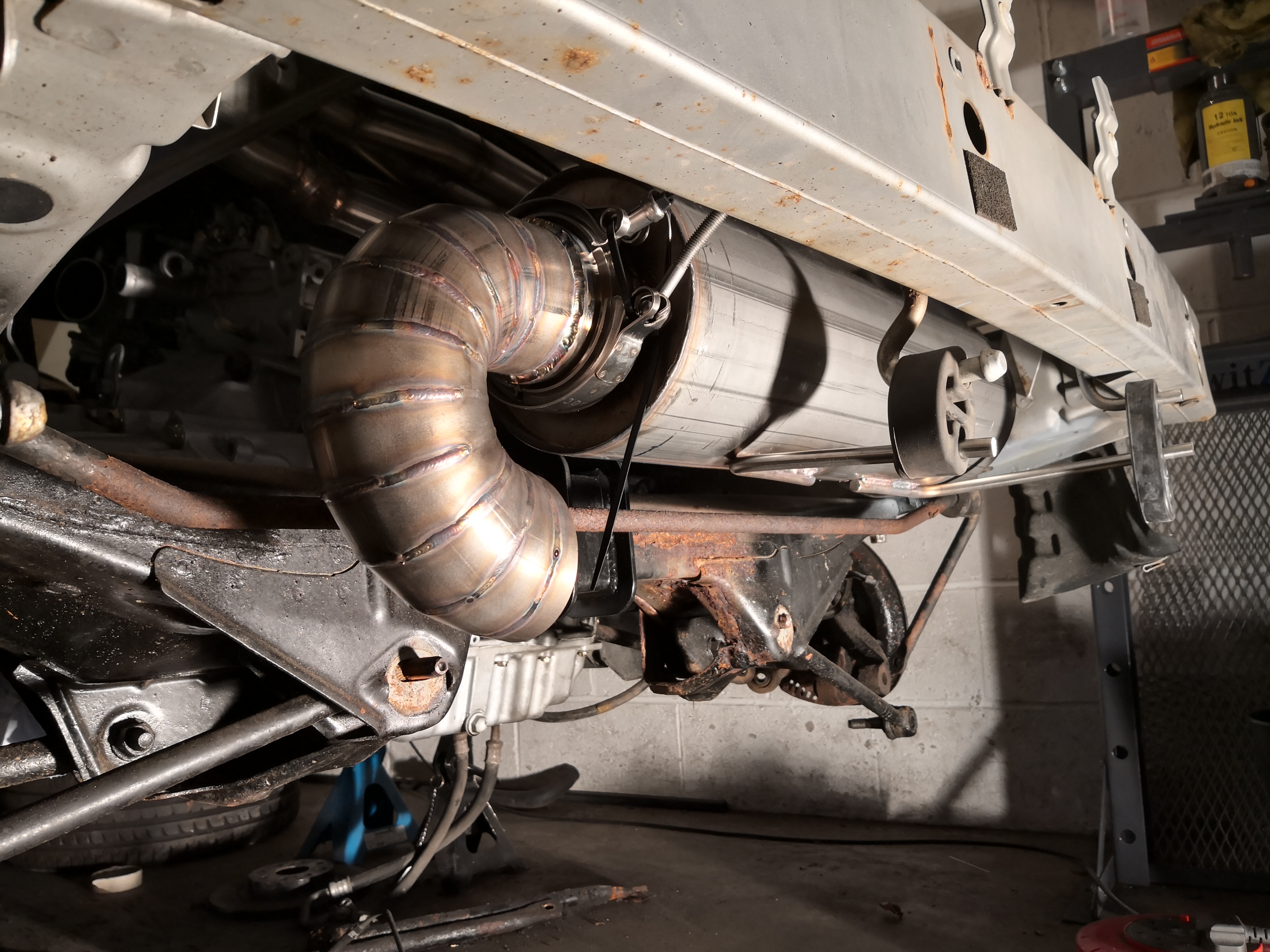

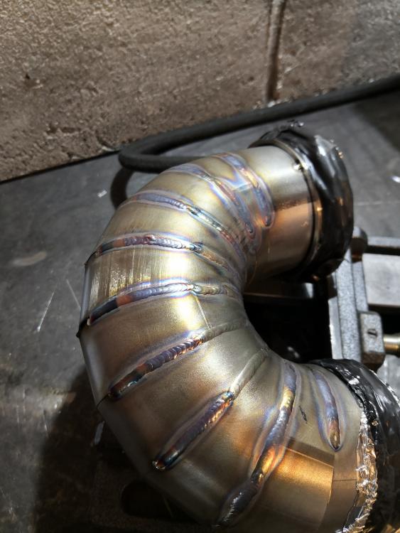

dann2707 Posted December 22, 2019 Report Share Posted December 22, 2019 Just finished my first lobster/pie welding. Went well Quote Link to comment Share on other sites More sharing options...

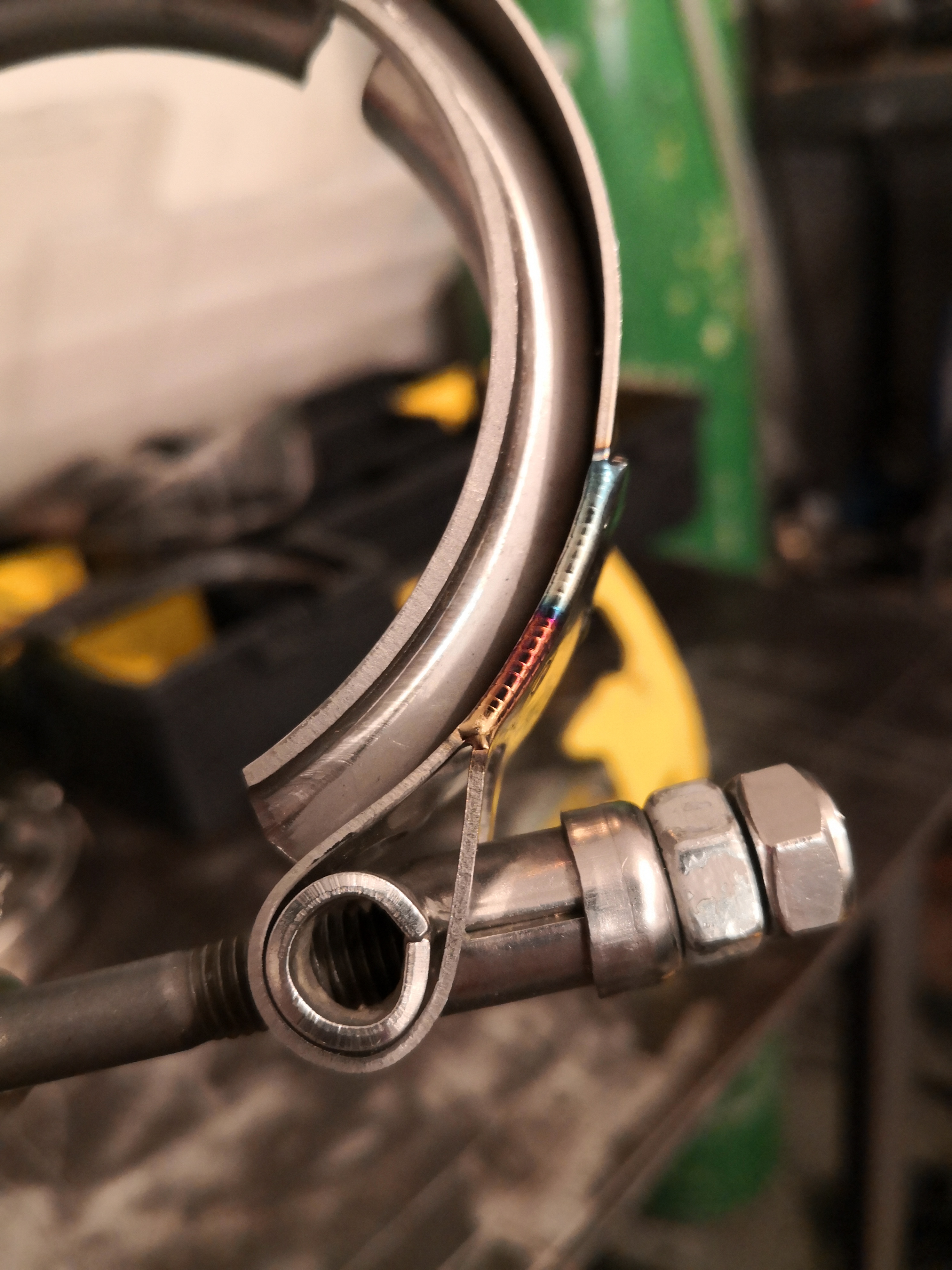

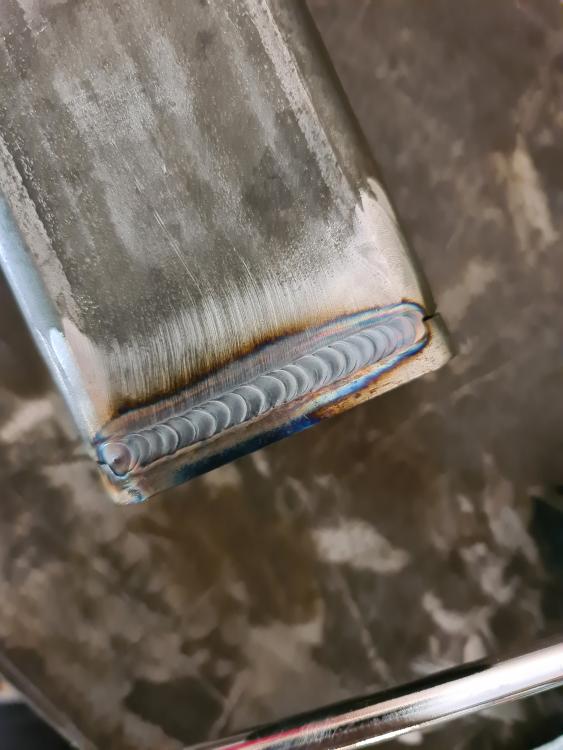

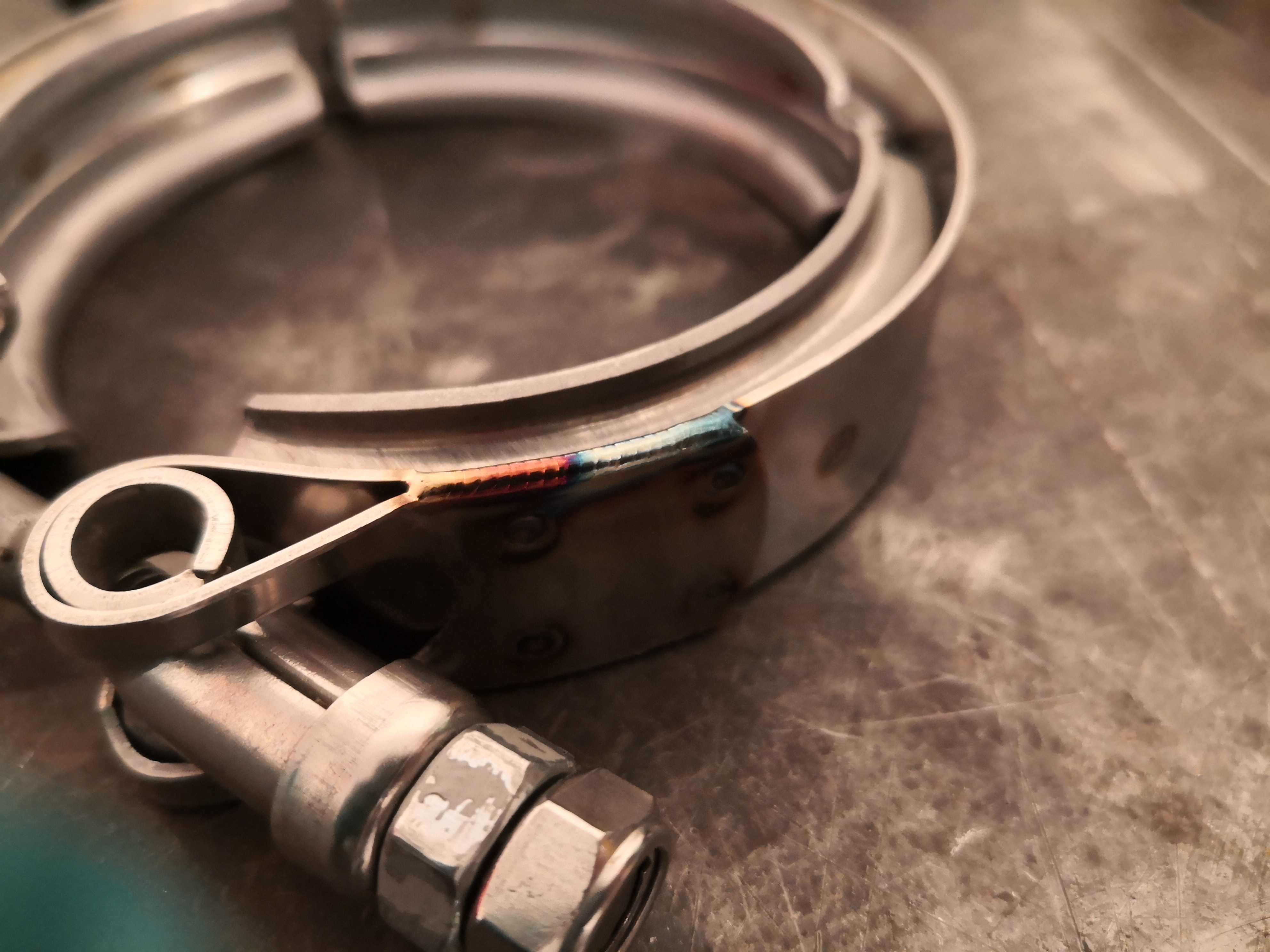

dann2707 Posted January 21, 2020 Report Share Posted January 21, 2020 More from me from tonight. Strengthening some v band clamps because f**k a few spot welds 4 Quote Link to comment Share on other sites More sharing options...
forteh Posted January 21, 2020 Author Report Share Posted January 21, 2020 I'll laugh if you've just welded a crack in there Quote Link to comment Share on other sites More sharing options...

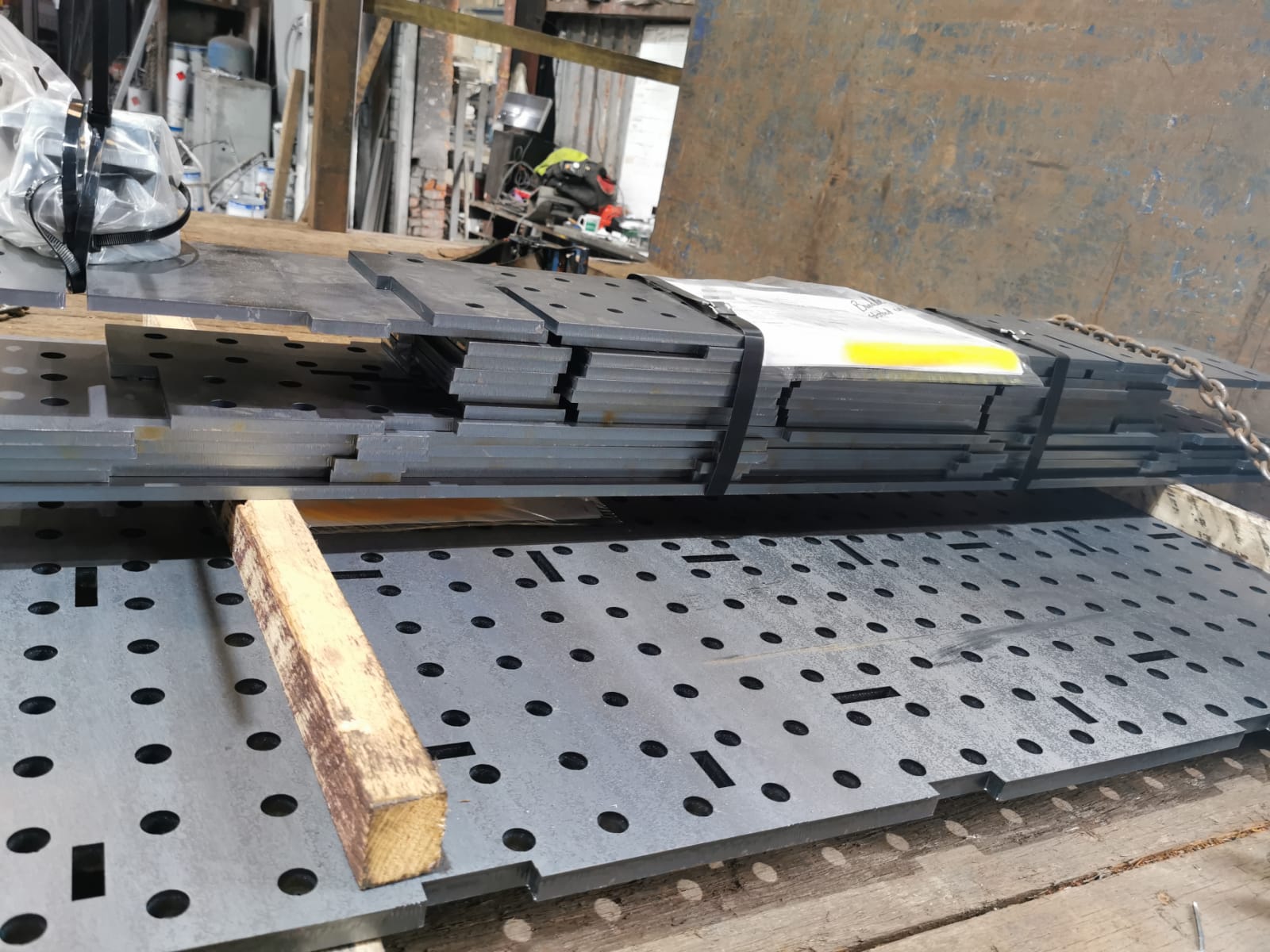

dann2707 Posted August 7, 2020 Report Share Posted August 7, 2020 Taking the welding a little further and after speaking to an acquaintance of mine, he's designed and ordered me a fab table. Pretty decent size for what I need too. Weighing in at 450kg too haha Can't wait to do some more fab work now! 1 Quote Link to comment Share on other sites More sharing options...

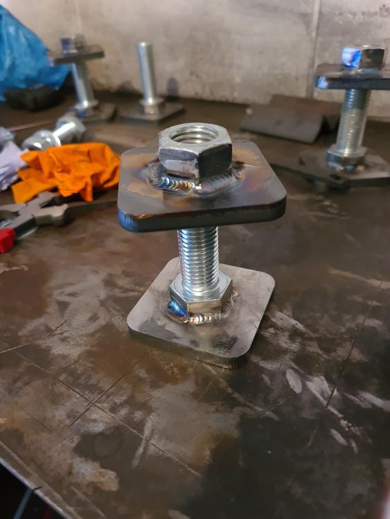

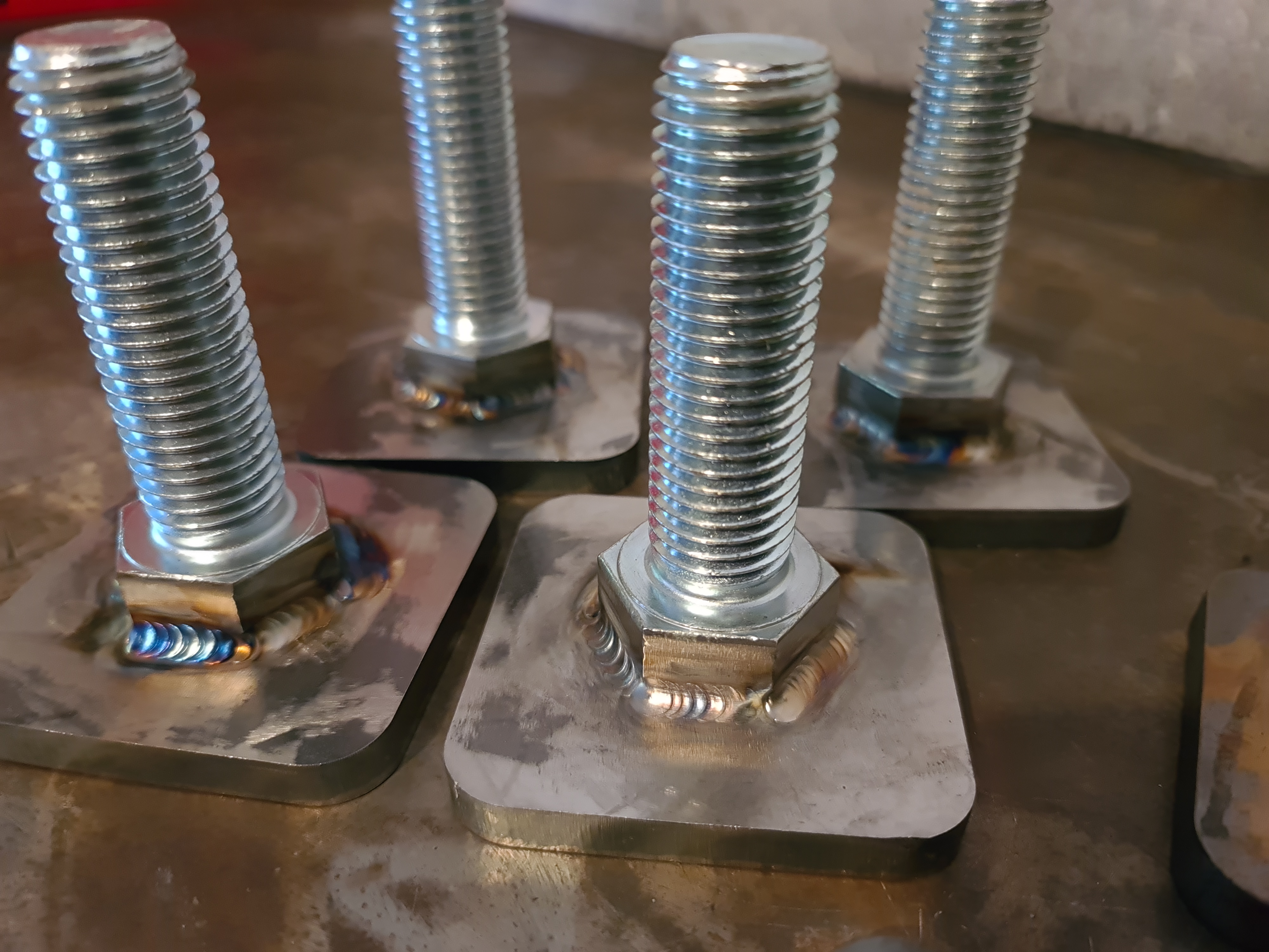

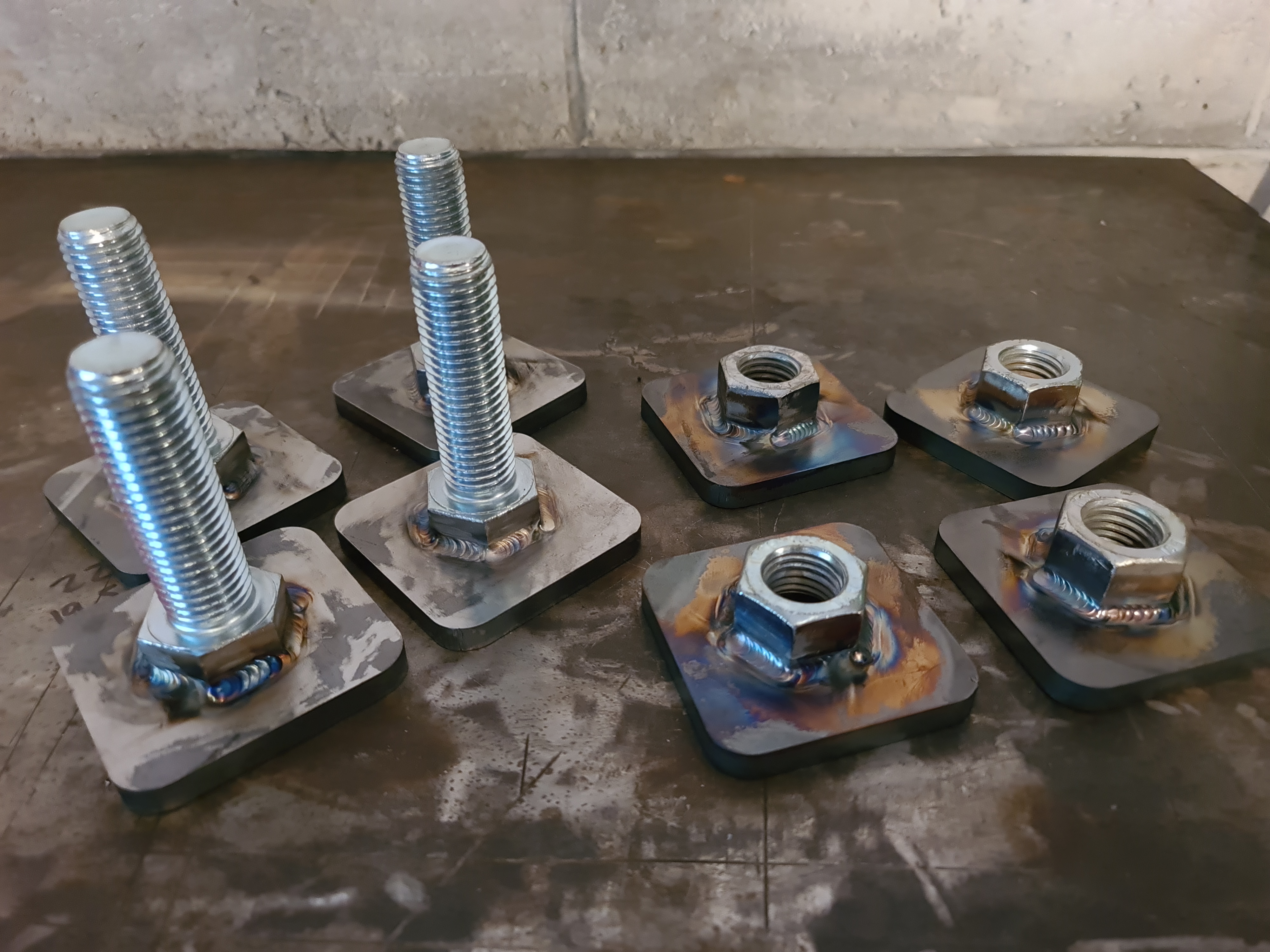

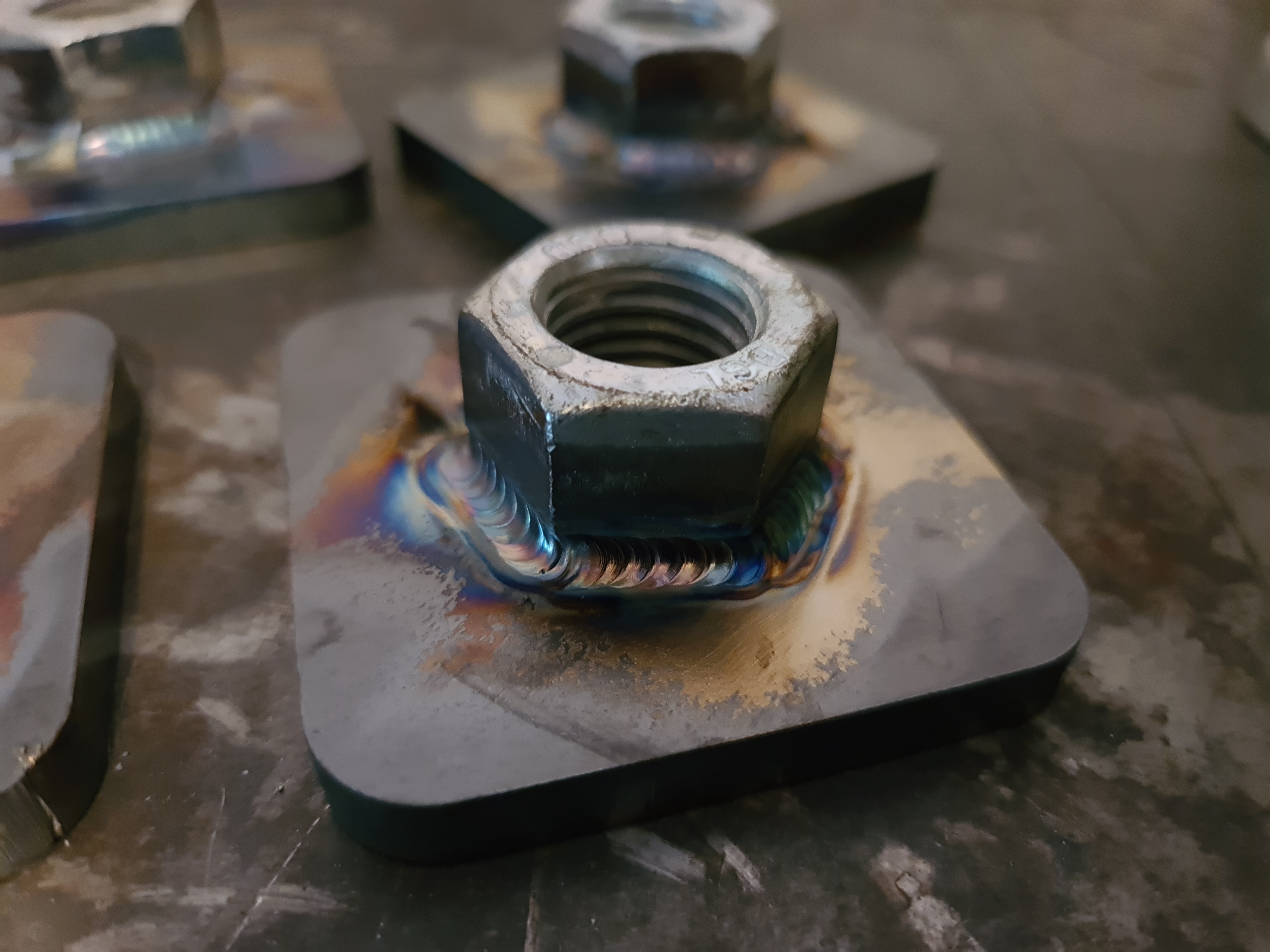

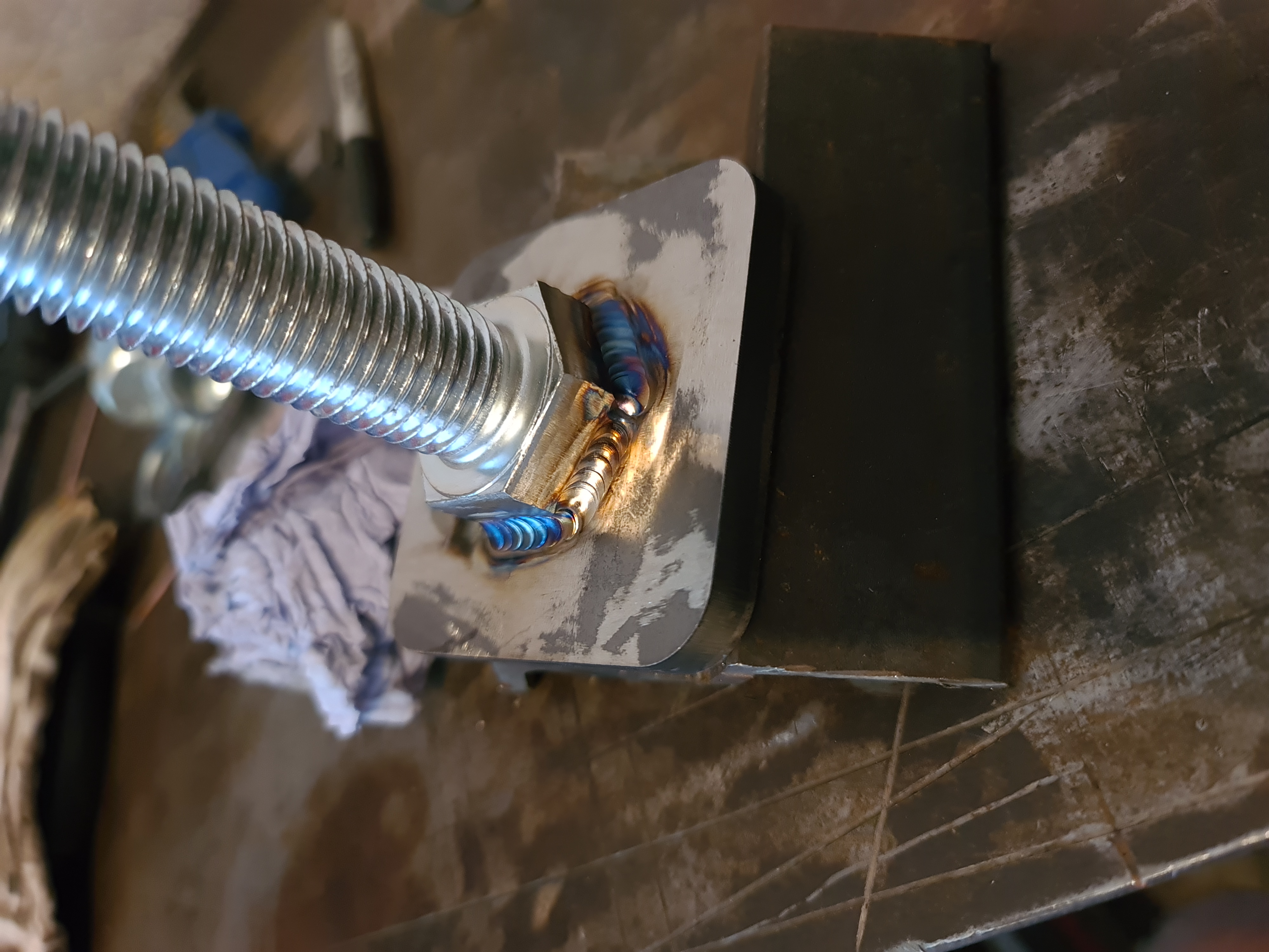

dann2707 Posted August 11, 2020 Report Share Posted August 11, 2020 Started building bits of the table up today. Today was the adjustable feet Everyone loves close ups properly love welding it's hard to put into words haha 1 Quote Link to comment Share on other sites More sharing options...
craigjames Posted August 12, 2020 Report Share Posted August 12, 2020 Looking good,Improving all the time! I'd love to have a TIG welder to give this all a go. Found it properly therapeutic when I did a course a few years back. How much did your plant set you back out of curiosity? 1 Quote Link to comment Share on other sites More sharing options...
dann2707 Posted August 12, 2020 Report Share Posted August 12, 2020 6 hours ago, craigjames said: Looking good,Improving all the time! I'd love to have a TIG welder to give this all a go. Found it properly therapeutic when I did a course a few years back. How much did your plant set you back out of curiosity? Thanks mate. That's why I like it too, it's so quiet in comparison! Been mig welding today and it's safe to say I am sick of it for the day. I could never do it as a job thts for sure. The first tig welder I got was £350, that just did steel but then I upgraded to an acdc unit which can do alu too, that was £1600 ish. It's nearly ready to flip over 2 Quote Link to comment Share on other sites More sharing options...

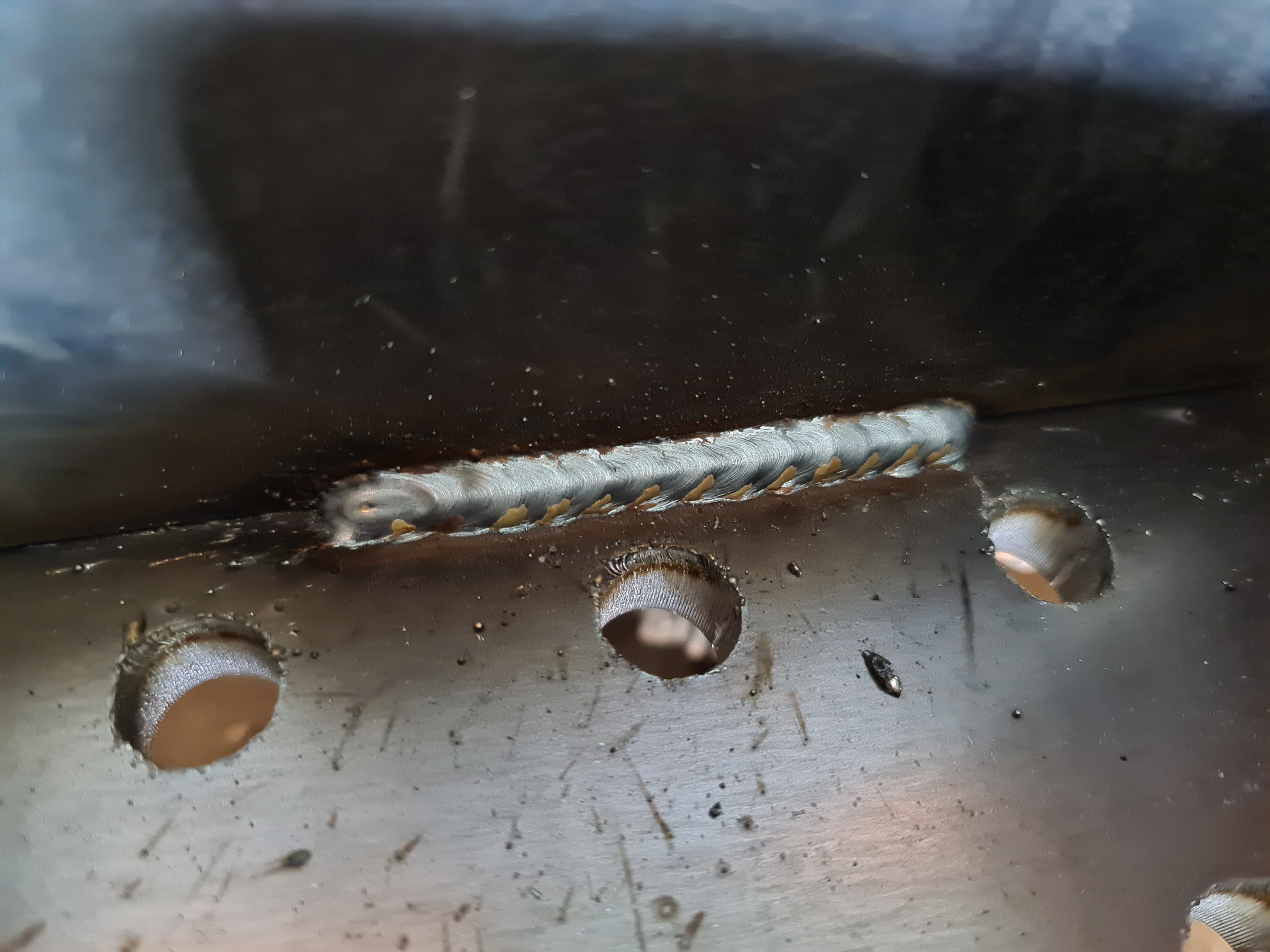

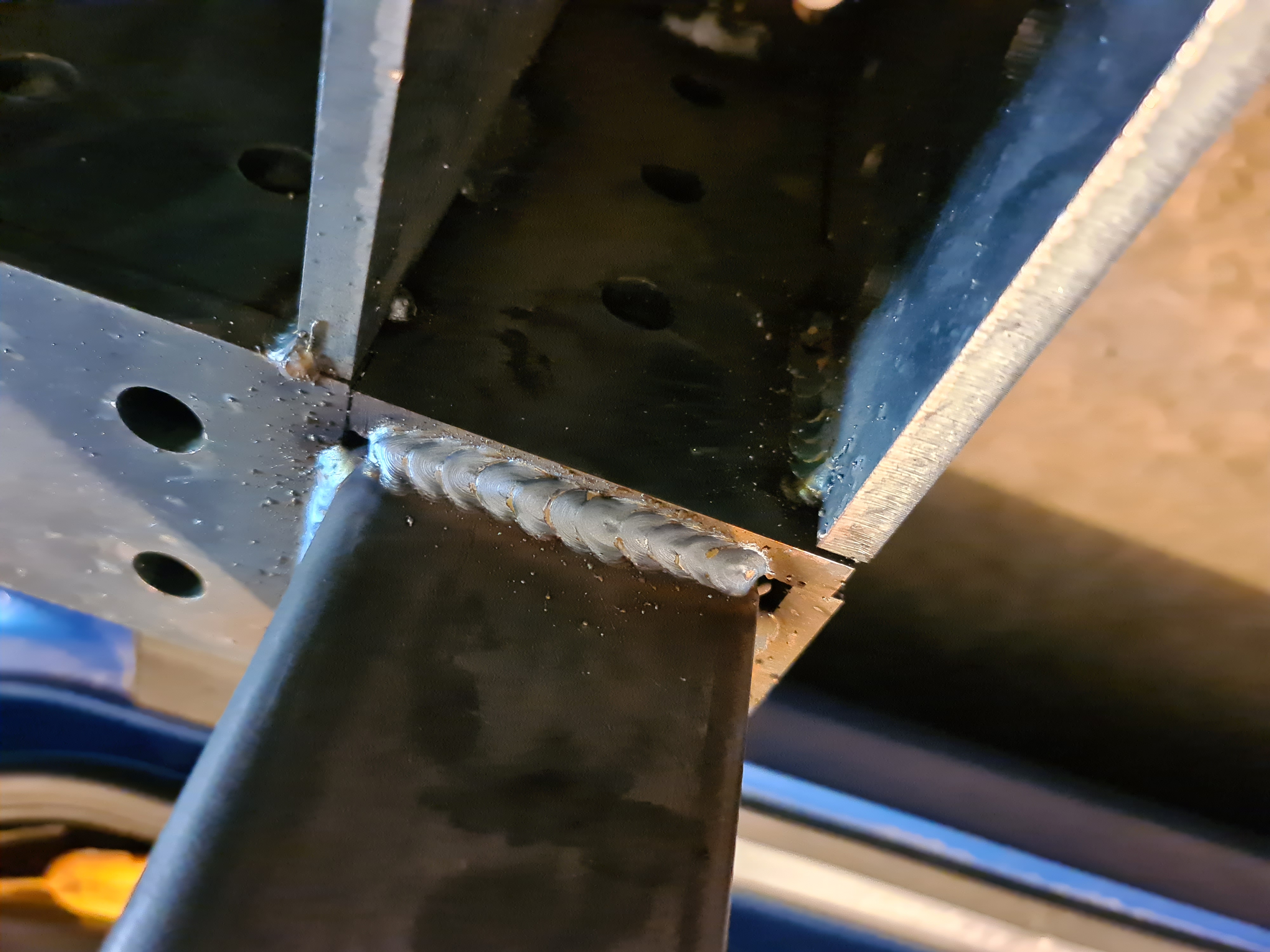

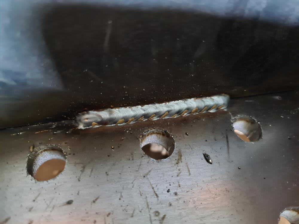

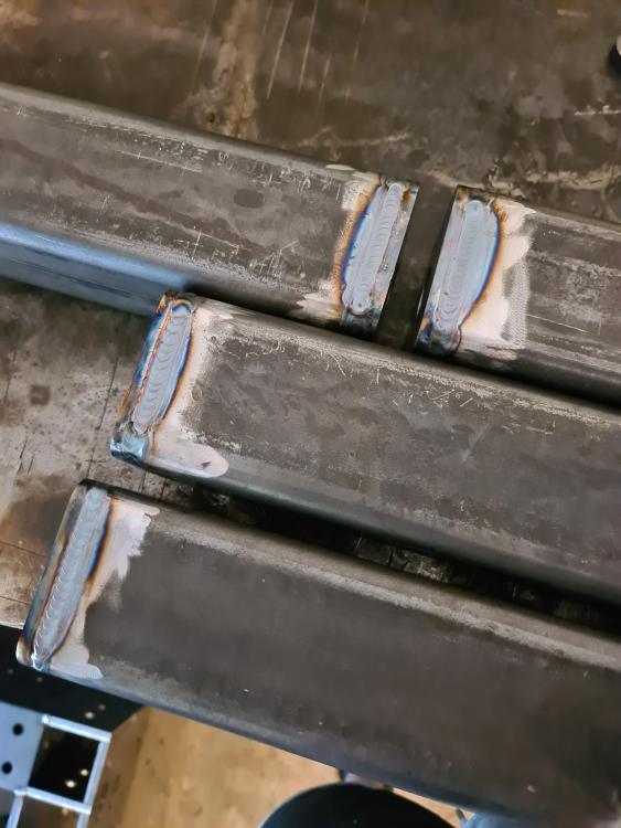

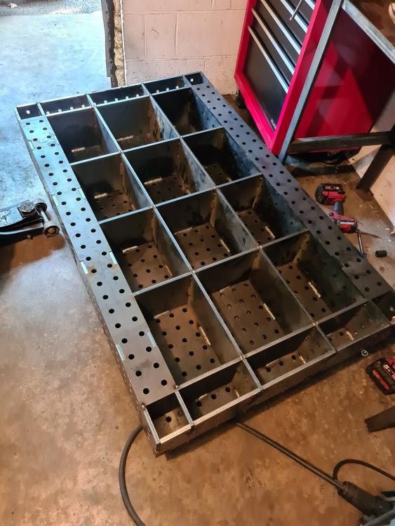

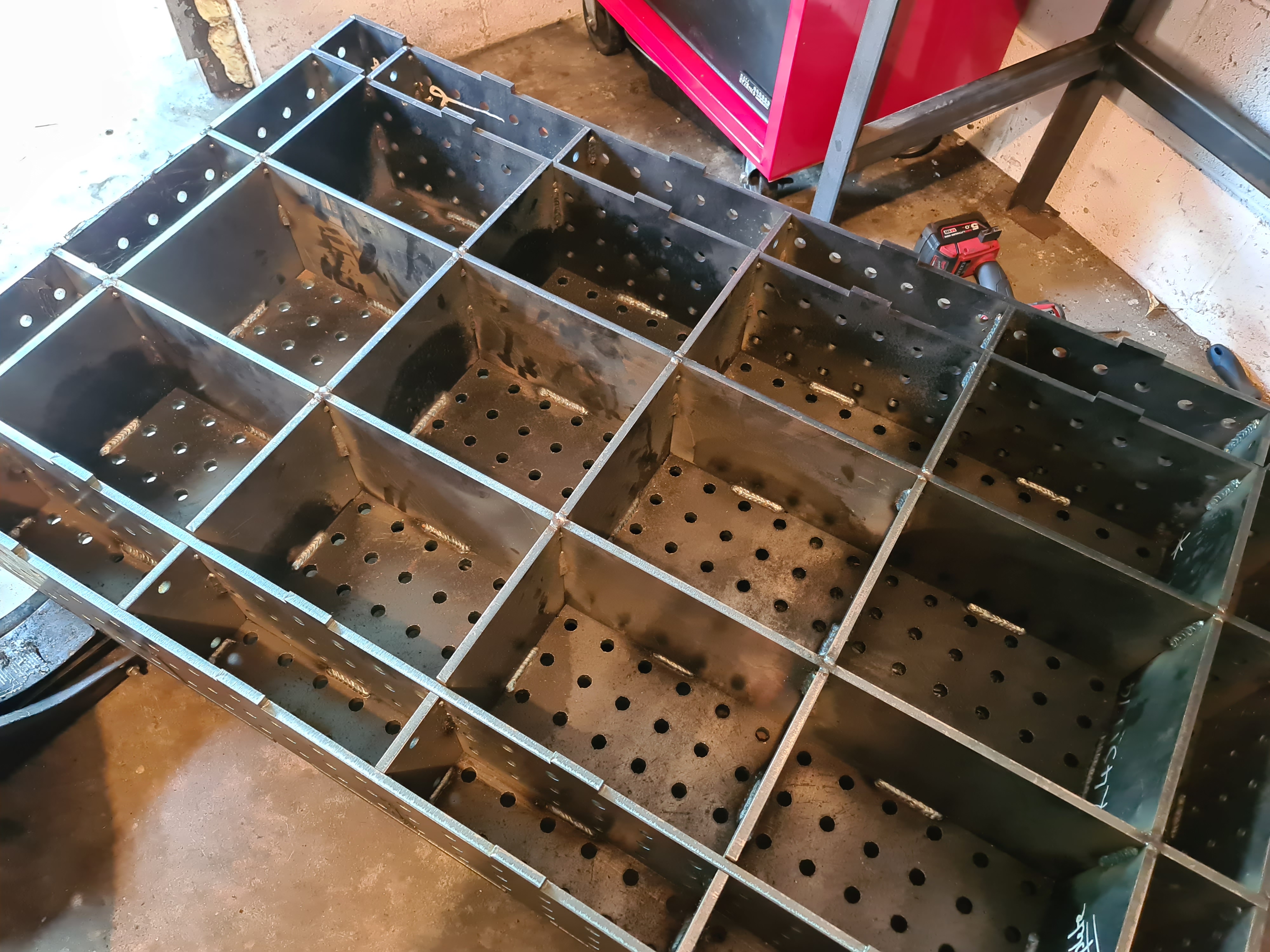

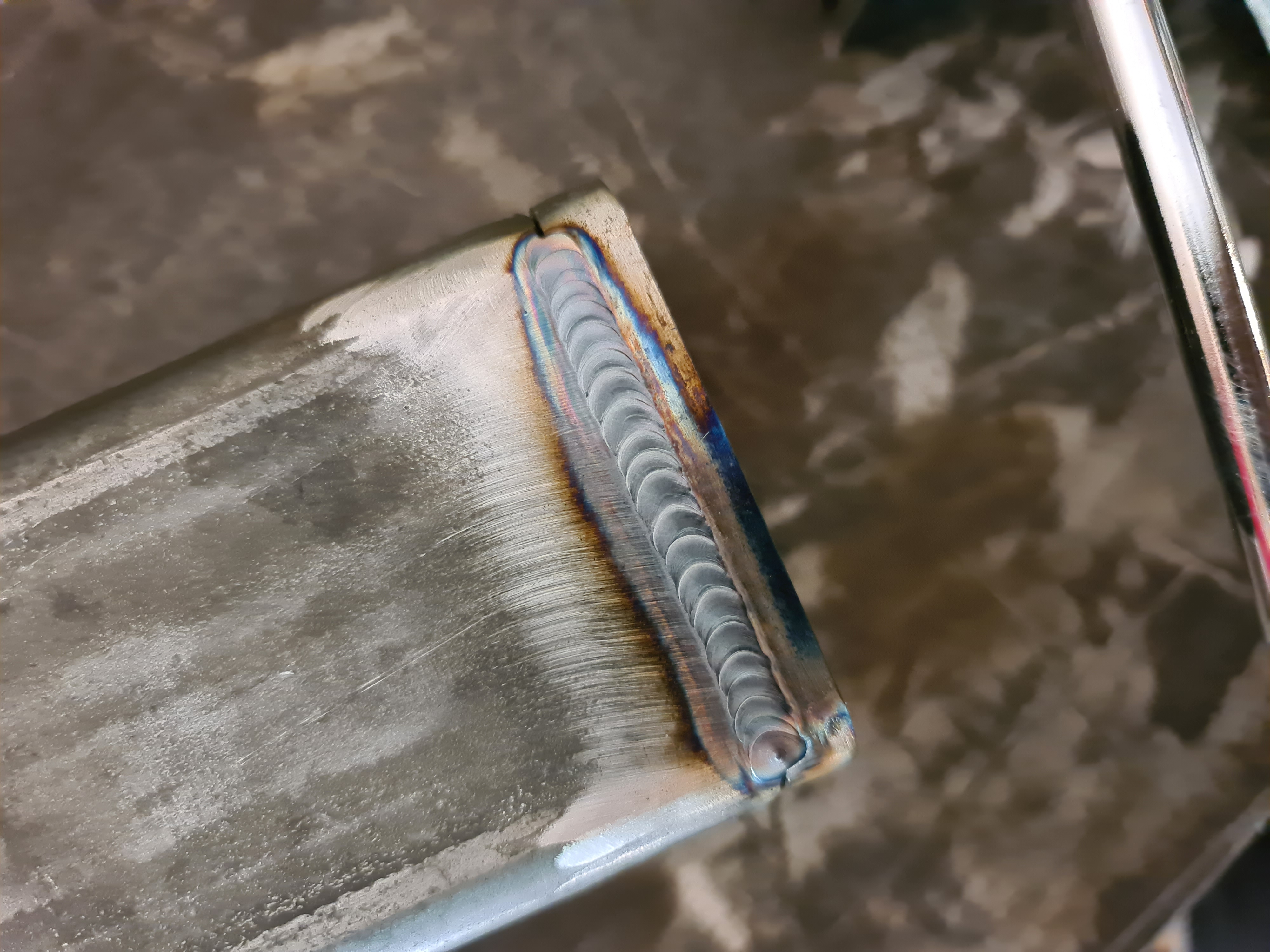

dann2707 Posted August 13, 2020 Report Share Posted August 13, 2020 Today I've tig welded the captive nutted end caps to the legs and then nearrrrrly finished it until my mig wire ran out haha (half way through a section lol) It's a f**king beast! 1 Quote Link to comment Share on other sites More sharing options...

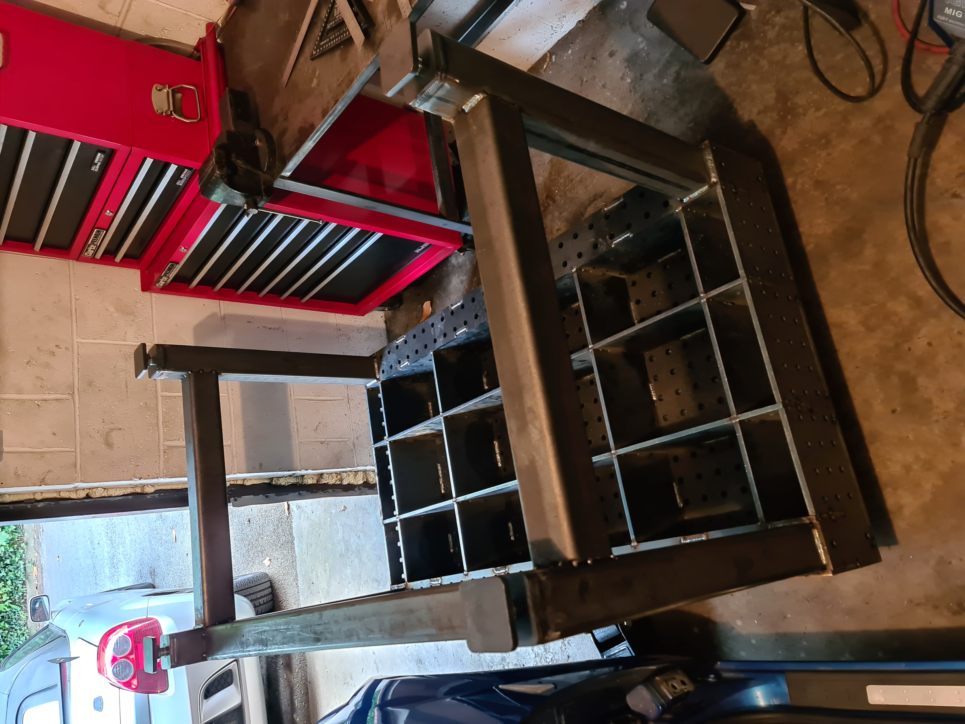

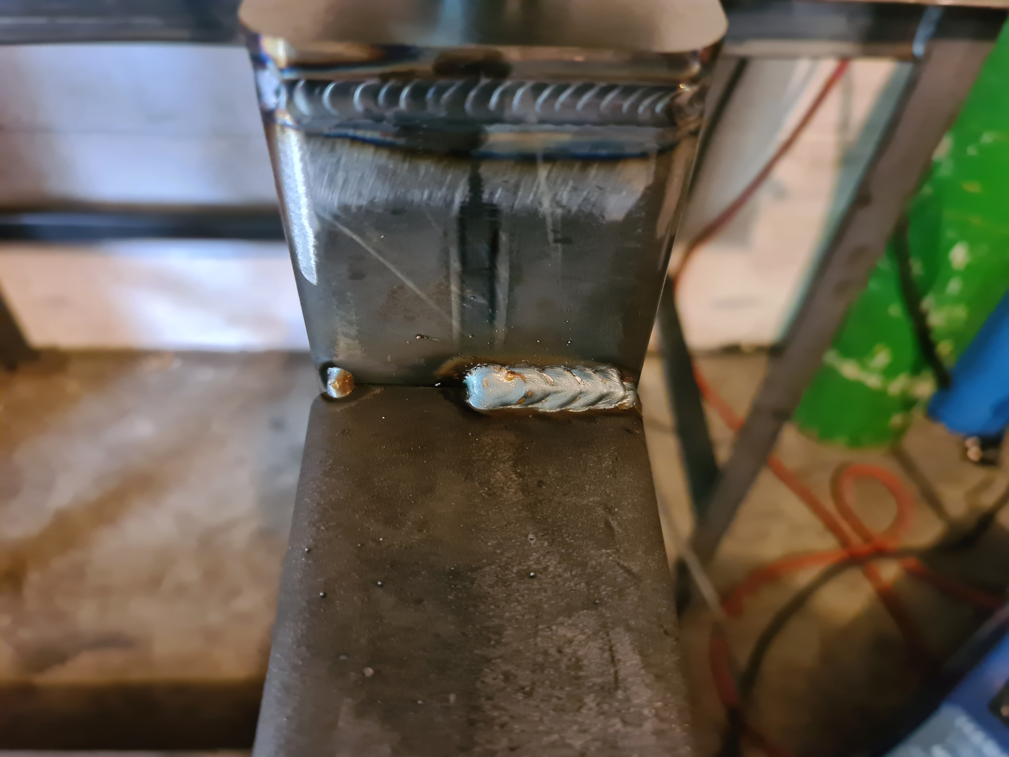

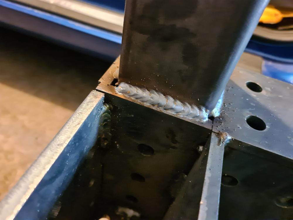

dann2707 Posted August 17, 2020 Report Share Posted August 17, 2020 Beast is in f**king in love. Struggled massively with 4 of us to flip it as its actually a smidge over 500kg Quote Link to comment Share on other sites More sharing options...
Eldertroll Posted August 17, 2020 Report Share Posted August 17, 2020 Not a bad effort that. Not much throat on any of those welds though Quote Link to comment Share on other sites More sharing options...
dann2707 Posted August 17, 2020 Report Share Posted August 17, 2020 23 minutes ago, Eldertroll said: Not a bad effort that. Not much throat on any of those welds though Just had it resting on both legs as it was being flipped over and it didn't move at all. For a hobbyist it'll be absolutely fine... Quote Link to comment Share on other sites More sharing options...
Eldertroll Posted August 17, 2020 Report Share Posted August 17, 2020 If it’s stayed all square you’ll be fine then 1 Quote Link to comment Share on other sites More sharing options...
